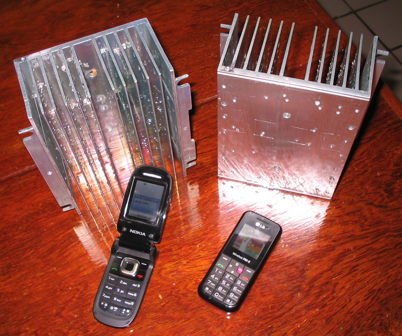

Those heatsinks are Lightweights considering their surface area.
The fins have a thin aspect ration.
The backplate has a thin aspect ratio.
600W maximum power capable output devices will run hot, maybe too hot.
From their shape (see the mounting places at the end of the most external fins) they might have beeen intended for forced ventilation (FAN) cooling.
Before somebody shoot them with a shotgun, of course.
generally blown sinks have very closely spaced fins. The power of the fan motor makes the forced air turbulent and much better at removing heat from the aluminium.
A Natural Draught sink has wider spacing to allow the hot air chimney effect to work reasonably with minimal friction losses, since there is almost no "power" to drive the air up and therefore no turbulence.
Yeah...it may be too hot...then i will cool it down.
I have not a bigger one..this ones, these heatsinks, are for my prototype testing only.... sadly i have not a bigger heatsink....i would need 4 times this size to keep this thing working cold the way i like...not going above 45 degrees celsius.
I gonna try a couple of fan blowing air and will make my tests at 500 watts RMS for a short time to evaluate the bias reduction (thermal sensor, diodes in series attached to the heatsink)... and will make further testings using music..then i will have average power and these heatsinks will manage the heat.
My town temperature have dropped a lot... now 25 degrees celsius..this will help too.
For future builders, as this amplifier is still in the prototype testing stages, i will suggest a much bigger heatsink.

Yep..heatsink no good... there are several errors..but he will fast realise where are these errors.
regards,
Carlos
Hi Destroyer.
I do not concern myself with testing heatsinks to destruction.
I want to test my electronics do not self destruct.
A small heatsink on a large amplifier is not a problem in test situation.
I usually set up the test arrangement such that a -20dB ref maximum power is passed through. flick switch to -0dB position and check the scope for no clipping and immediately flick back to -20dB position. The heatsink hardly changes temperature that this 1second test takes. you can repeatedly fine adjust the input signal level to find the highest unclipped voltage at the output. a dozen 1 second tests over a 1minute period causes no heating problems.
Now add on your rms scaled voltage meter.
flick switch to -0dB. Allow just enough time for the voltmeter indication to "settle". This can take from 1 to 2 seconds. flick back to -20dB.
The electronics have been tested for this particular combination of output voltage and load. The whole amplifier has hardly changed temp from it's quiescent condition.

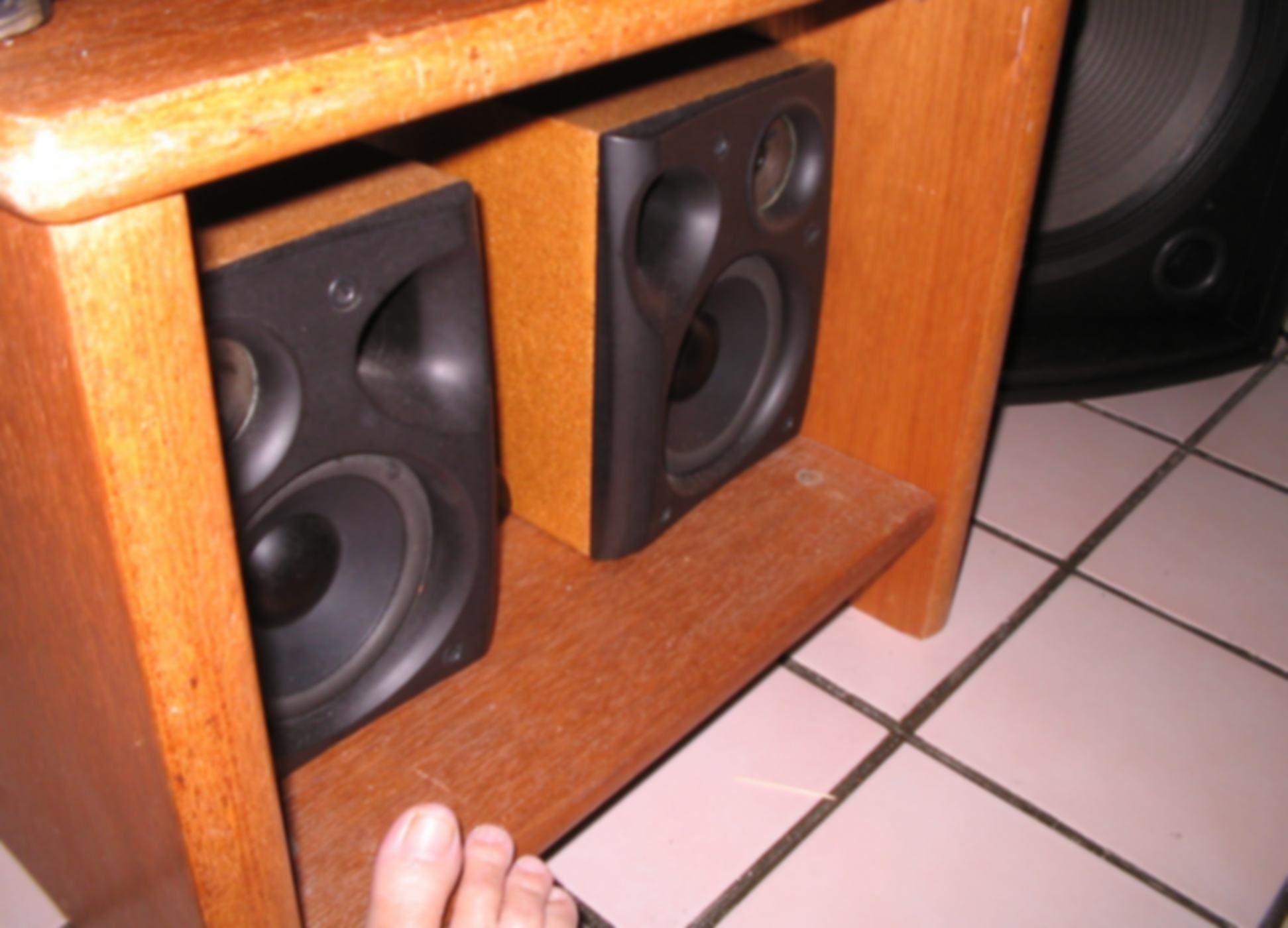

I have made modifications in my own amplifier, the one i use
together my computer.... i have reduced power introducing a small external step down voltage regulator using transistor and zener, a series pass circuit, the same used in the HRII several years ago.
The idea is to match my amplifier with mine beloved Philips speakers (picture attached) removed from a junk system made in Nederland... speakers are low power, so i am reducing power not only to match the speakers but also because i have removed the main heatsinks previously used in mine Blame, to use it into another amplifier...mine own amplifier is having small heatsinks now a days... it cannot dissipate too much power.
I have called this one Dx Blame ST - Home edition.... because it is really my home edition, and i am trying the colector resistance in the first VAS...i want to listen to it and confirm in the long run things i have already perceived about it.... i do think it will be removed near future.
