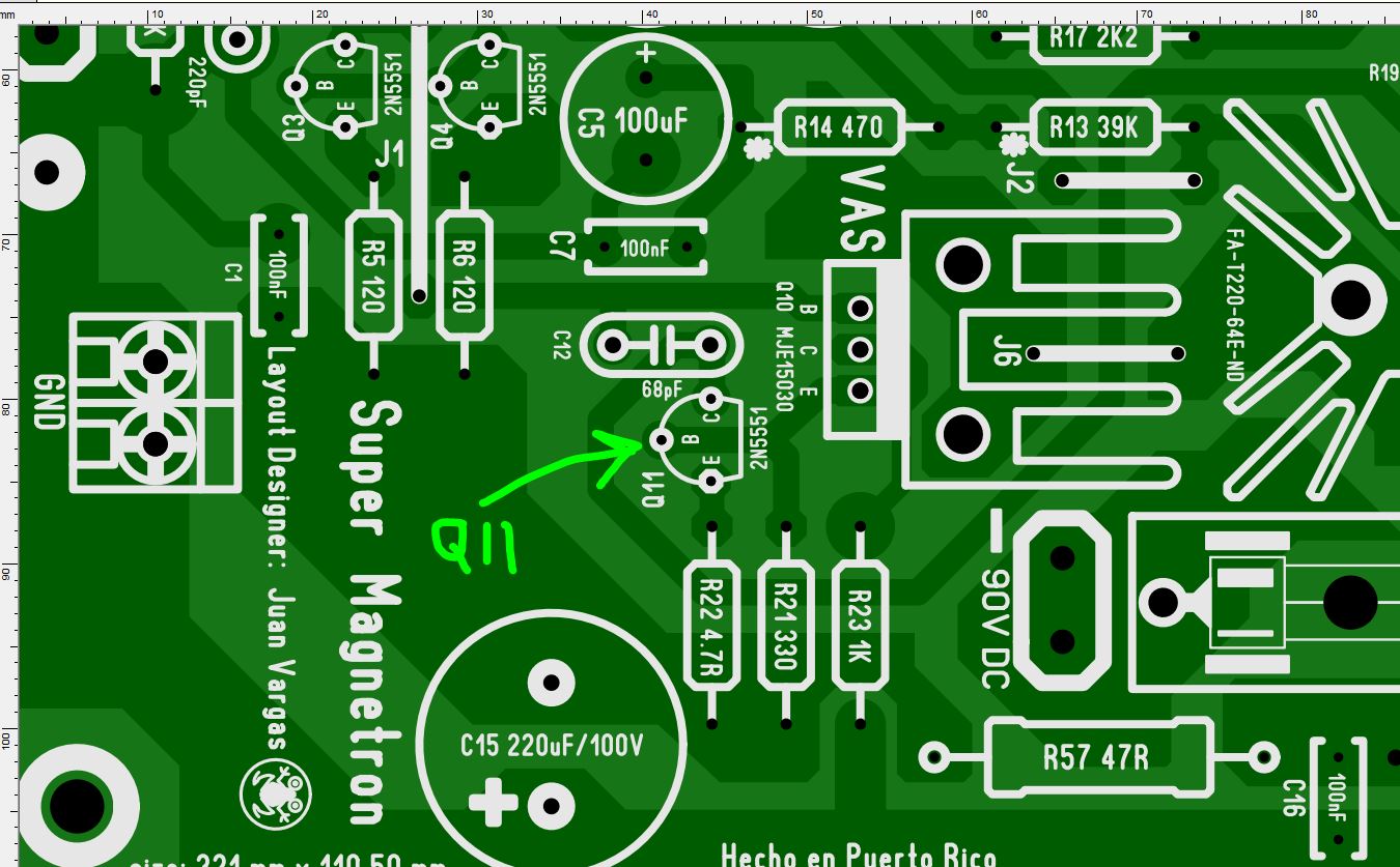

I didn't understand Carlos to care that you change layout. It is the circuit that he wants preserved. I think it was Christian's suggestion of adding pre-buffers that concerned him.
It is hard to tell from the JPEG you attached above but it looks like your grounding scheme is slightly changed. If you remember earlier that we had to make some modifications to Alex's boards to get the lifted input ground to match the schematic. Maybe it would be good to do as Carlos suggested and go through the PCB with markers and double check that everything follows the schematic exactly.

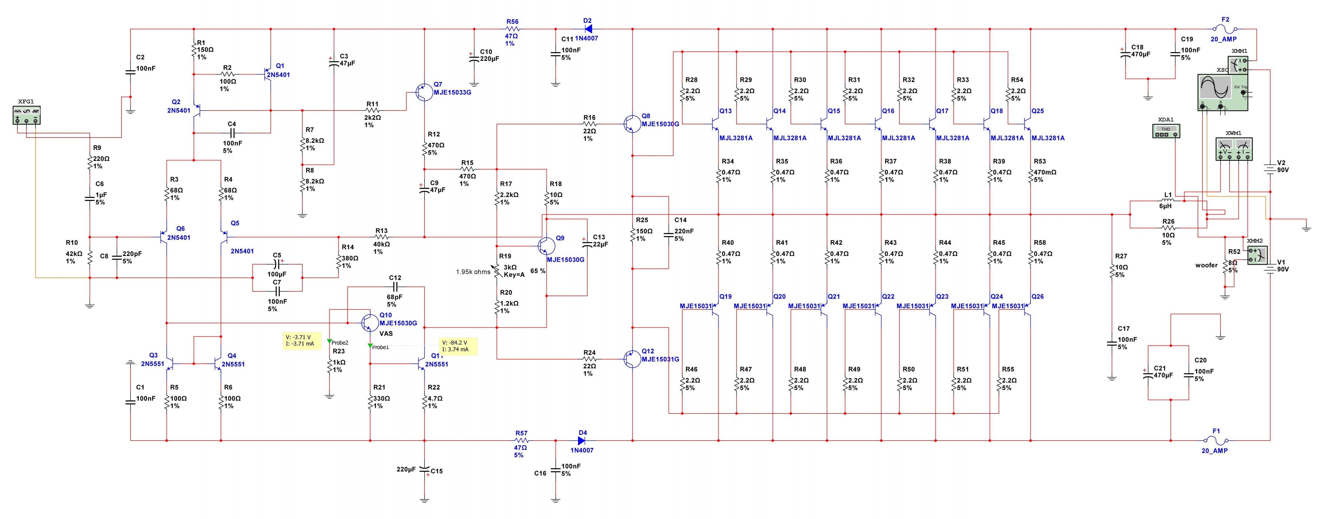

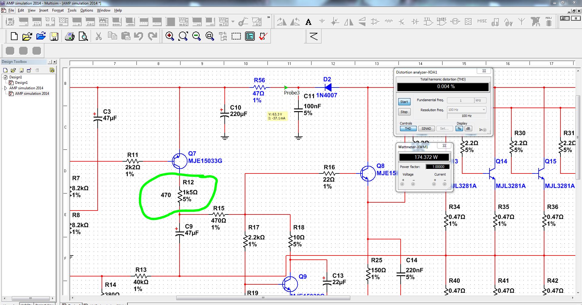

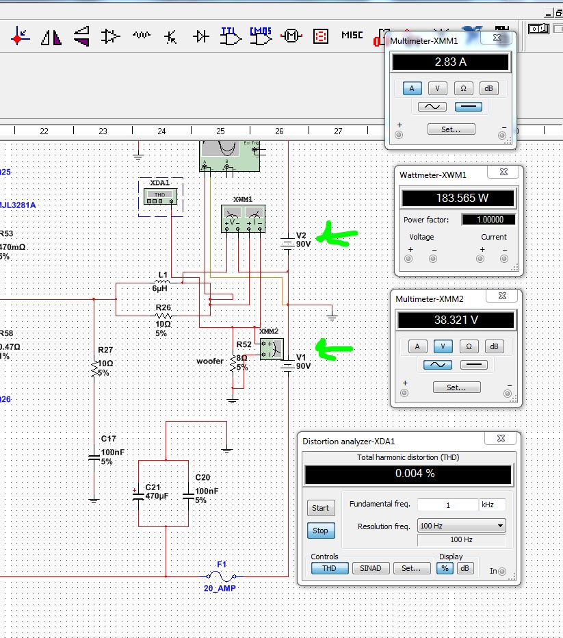

Hey guys, Carlos, I have a question, I have been simulating MKIII for a few days maybe a week from time to time and I notice when I increase the power supply voltage to 90V the THD goes down a lot 0.004% but, when I use the suggested power supply voltage 64V the THD goes up ? is there are relation between supply voltage and THD ? I also add more pairs exactly 7 pairs I don't know or better say comprehend this not that well, maybe you guys "any one I appreciated" can explain me why that happen, is really interesting got me thinking for a while now. 😕
Regards
Juan

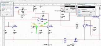

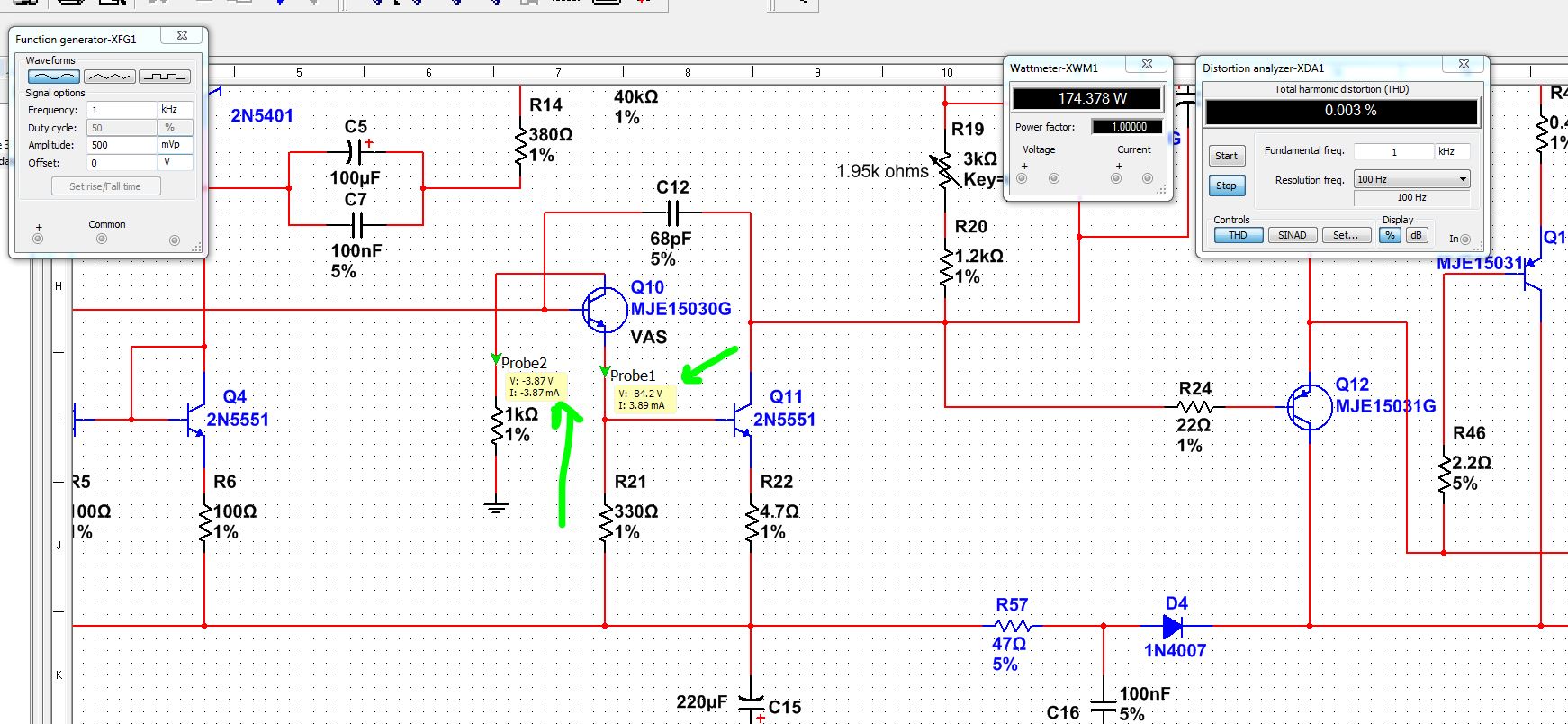

Well with the virtual prove from NI Multisim 13
I got from Q10 emitter -59.4V @ 3.54 mA from a 64V supply voltage,
with 90V supply I got from Q10 emitter -84.2V @ 3.89 mA
so that means that VAS Q10 is sending more current to drive Q9 a bit more BIAS ?
Juan

We always knew the vas would benefit from more voltage than what was being used, this was discussed in the early days of the MK3, at the time i wanted split rails to run the outputs at 45v ...

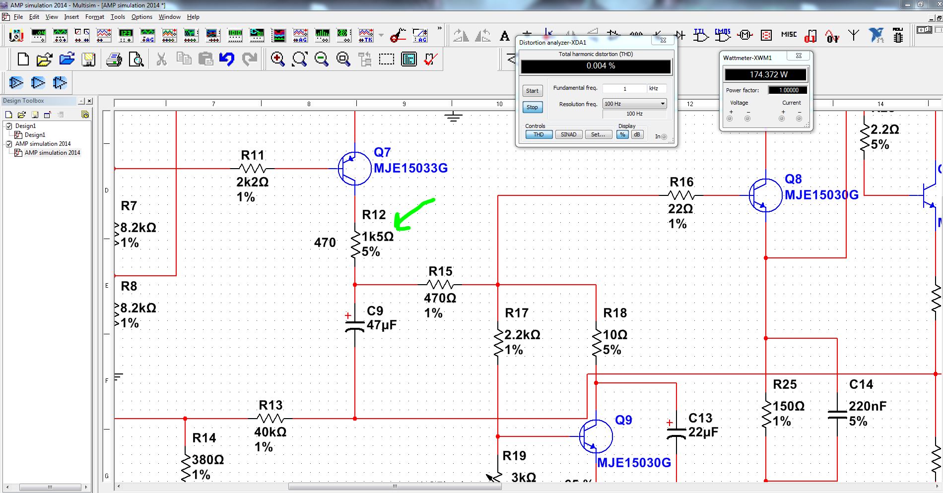

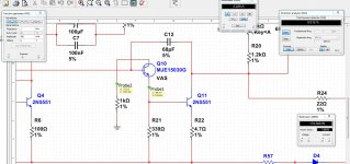

I check with different supply voltage as you mention but no changes, so I pinch somewhere in R12 and increase from 470ohms to 1k5 and now with 64V supply THD is low 0.004% the reason I'm doing this is in case I do not have a toroid transformer with 65V 0 65V I can then use 45V 0 45, this simulation is with 1KHz sine wave 500mVp input to 8 ohms load 🙂
Regards
Juan

for thr two set ups you have
64V > -4.6V drop, across the VAS Vce
90V > -5.8V drop, further from the supply rail = higher Vce.
Do the same for the +ve side and compare.
Taking the VAS very close to the supply rails will increase the distortion.
Conversely, using a smaller section of the available VAS voltage swing will reduce the distortion.

I removed and the circuit stop working
Q7 should be replaced with jumper between C-E, not simply removed, and than remove R11, too . It is basic misunderstanding about principles of circuit function..And You have to swap Q11 and Q10. R12, R15 must be minimum 6W (better 10w) resistors, for +-90V is dissipation 4,3W for each (if value is 470R), also Pc for VAS transistor will be near 9W!!
But how is this possible, if
No modifications allowed to this design...already made
It is not possible to develop amplifier only with simulations .
