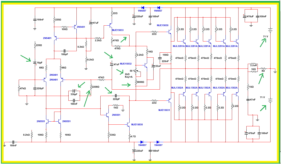

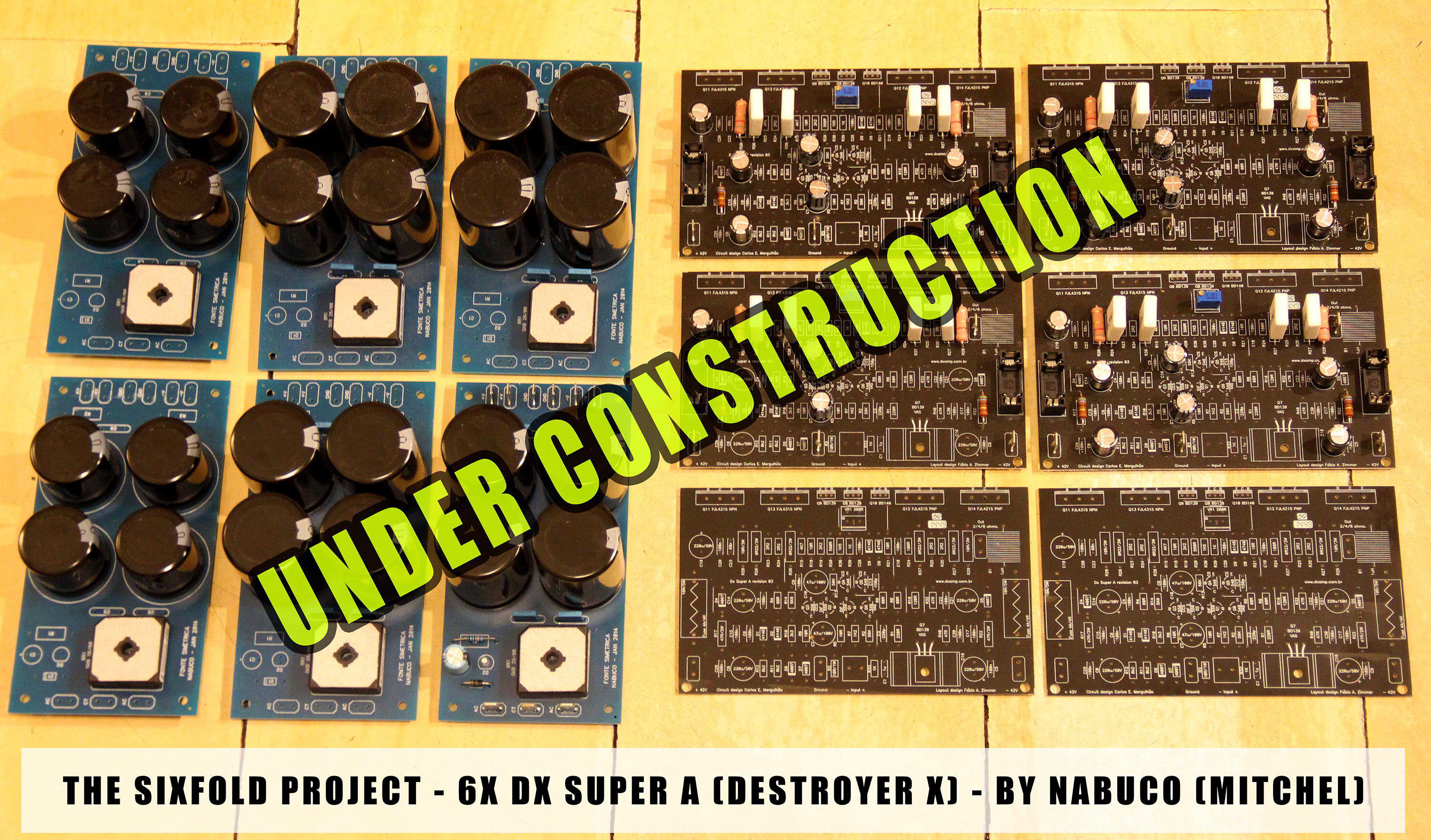

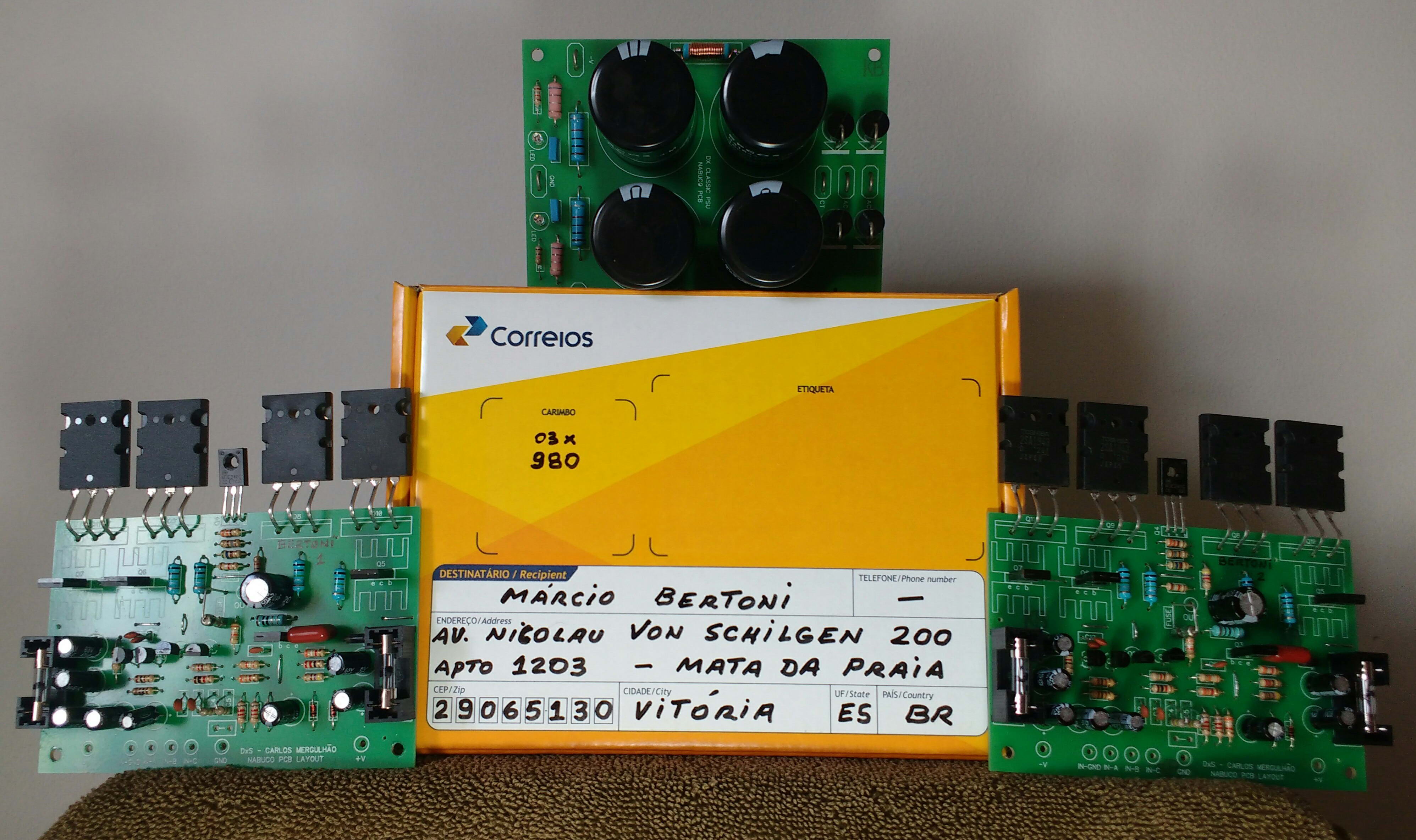

Here you have a special version made to Mitchell
He wants a subwoofer amplifier to operate together 6 Dx Super A amplifiers.
These SA amplifiers will be connected to woofer (mid bass) to squawker to mids and to a tweeter to highs.... because stereo, 6 units are being assembled.
He wants the MKIII operating 71 plus 71 volts to drive a subwoofer enclosure, with a 4 ohms speaker.
Then i have made modifications in order to fill his needs..small modifications, but the main one is the removal of the boostrapp due to the fact it is generating some strange signs while clipping.
Distortion to 35 hertz at 520 watts RMS is 0.001%
Modifications made in the VBE multiplier resistor values and iddle current should be adjusted to 15mA to each one of our 10 power transistors.
This amplifier resulted flat from DC to 100 Kilohertz, despite made to use as a subwoofer amplifier, but you can jump the input active filter (Mitchel gonna use an active filter in the input) and inject full range audio into it.
Sensitivity was adjusted to 2 volts RMS to drive the unit full power....the 2K2 resistor is the one adjust the gain.... reducing it you have more sensitivity..or less audio level gonna be needed to drive the unit to full output power.
Mitchell is calling it 6fold.

  • Dx MKIII Nabuco.pdf
    Dx MKIII Nabuco.pdf

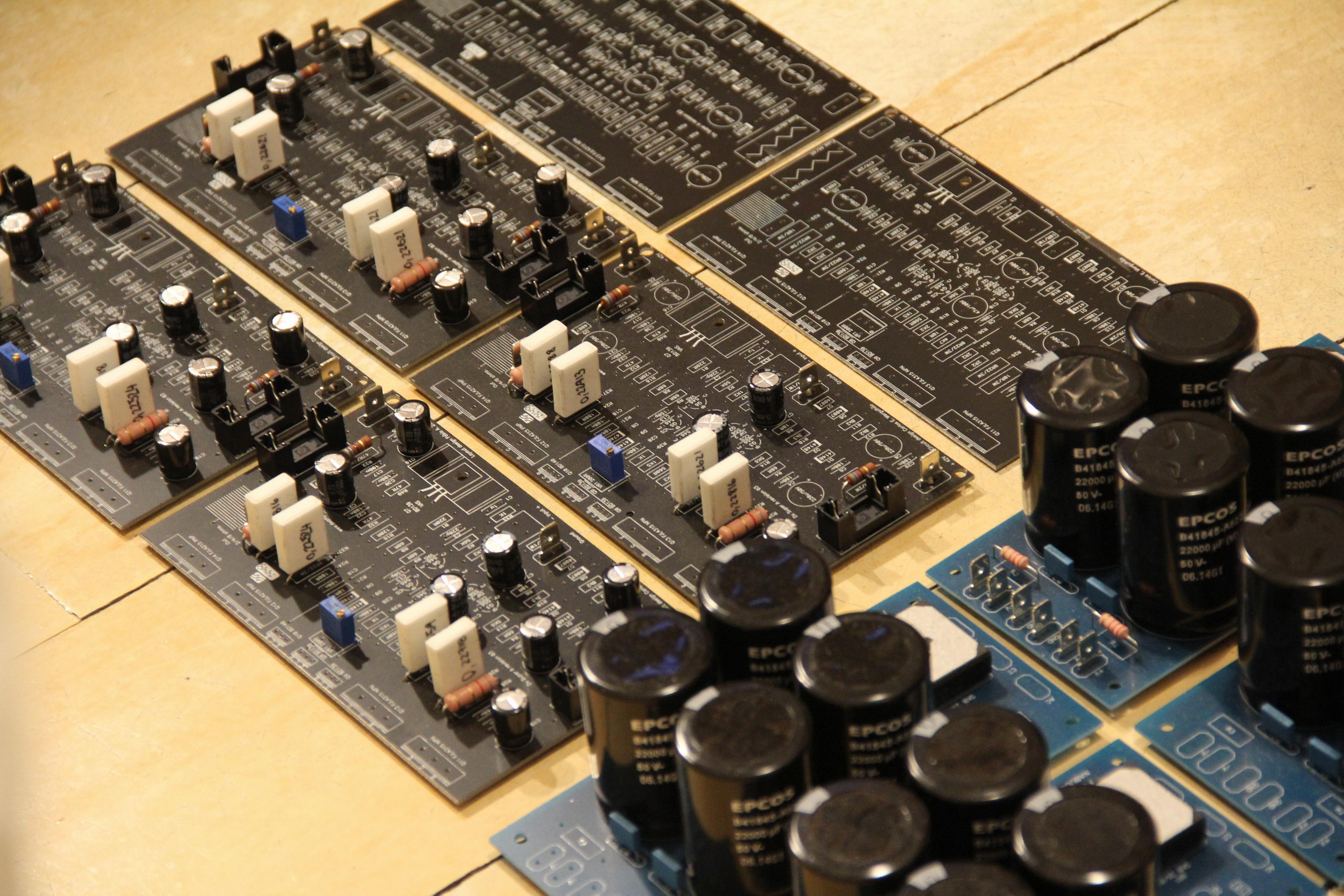

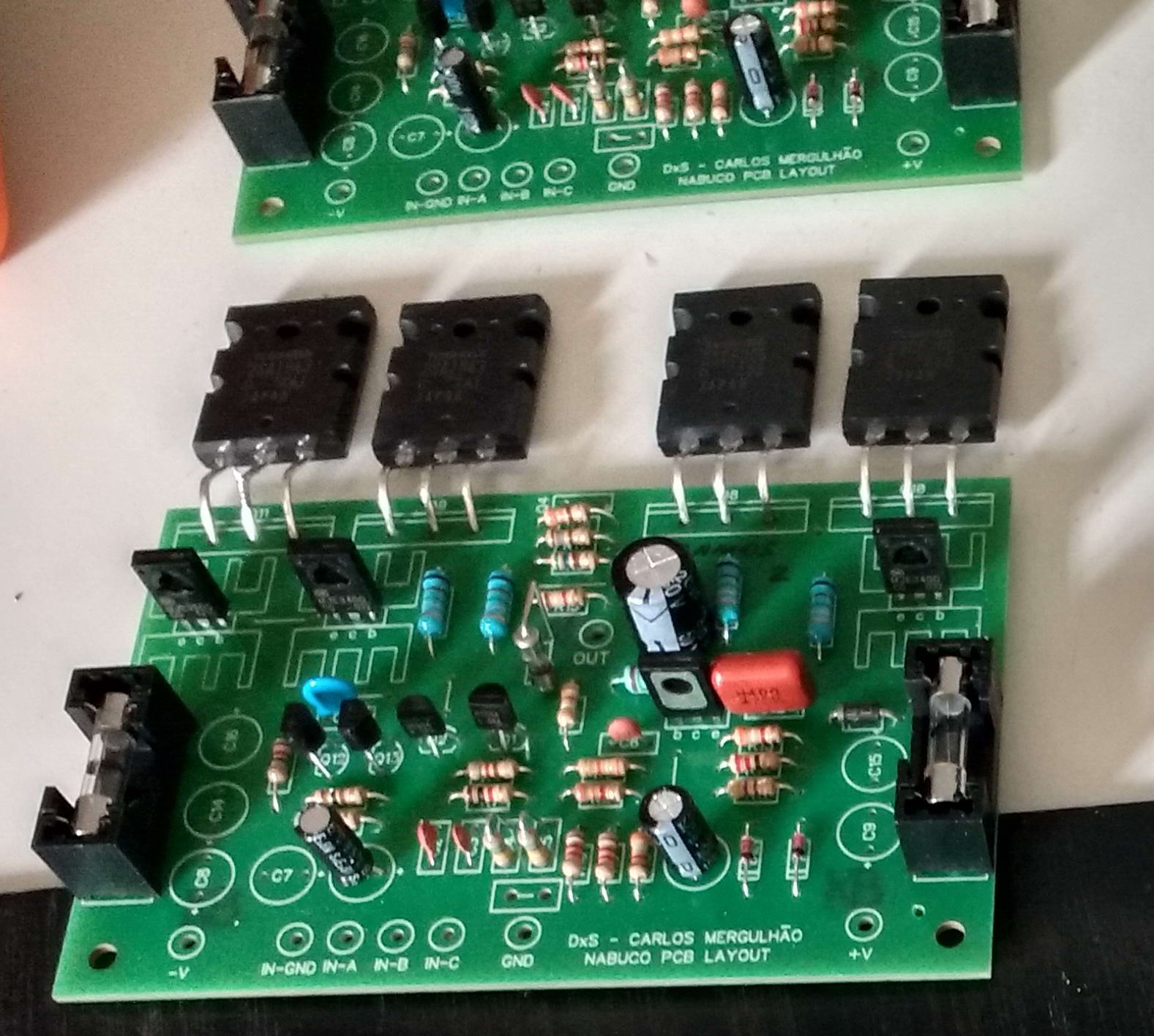

These pcboards are black.
They look brown.....was because a Canon camera that had white from the floor reflected back to the CCD.
Here another picture, taken by a Lumix camera.... daylight, no flash, blue sky and white background.
Despite look green..it is black to human eyes under natural light
ATTENTION:
If you intend to push the limits, going to 300 watts RMS at 2 ohms, or if your heatsink is not really huge..then detach driver transistors from the main heatsink, keep them vertical and install 3 to 5 watts heatsinks on them.
Above suggestion is to Dx Super A, but this is usefull to all amplifier when operating high power with under sized heasinks.

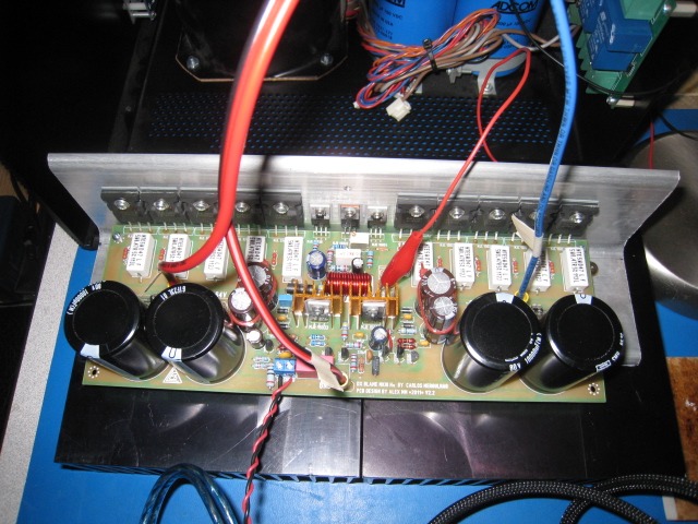

First Dx Blame MKIII-Hx PCB Completed
I thought I would report in on my first diy amplifier build. I purchased a couple of bare pcb's off of a fellow DIYAudio member earlier in the year and just completed my first pcb. I made one mistake by putting in the wrong part but it was discovered when I went back to verify all the parts. The amp PCB is installed in the chassis and sounds wonderful. I did make a few part changes based upon issues discussed earlier in the Thread, mainly resister changes for amplifier gain and so on.
Thank you everyone for this wonderful Thread.
