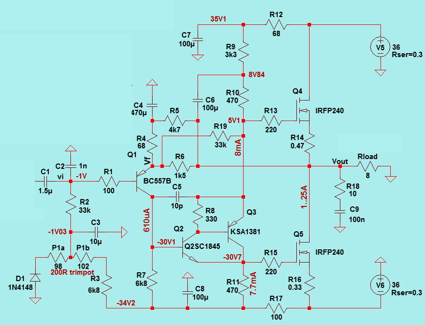

The same mistake (useless transitor ) is just here, http://www.diyaudio.com/forums/solid-state/193759-dx-blame-mkiii-hx-builders-thread.html#post2656123 , in original circuit, also 470R resistors are marked as 1/4W types..
Are you saying that Q7 has a negative impact on the operation of the amp?
Q7 in last schematics is without emiter resistor, so it is no current source, but "something" like bad switch. And series combination of 30mA current source (to high for VAS, poor linearity) with bootstrap (2x470R, 47u in midpoint) as in first schematic (Re=22R) in this thread, is very bad solution. And 30mA and 470R means 0,423W dissipation. Resistors are 0,25W. Here are too many mistakes, it is away from blameless..

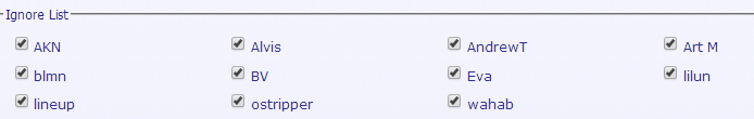

You are one of the lovely guys that are in my ignore list....the reason why is obvious...people have just to read to understand your behavior trying to be famous with other guy's work....try to do some work yourself.
Uncle Charlie ignore list has less than 12 folks..and they are the best from the best..the cream of the cream no doubts...as we are more than 200 thousand and you where selected to be present in my most special list.

Q7 has not negative effect Terry

EDIT: I checked the real schematic and Q7 does have a 47R emitter resistor. Juan left it out on his schematic.

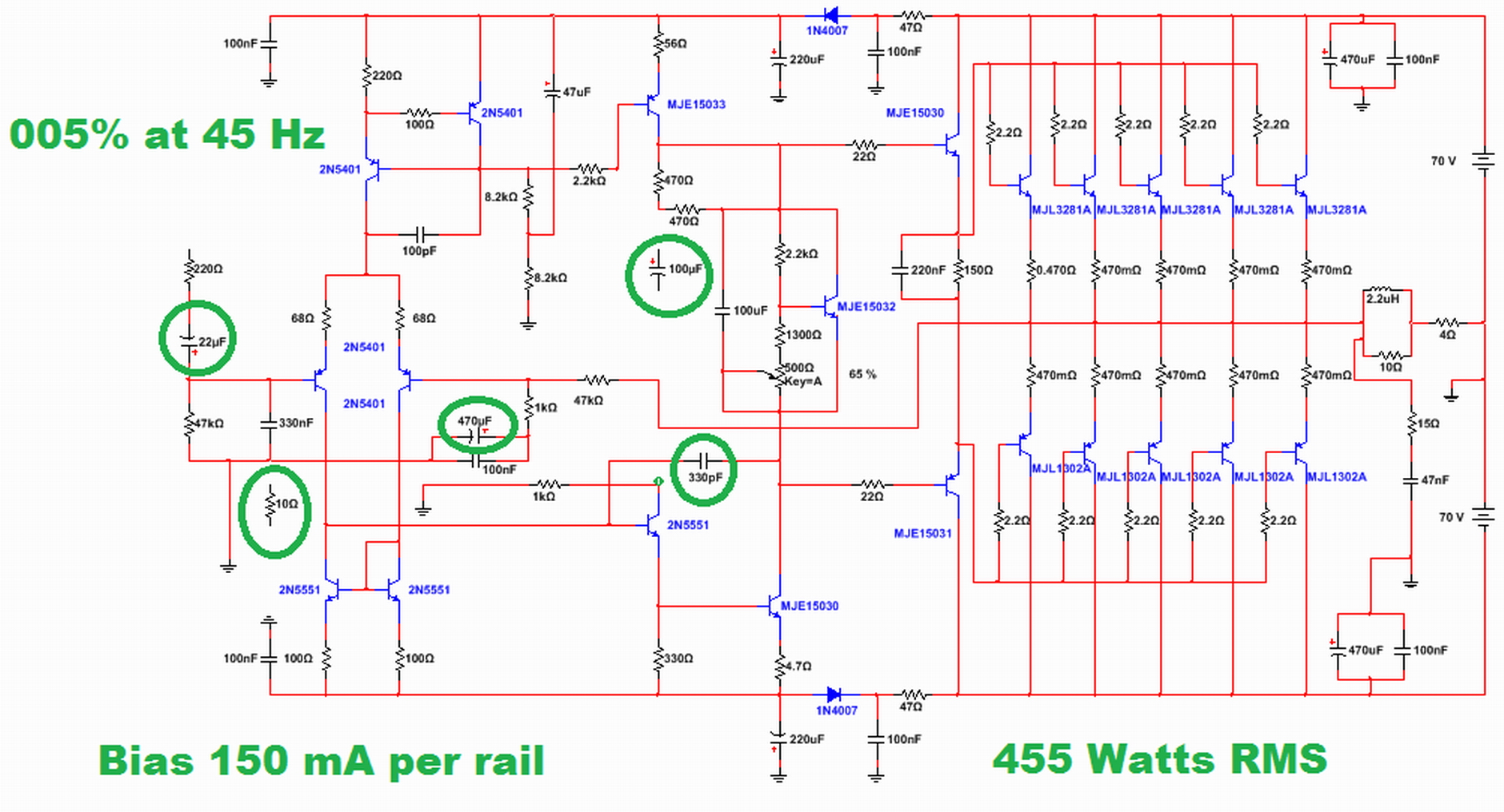

A friend asked me to tune the MKIII to use as subwoofer amplifier
He gonna use an active filter (op amps)... and this amplifier will operate from DC to 150 hertz... he asked me to put it to 4 ohms and distortion he asked less than 0.010%....i made it to 0.005%... also the input gonna be 1.2 Volts RMS to achieve full power.... Power achieved was 455 Watts RMS at 4 ohms and distortion at 45 hertz not more than 0.005%
Miguel Nabuco (Mitchel) gonna use two Leach Amplifier channels only to Mid range frequencies.
He gonna use 4 Dx Super A to High and Super High Frequencies... all then gonna be optimized to his demands...
Here you can see his work to the subwoofer:
https://www.youtube.com/watch?v=1I3phnr7ihQ
https://www.youtube.com/watch?v=nK-p2k198RE
Schematic attached for you to see...optimized to 45 hertz....frequency response drop abruptelly above 2 Kilohertz even if you inject full bandwidth noise on it..input capacitor filters.... high frequencies goes to ground... just in case.
Marked in green are parts removed or changed in value.
He may produce this stuff to sell in Brazil..but inside gonna be Godzilla amplifier from Dx.
