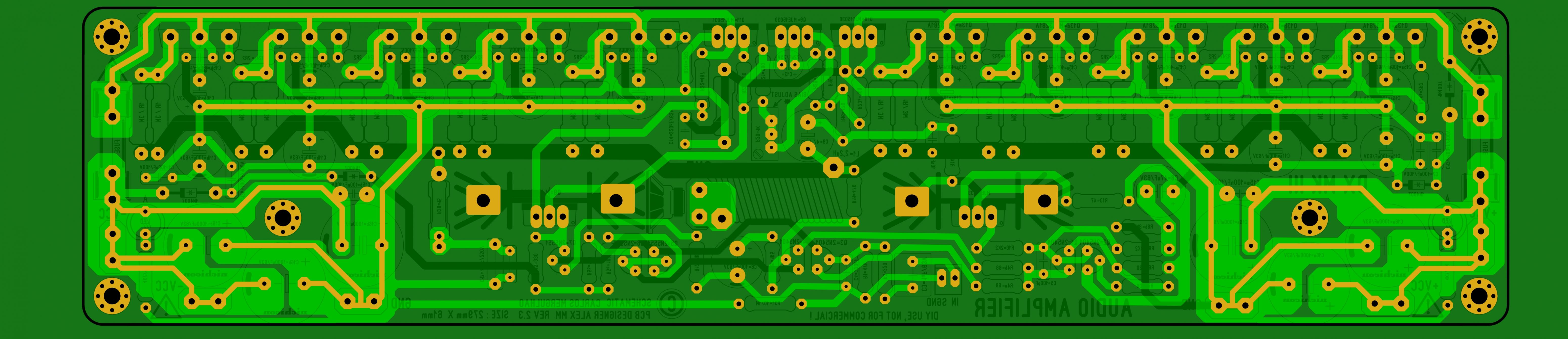

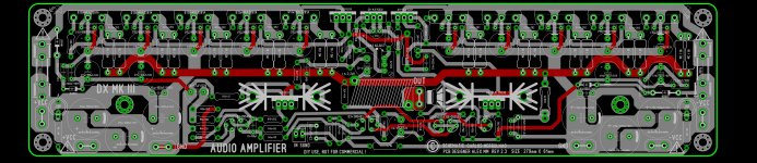

AlexMM has provide me the Gerber files .I know some cut a trace regarding the lifted ground and some guys didn't because they didn't have an isue of hum or what so ever .I contacted Alex to ask him if he had changed his MKIII layout.
About pricing I hope to get around 24 Euro/pair ,all depend on the amount .
Shipping cost ,I've to check that .
New layout

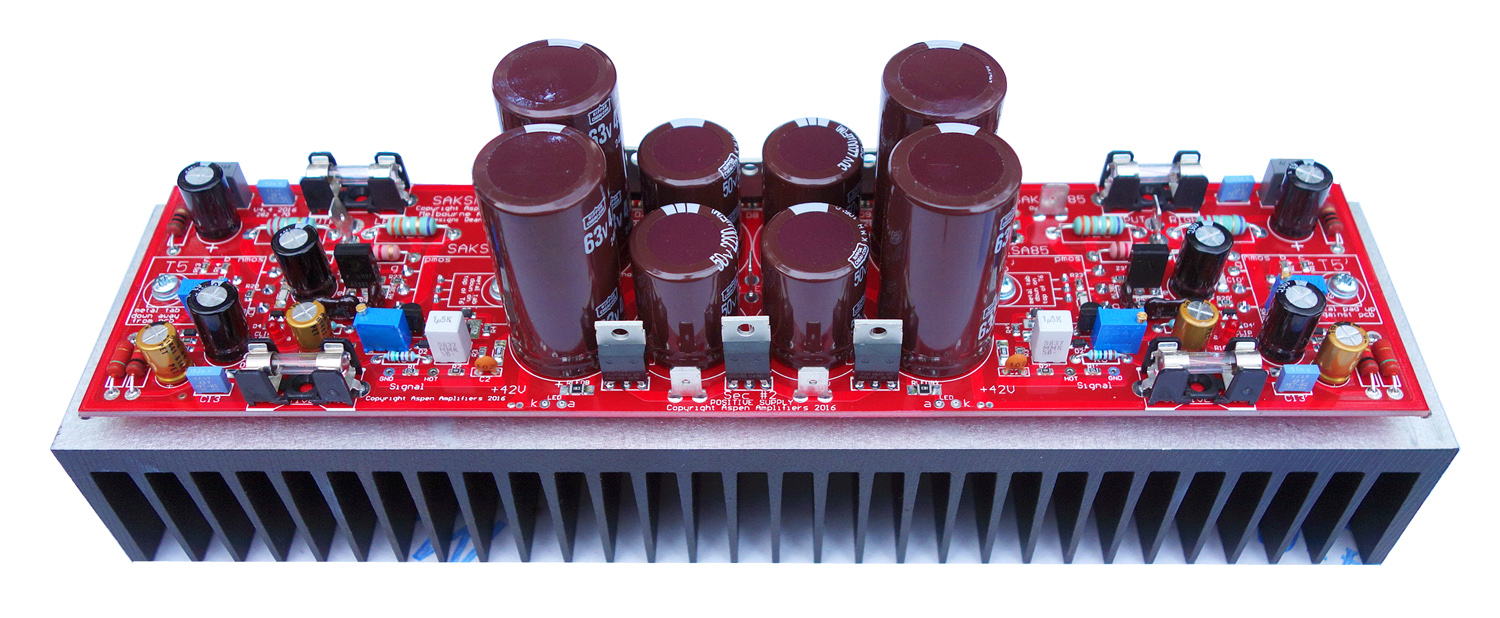

Very lovely pcb - and daughter, Carlos!!
I am very pleased you are selling lots of amps in Brazil, you deserve to sell thousands.

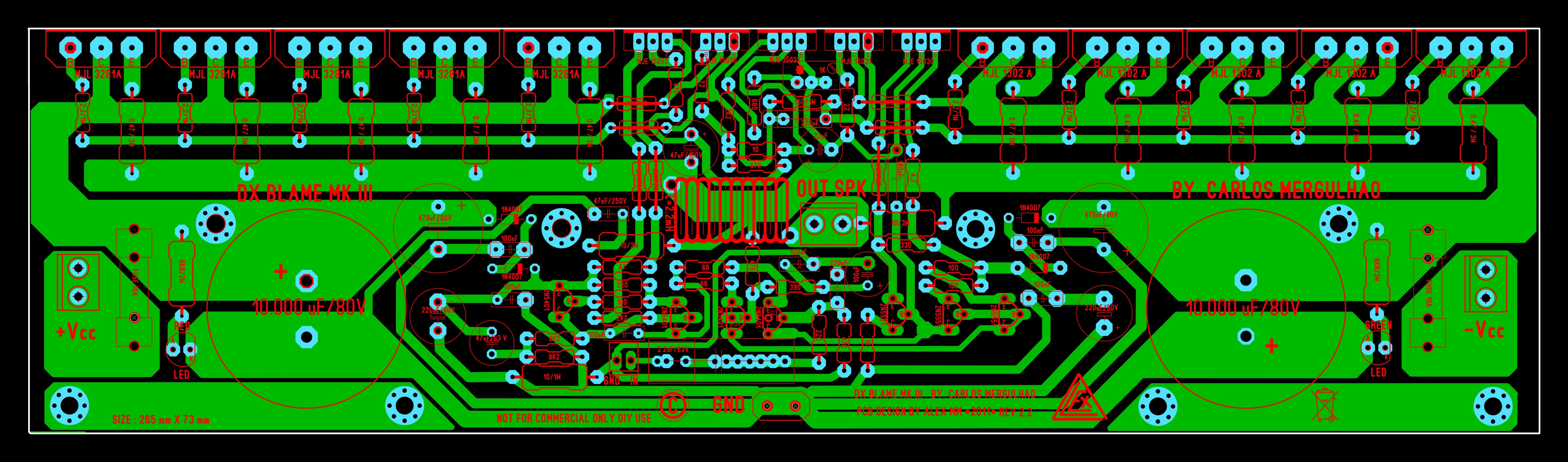

I cannot leave without leaving my latest for you to examine, Carlos.
Your old mate,
Hugh

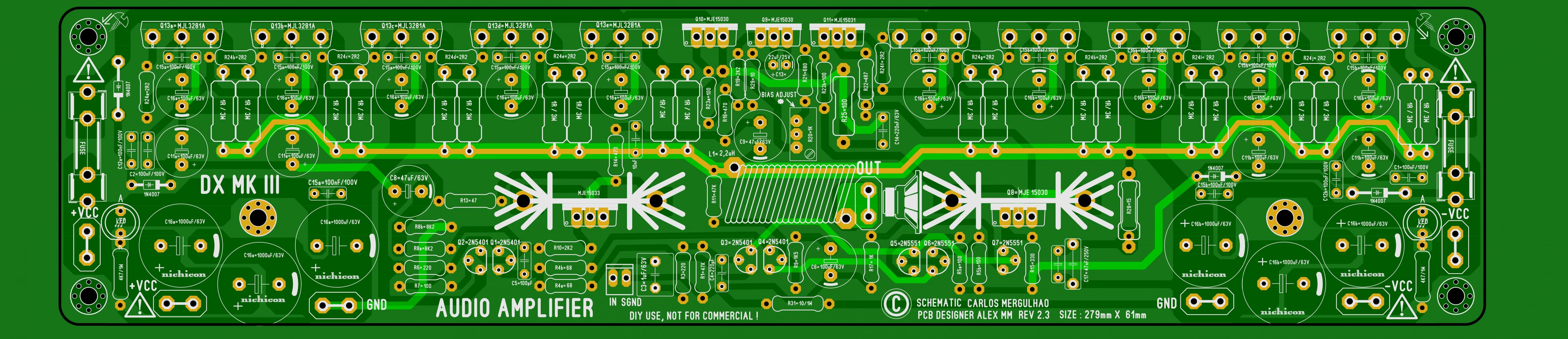

DX MK II pcb rev 2.3

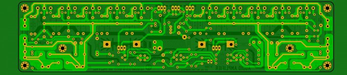

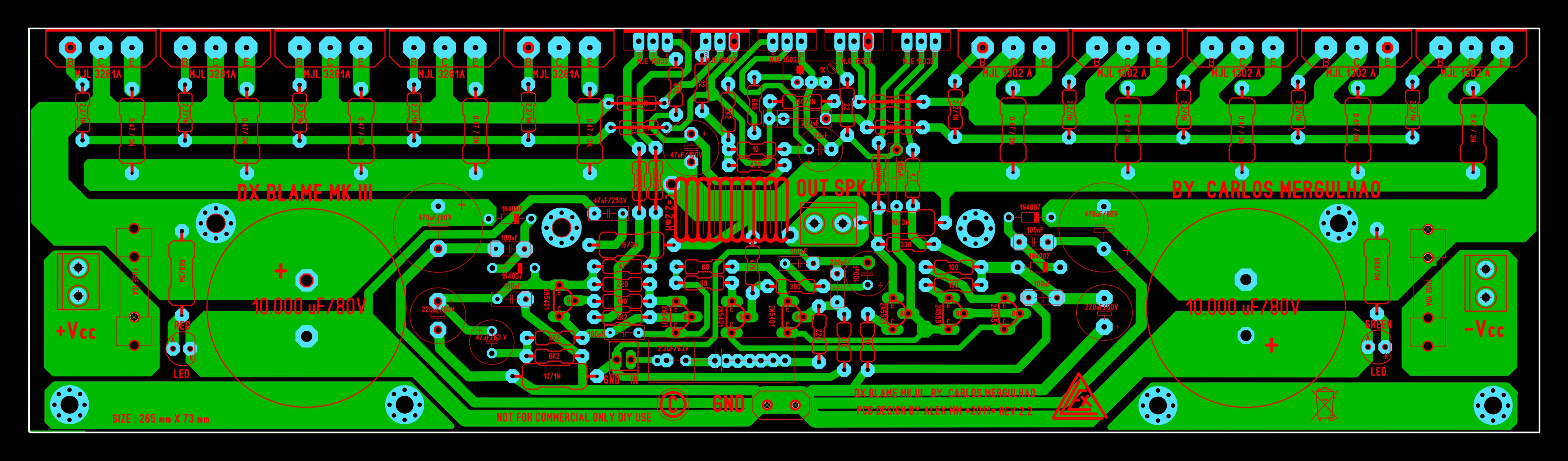

I have not disappeared yet, and I am still active and here is a rev 2.3 dual layer PCB for DX MK III amplifier ......was not tested yet . QC check are welcome .
Regards,Alex
