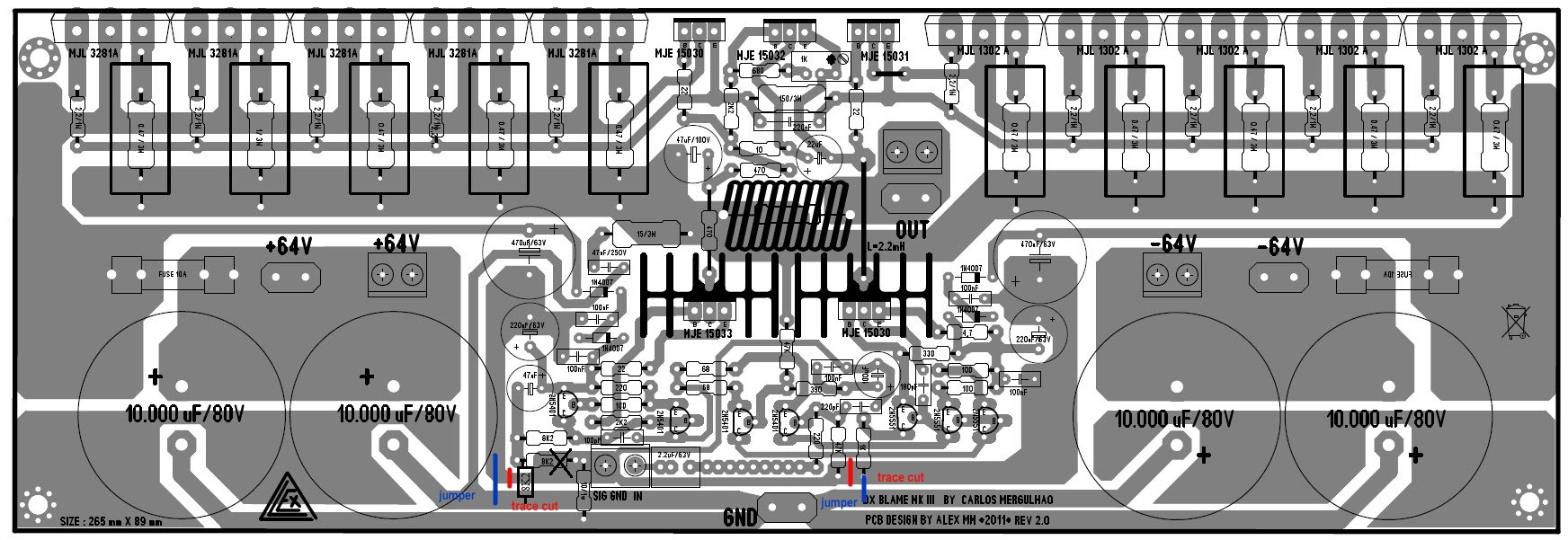

I have not disappeared yet, and I am still active and here is a rev 2.3 dual layer PCB for DX MK III amplifier ......was not tested yet . QC check are welcome .

I've just come back from hospital. Atrial fibrillation. Got fixed but still recovery will take some time. I see that Alex did quite good job. I'll try to check pcb consistency with the circuit diagram over weekend. At least I'll do random check of various parts. If I discover any discrepancies I'll report these. Has anyone found any layout errors?

I did not find any errors but I only checked randomly selected sections.

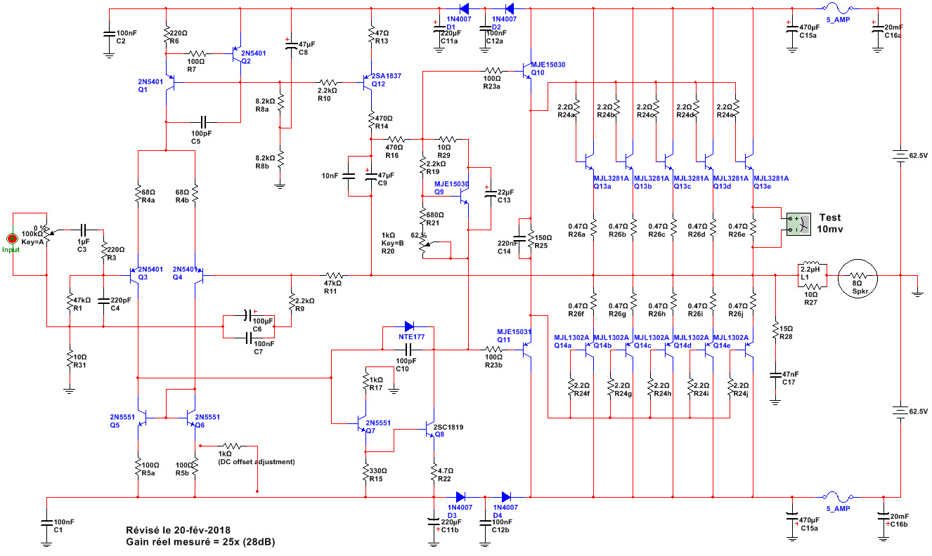

I do not know if you did here LT spice analysis. I have created two versions of this amp: single Miller and two pole compensation. Changed a few component values to get smaller distortion.
How things are going with pcb design?

How things are going with with PCBs Alex? Close to finalizing design and initiating production?

Attached are the shematic at 28dB gain and the PCB modifications I did over time. Dunno if they were documented here or not. PCB mods were to properly isolate the lifted audio ground for total silence at rest.
