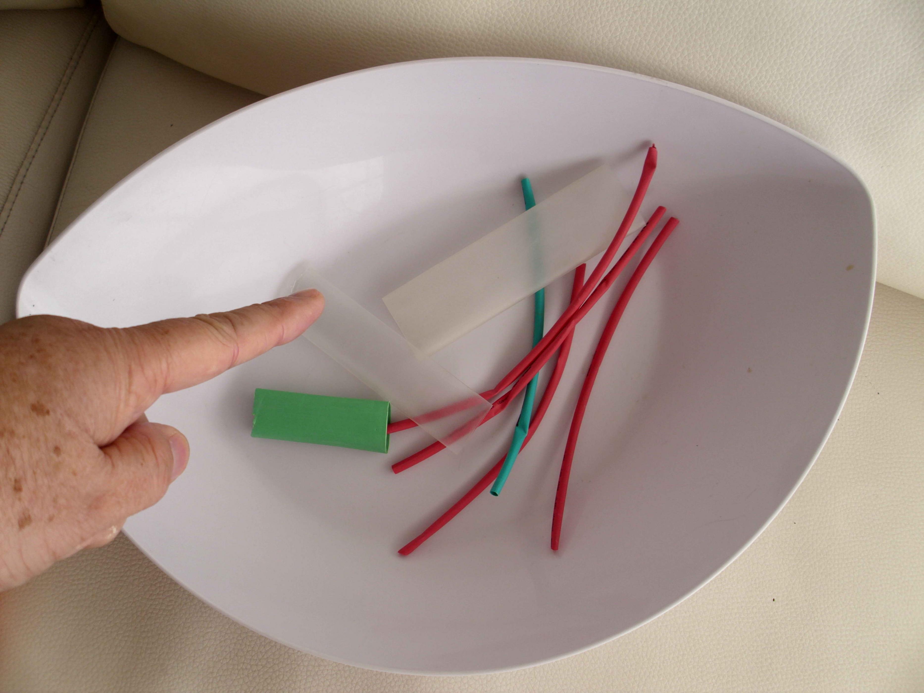

Interesting subject folks... at least to me.... heatschrink (retractable tubes) tubes are reducing diameter because exposed to light!... a friend asked me three days ago and i put them in the living room, nearby entrance door to give him the tubes.... and the place receive a lot of daylight, not direct sunshine, only difuse light reflected by apartment walls..and they are still reducing diameter.
We call these tubes, in Brazil, "espaguete" that comes from Italian pasta spaghetti.... has the tube shape... with a hole in the center.
In the reality these tubes looks more alike penne macarroni that has the tube shape.

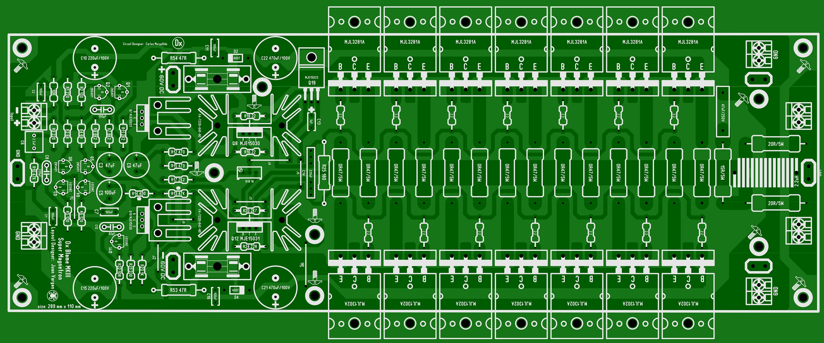

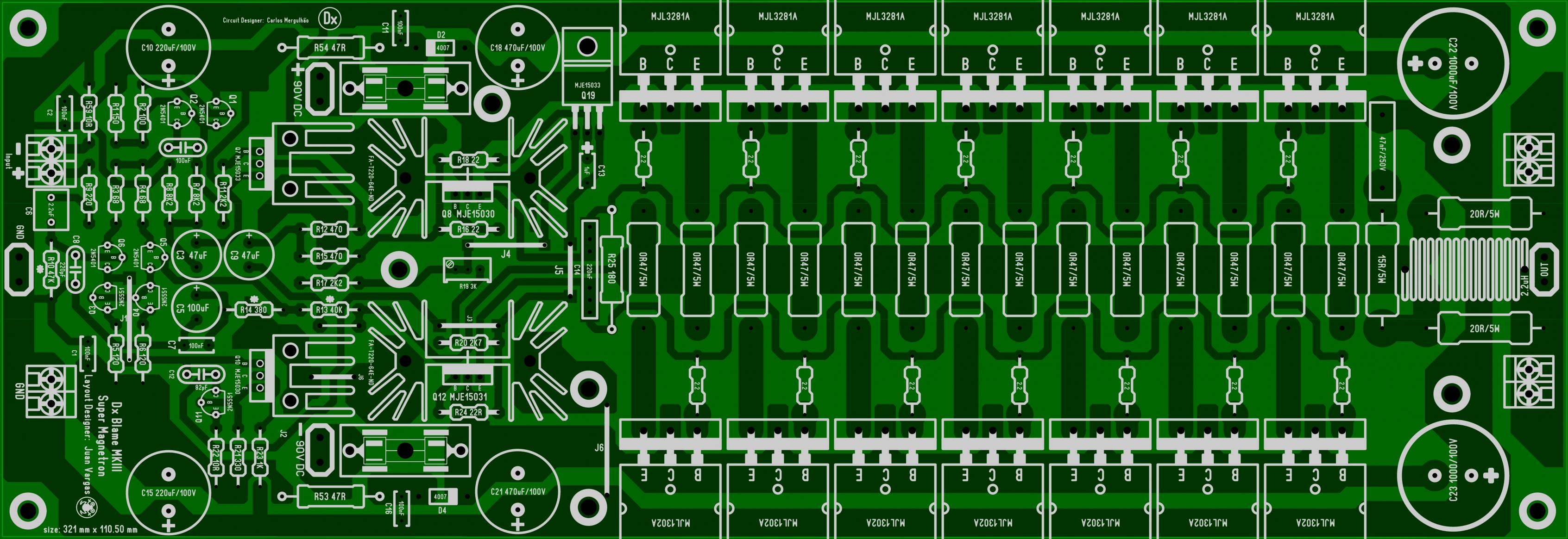

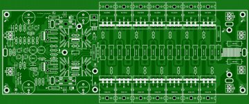

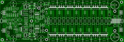

Today I was able to add an extra pair of power transistors, the only thing I might have to change is the GND connection I guess I add too many 😀any way I just want it to show you guys 😀 I still exercise my mind 🙂
Juan
Beautiful work Juan.🙂
IMHO, the drivers MJE15030/31 would have a bad time driving 7 pairs of outputs. shift them on the main heatsinks.
Aniket
Aniket

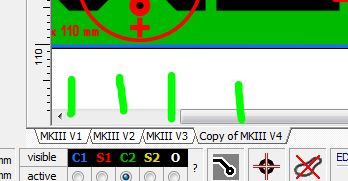

I might do that 😀 at least what I do is clone the board to the same file if I made a mistake I can go back always, the heat sink I already made the macros for this part number FA-T220-64E-ND Digi Key
Regards
Juan

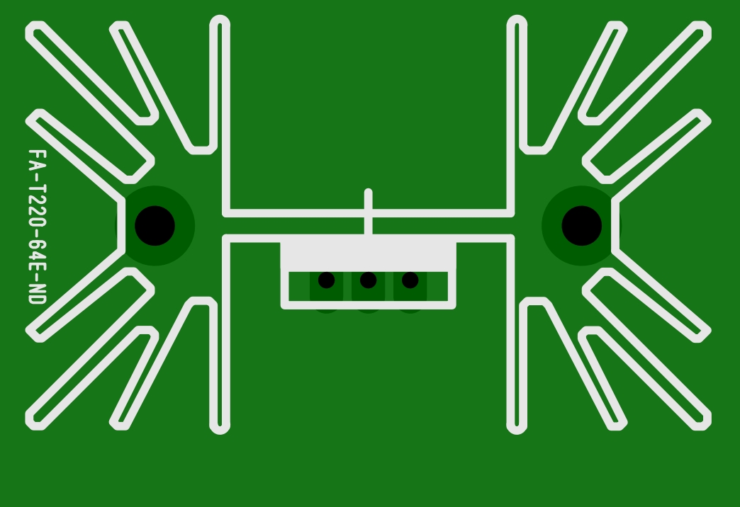

Hey Carlos sorry that I'm asking you old questions since I add an extra pair for Dx Blame MKIII I notice by curiosity that when I increase the power supply to +90V - 0 - -90V the THD goes down but if I use 64V as you recommended the THD goes up ? isn't that weird or not ? 😕
Regards
Juan

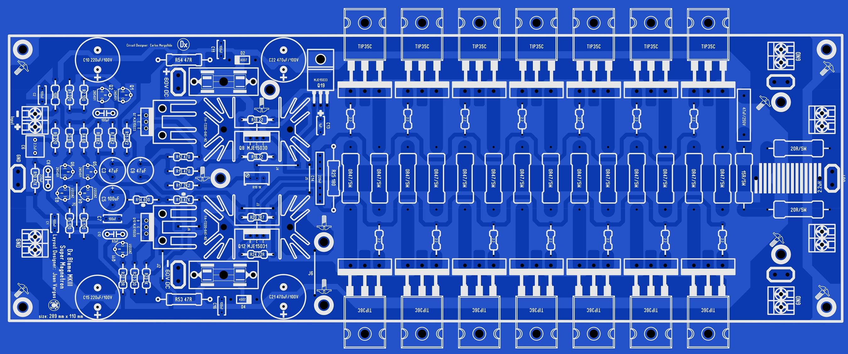

Today I made another copy of the layout with TIP35C/36C to see how much space is available and looks pretty good I think 😀, today I will continue to see if there is any errata somewhere yep, is always something hidden jejejejejeje 🙂
Regards
Juan
Regards
Juan
Great work Juan,
If Carlos permits, one more thing could be upgraded, i.e to convert it to a TEF output stage using one set of outputs as the drivers. although the drivers(MJE15030/31) could drive 7 pairs of high beta devices but the VAS would be heavily loaded driving a low impedance load.

Hey I only making the layout using same schematic that dear Carlos did same way,
I'm not trying to change it I'm only putting new "clothes Armor " to it to have a bit more juice 😀 the schematic remains the same I just add only one more extra pair that is it my friends, but seriously I'm fallowing Carlos schematic same way 🙂

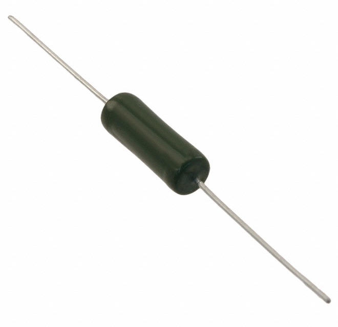

Looking good Juan,
One suggestion, maybe add some extra holes for the emitter resistors to give some choices.
Looking good Juan,
Now that you mention I was thinking about that the other day I forgot thank you 🙂
Regards
Juan

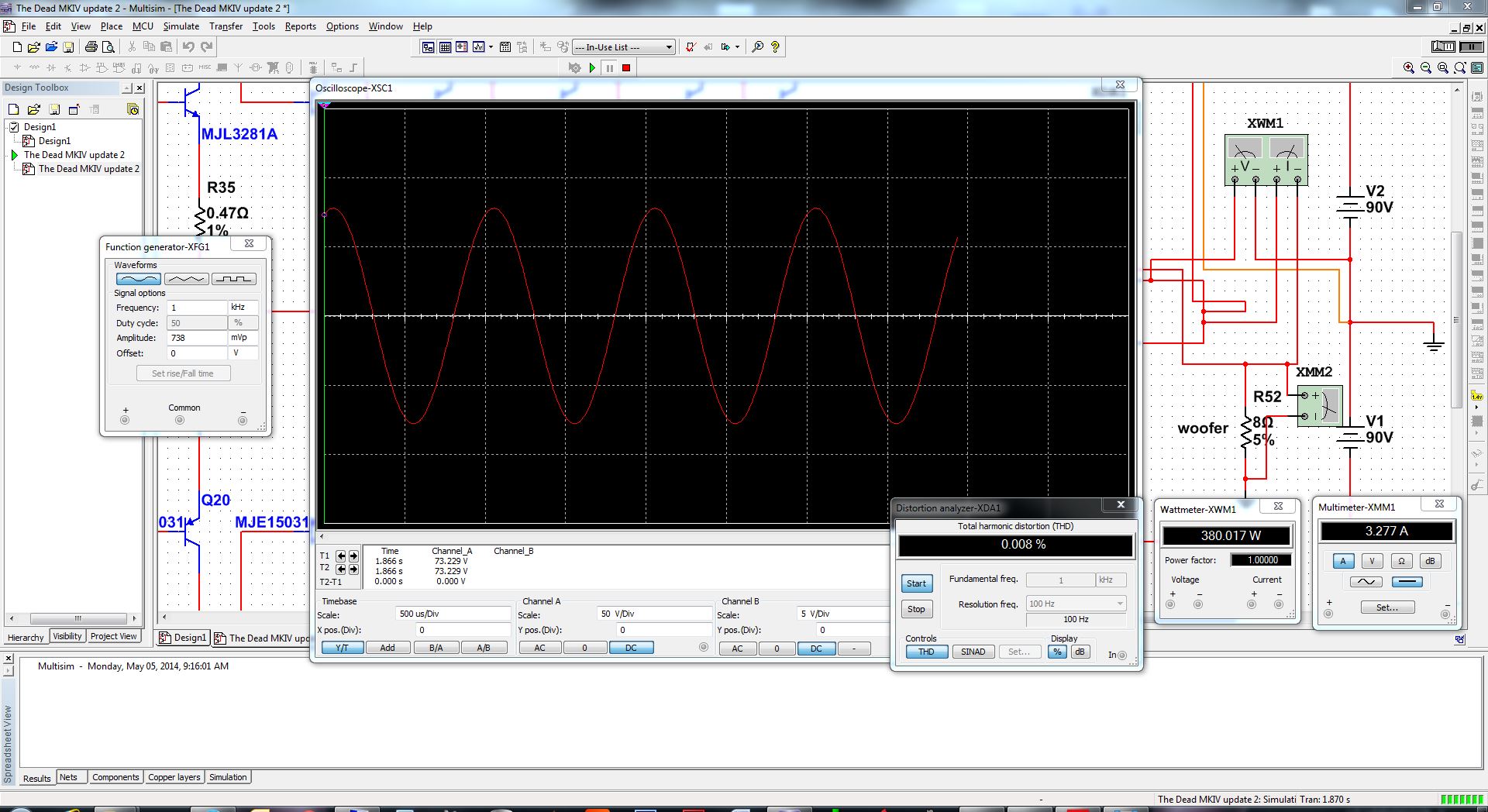

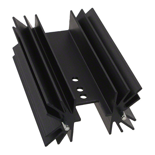

If you are going to drive 7 pairs of outputs, you should use bigger drivers - NJW0302/3281 or 2sa1943/2sc5200 would be ideal.
You could also consider adding pre-drivers but Carlos would not approve of that I'm sure :-D
uhmm? well I have seen heat sink design for those type of transistors, I might see if I can place the drivers just a the power transistors on the same large heat sink or separate, I was simulation with multisim 13 and wow I understand that to have those result in real time I need a really large toroid transformers and lot of caps but this is great anyway according to the simulator at 2 ohms load it can give about 1178KW but for that to happen will need lot of current about 11A I'm only curious and also the THD stay really low too 0.007% ok dear Ranchu I will see what I can do with those larger transistors as drivers 🙂
Regards
Juan
It is easy to increase current into drivers....the resistor
in between the emitters...just reduce it and you gonna have more current.
Current is enougth, not needed to increase...current is driving even 2 ohms loads.
Yes, i do not approve modifications into something that is working fine.
Also i do think we should not mess with diagrams accepted by several folks, and built by several folks..it is disrespect.... after they buy the idea and assemble you start to change the whole thing.
If people want to apply their own ideas, i do think they should buy the whole package... and not produce interferences in something others have worked hard.

Carlos do not worried this is my personal project not intended to change the original Dx Blame MKIII the schematic is the same so I notice you wrote that long paragraphs that means that it does bother you so I will not show the project anymore here and keep it to myself is that what you want then I will close this subject today and not show it anymore this new layout and keep it to myself is that what you want? I will respect your answerer like a gentlemen no problem dear friend . 🙂
