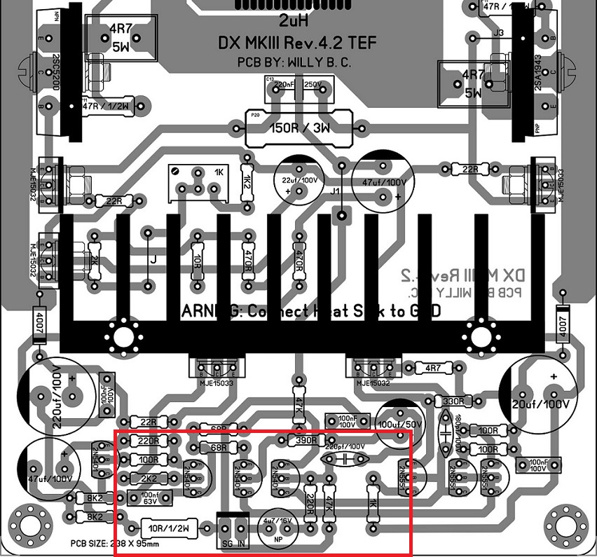

R17 is not a signal current. Connect it to the Power Ground (the other end of R31).
If the Q7 is passing the correct current (~1mA) then R17 will also pass ~1mA.
It should drop ~1V
P = IV = 1*0.001 = 1mW
It can't burn out.
It is there to prevent Q7 burning out.

Hi Willy-
I made this mod also and had no problem with R17. It doesn't make sense that moving that end of R17 from the lifted signal ground to main ground could cause the problem. You are only reducing the resistance from collector to ground by 10 ohms (1%). I think you must have a wiring error or short somewhere. Are you sure you cut the correct trace?
Steve

Hi Terry,
I tried to follow your mod last night but R17 (1K) burns out...
Please clarify did you really include R17 to the main ground??

I looked back and I see that I connected R17 to main ground.

Mods applied and it works now, Thanks Terry...

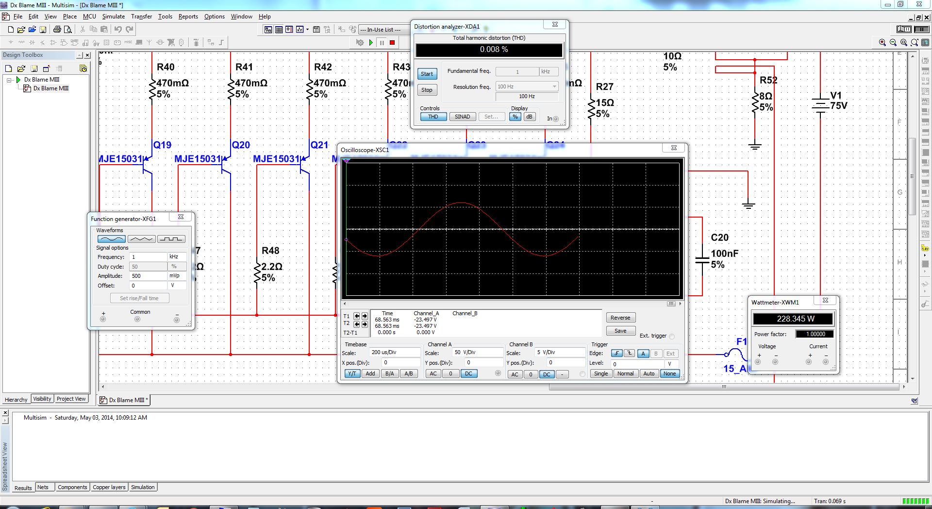

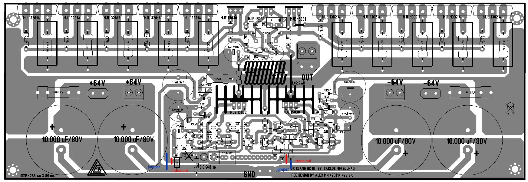

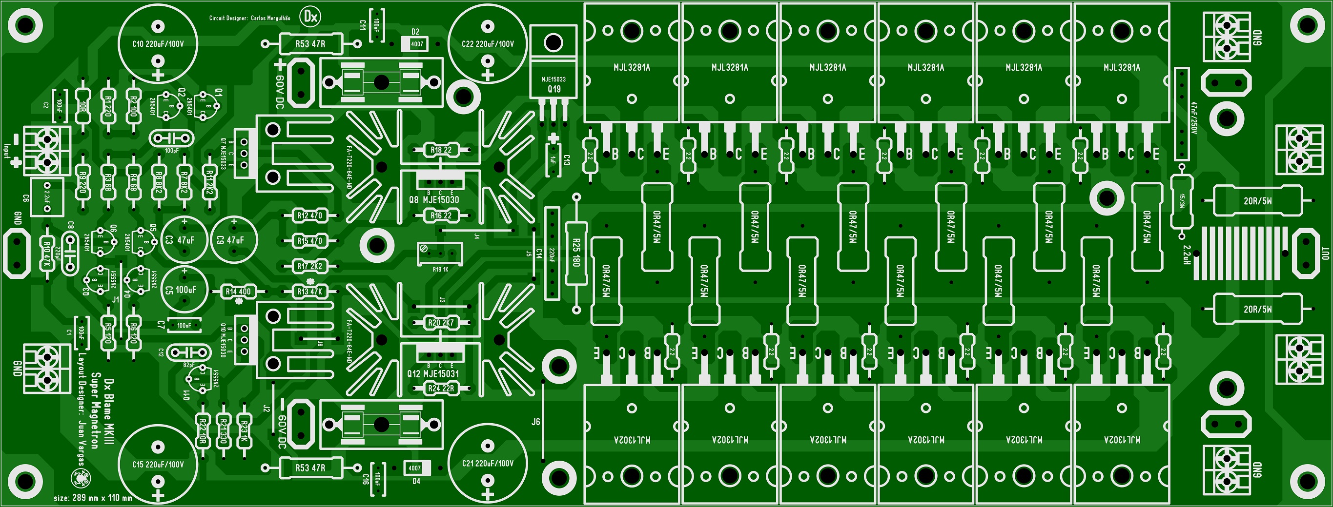

Hello guys 😀
This is a bit crazy what I'm doing right now but I will post it any way, this is an old layout I did last year and I never have the change to try out is basically Dx Blame MKIII same circuit that Carlos design already I just want it to try different style layout.
What I have in mind about the layout is the distance between main power transistors so this might change later on, also the fuses I also have to relocate them too, any way this is my project to have fun 🙂.
Regards
Juan

I see on this layout that the only thing on the lifted ground is the input itself. I also notice that the ground runs continuous around the entire board. I see like 5 different locations for attaching to ground. I don't know a lot about it but since I had trouble getting rid of ground hum issues on my boards I look for that. It will be interesting to see if this ground scheme fixes it.
Blessings, Terry
Blessings, Terry

Hi Terry,
If I turn this resistance 8k2 as shown on picture and cut the tracers and make the 2 jumpers then it is good?

Hi Rudy,
Yes, that is exactly what I did. That makes the PCB match the schematic. I still have a very slight hum but it is very slight. Not noticeable unless you are very close to the speaker.
Hi Juan,
You say you have no hum. Is you amp mounted in a case with earth ground attached? Mine didn't hum until I put it in a case. Even then it didn't hum without something attached to the input. It took the modifications that Rudy is showing to get rid of it. As I said, with those mods, it matches the schematic.
Blessings, Terry

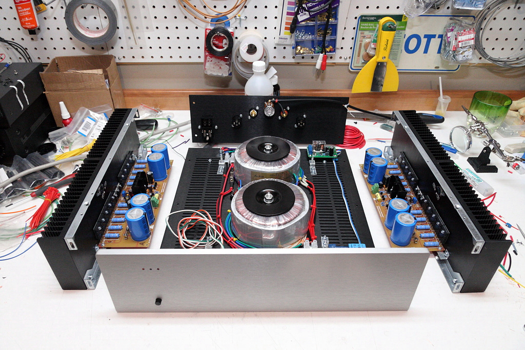

I never has the chance to have it in a chassis yet, probably is because the magnetic waves from the toroid transformer or earth problems affect yours, did you rated the toroid ? I read a long time ago that on building amps the toroid has to rated to specific way to keep magnet waves to it lowest level possible.
Juan
Hi Juan,
Put yours in a case with earth ground and then let us know if you still have no hum. Mine was fine spread out on the bench.
