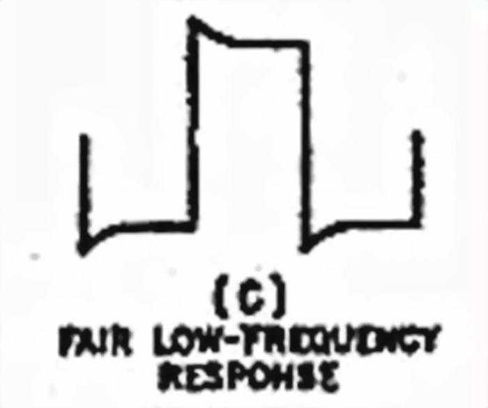

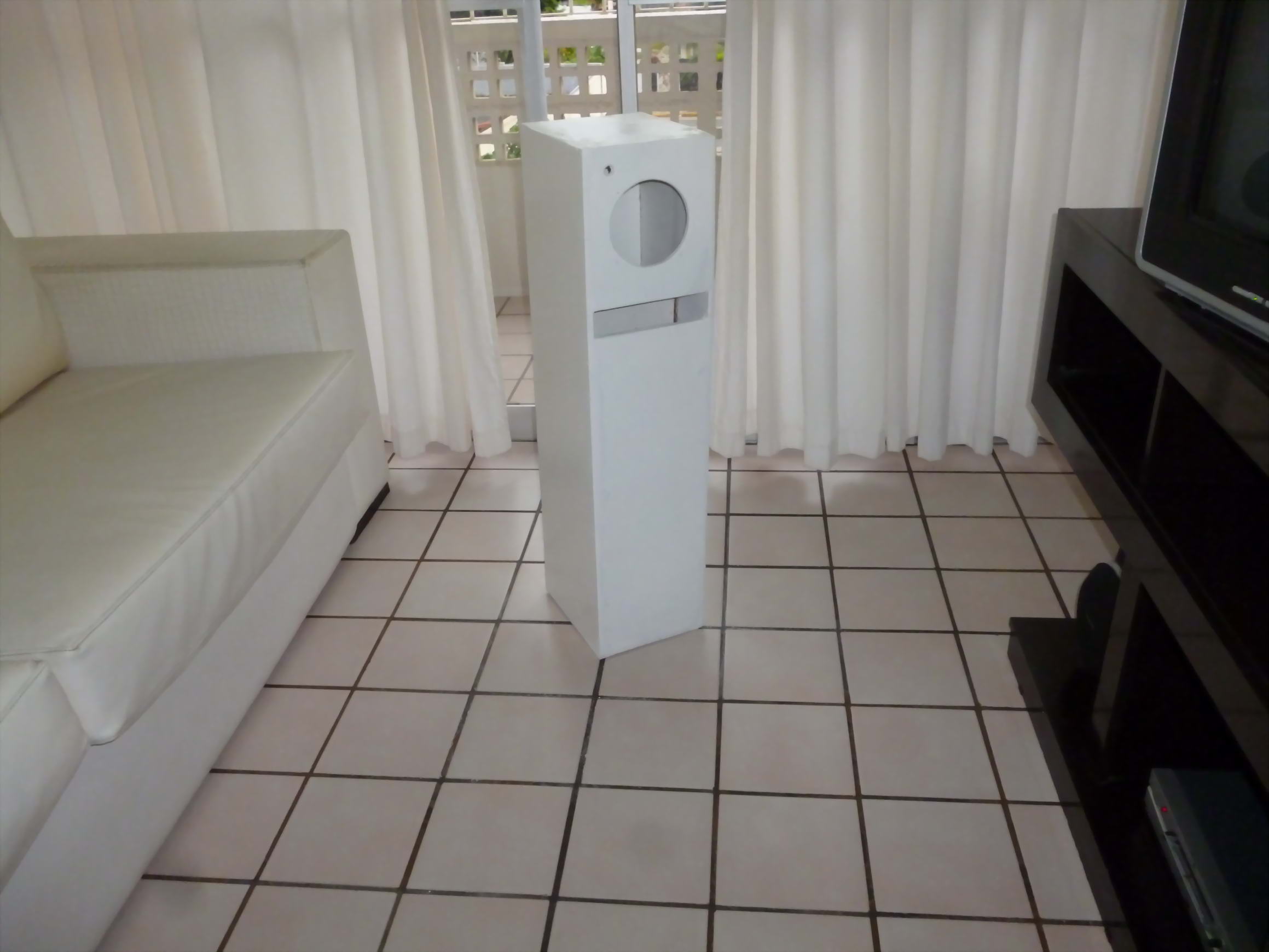

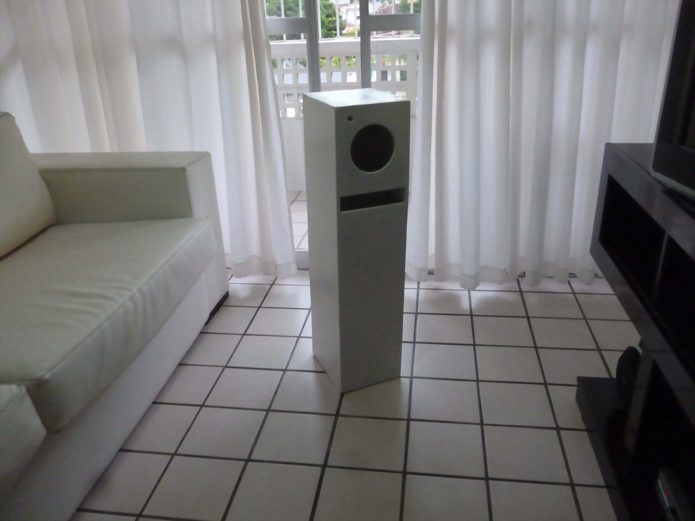

Here is Carnival time .... a moment to have fun...but i do like to do electronics
Producing transmission line speakers....audio quality result if fine.
Some books says overshot is fine!
regards,
Carlos
