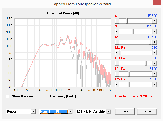

Maybe we need to review the approach we're taking with the HornResp sim. Perhaps treat the entire section of the horn that's directly in front of the driver as a "throat chamber", and start the horn off from the first section leading out of it.
...and here's the results of a quick rough sim showing just that. In grey is the predicted response of my last sim attempt. In red is the predicted response when treating the entire section in front of the driver as a throat chamber with cross-sectional area equal to the first section of the rest of the horn, and putting S1 and S2 at the start of the horn.

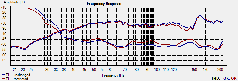

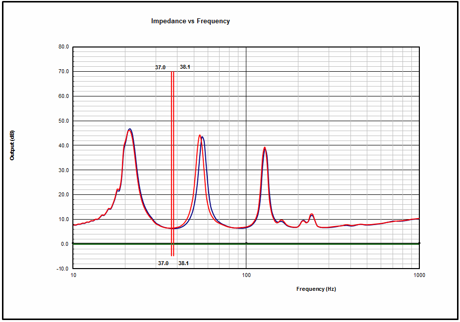

Here's the results of a quick test I did this morning to sim the impact of placing a driver with a larger volume @ S4 in a TH. The TH in question is my POC#3 and to the sim the impact I just added a few bricks at S4 that effectively choked off about 25%~30% of the horn at that point, not including the impact of the driver itself which of course makes it quite a bit more.
Results:
1. Fb dropped by about 1 Hz (3%) and there is corresponding minor increase in response below Fb
2. Significant changes (2~3dB) at the upper end of the TH's passband (90~150 Hz). It looks in fact that a "notch" is starting to appear between 130 Hz and 140 Hz.
Which, interestingly enough, is almost exactly as I predicted
It does open up some interesting possibilities though, e.g. of easily "detuning" a TH if for a particular purpose you are willing to sacrifice several dBs at the upper end in exchange for a small increase below Fb. You can't shift Fb via DSP, but if you make a removal "step" that can be screwed into the TH at S4, you can reduce Fb a bit with little or no negative impact at lower frequencies, or at least that's what my measurements suggest.
