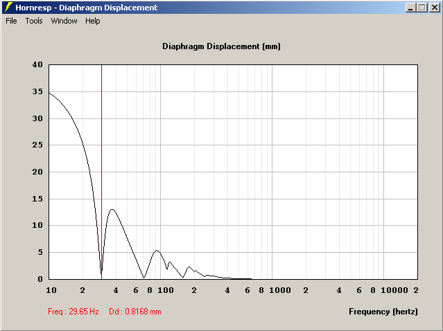

tb46, your sim looks nice and raises a concern I've been meaning to put out there. I noticed, in your above design simulation, that your ~(-3dB) point is approx 5Hz below the driver's Fs.
All, I was under the impression that a system's excursion minima, in a tapped horn at least, should be at or just above the driver's Fs (for balance reasons). I also seem to remember another member stating that they liked to do the opposite in a tapped horn - placing the first excursion dip below driver Fs.
How many of you have experience using tapped horns where the excursion mimima is lower (~5Hz or more) than the driver's Fs? Have you compared it/them to a TH system with the excursion minima at or just above the driver's Fs? Which sounds more balanced? Which had more distortion? Which sounded better to you? Any other comments regarding the above?
Tapped horns benefit from a low corner below the drivers fs. It helps reign in the in passband excursion peak
Thanks for your input! Might you have a good example or sources I could read into?

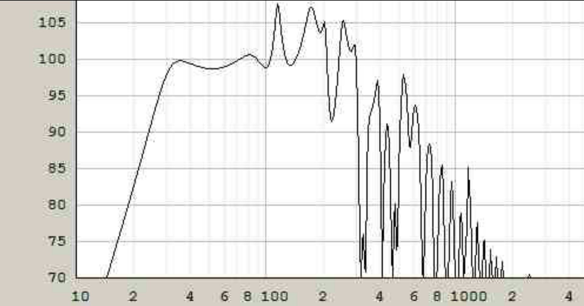

Below is a 30Hz TH model. Excursion minima is 31.40Hz. Black trace is 18SW115-8 (Fs: 32Hz, quite close); Grey trace is 18TBW100-8 (Fs: 35Hz, ~3.6dB higher) - maybe you have a better example, but I'm having trouble relating your statement to this one:

Hi CRESCENDO,
Post #143: "...your sim looks nice and raises a concern I've been meaning to put out there. I noticed, in your above design simulation, that your ~(-3dB) point is approx 5Hz below the driver's Fs..."
In the previous simulations in this thread I used the B&C 18TBW100 w/ fs=35Hz. I have gone back to look, I don't think I got the low point in the displacement graphs below 33Hz, and the -3dB points were in the high 30's, nothing close to 30Hz.

Hi tb46,
Are we speaking about the same simulation? If I'm not mistaken, the post of yours I'm referring to is a 30Hz TH attempt (which interests me), but it doesn't appear to have a -3dB point "in the high 30's" and appears to be very close to 30Hz.

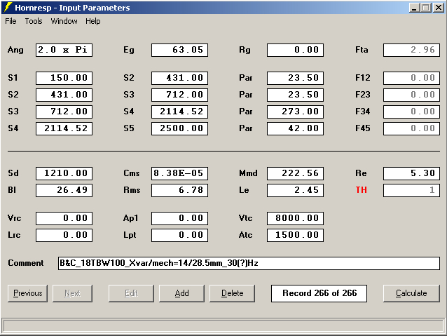

I see, you were looking @ Posts #36/#40. That was an unfinished first stab @ a true 30Hz TH, but at least there was a drawing to go with it, and not just a complete blue sky attempt. 🙂 It was more to show how big a true 30Hz TH will actually be.

Hi tb46,
Yes, those are the ones. Post #36 is the one I initially quoted. Just wanted to briefly touch on the whole Fs vs Fb in a tapped horn situation.
