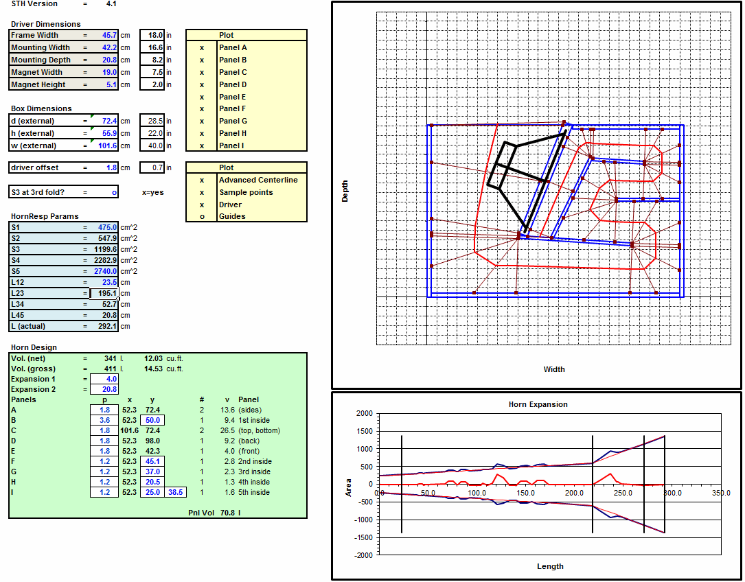

Here's a 18" TH in a cab with the same external dimensions as the TH118 (28.5x22x40 inches), using the "SS15" type fold. Problem? The impedance curve of the resulting cab suggests that Fb is too high - the path has to be just over 100cm longer for the minimum points to be a close match. I think I'm going to try to redo the spreadsheet and break the first internal panel (the one in front of the speaker) into two and see if I can insert an "adjustment" for "cone correction", or more correctly "volume" correction right in front of the driver. Once this is done, and the center panel right behind it is lengthened, this should increase the path length, but still it's not going to be an extra 100cm.
