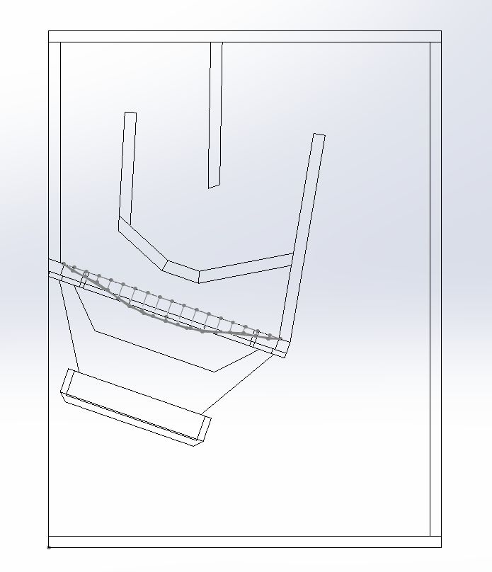

Here's what I see, and you can let me know where you think I'm wrong, because I see EASILY an extra 61 cm path length in the DSL version. (I didn't measure anything but at a glance it looks like an easy 61 cm difference.)
The red line follows the path of the DSL drawing, the purple line follows the path of your style of fold.
So in the DSL version, you already gain probably 10 - 15 inches by the time you get about 10 inches past S2, this part alone is a massive difference from your layout, I didn't mention this in the last posts because I thought it was exceedingly obvious. Then at the top middle of the box is the next huge difference (probably another 10 inch path length difference) for the same reason, because S2 goes right through the driver cone instead of taking up path length, which makes the bend at the top middle a lot longer too. The third big difference is the last corner where the stub provides a bit of mass loading, I wasn't sure how to draw that so I just made a jog in the line to add some path length which probably isn't too far off. So there's at least a couple more inches there.
Sim this as drawn and I'm pretty sure you'll find your 61 cm, if not more. So which part do you disagree with?

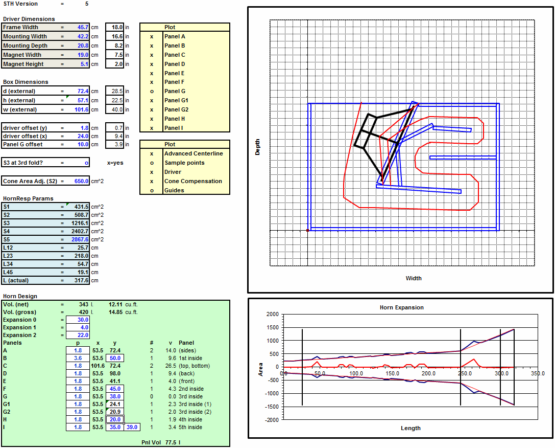

You're drawing a comparison between the DSL fold and the original SS15 fold, not the modified SS15 fold I was referring to in my last post. I need to find an additional 61cm to add on to the modified SS15 fold to match the DSL fold's ~28 Hz Fb.

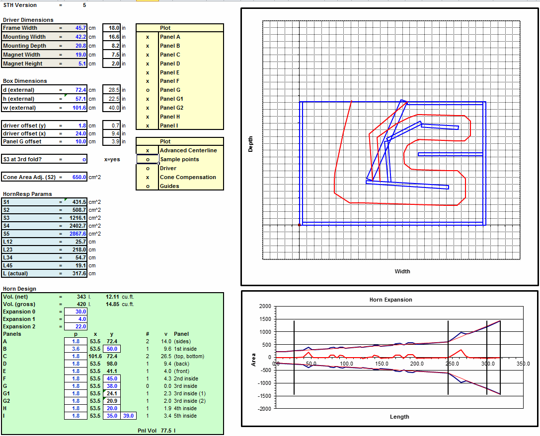

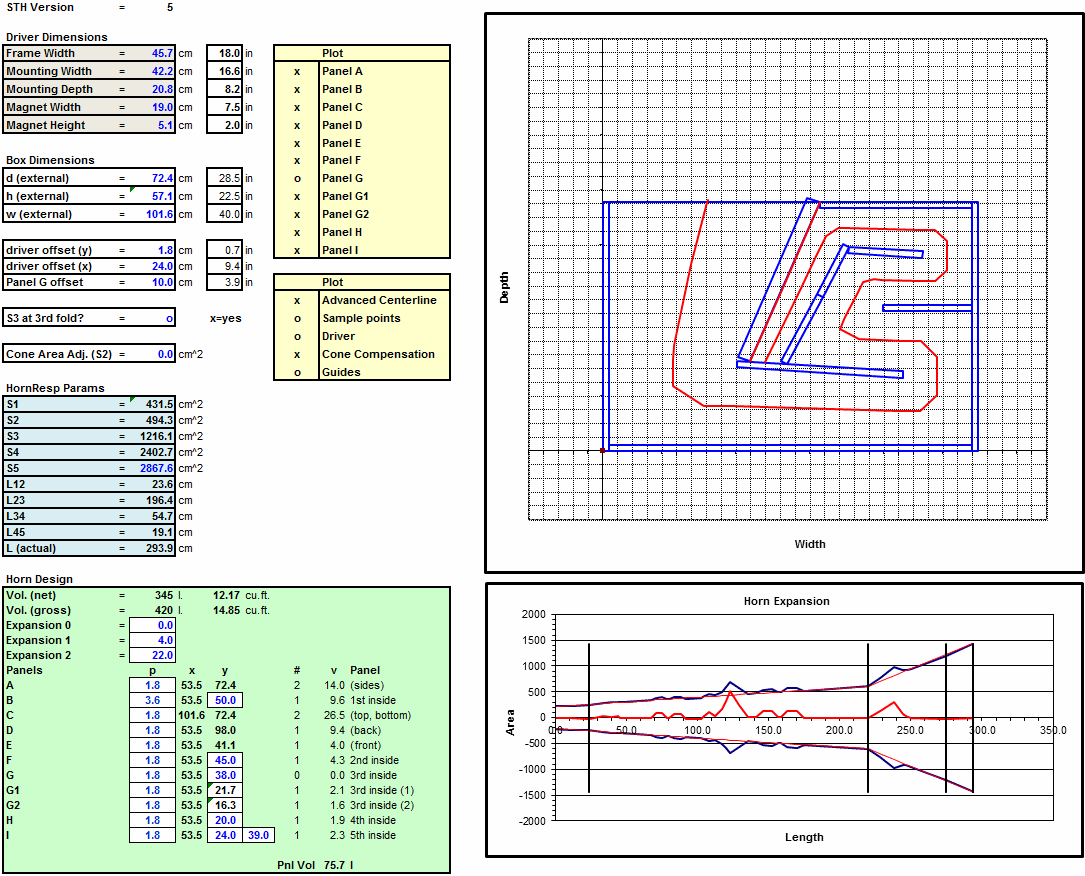

Let's do a quick worked comparison between the original SS15 fold and an approximation to the DSL fold (which actually gives a line that's slightly longer) in a box that's the same size as the TH118. See diagrams attached. The first one gives a path length of 293.9 cm and the latter gives a path length of 317.6 cm. It's an increase of 23.7cm, but that's nowhere near enough to drop Fb to 28 Hz. Another 60cm needs to be found.
Now it's possible that the spreadsheet itself I used to model this is not calculating the path length properly. It uses an iterative process with the same formula so the risk of that is low, but I will check it over again this afternoon.

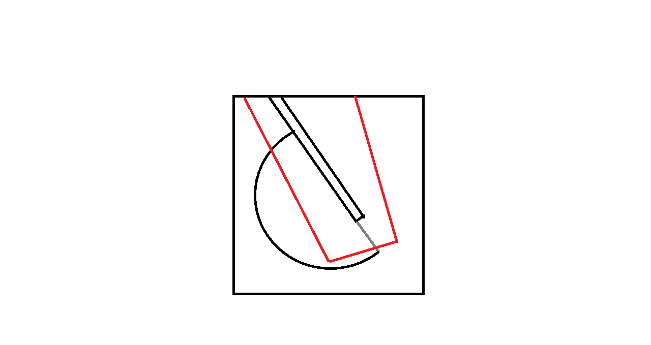

There's most of the difference right there. You didn't draw the "cone correction" section right and therefore you didn't go deep enough through the cone path and you drew the path with one bend through the cone instead of two. And you completely disregarded the mass loading stub in the last corner which adds either a bit of length or mass loading or both depending on how you want to describe it. Either way the sim doesn't care what it's called but it will make a difference.
I'm really curious though what theory you have as to why the tuning is 28 hz if the path length can't support that. I'm clearly showing it's a lot longer than you seem to think, but if you disagree how is it tuned where it is?
Also, are you simulating the cab in the plans I showed or is this just a wild guess? I'm guessing the latter since the "cone correction" and stub in the last bend in your drawing isn't even close to the DSL plans. You can't just take a wild guess at the dimensions and make pretty sizable errors and wonder why your sim doesn't match the measurements.
Your modification is a bit off because the truncated triangle isn't centered on the driver's cone (see attached diagram that shows the location of the driver), but in any case your modification may actually decrease the path length. The path length around a truncated triangle section should be less than the path length around the same triangle in its un-truncated form. In any case, the difference will be small. Remember, we're looking for 60 cm here. That's almost two feet of additional path length.
I believe the difference that it will make here is minor. Use the "enhanced centerline" method to draw the path around that stub, rather than those sharp angles. You should see any change it makes to the path length will be minor. Certainly not in region of 60 cm. Even if you use those sharp angles to define your path, the increase in path length is not going to be that significant.

None yet 🙂. I have a theory that we might be analyzing the TH118 design incorrectly however. Instead of the standard S1-S5 layout with the driver at S2, instead perhaps it should be examined as a TH with a front chamber that fires into a horn that starts at that first section after the driver. I don't think that will shift Fb, but it does relax some of the design parameters a bit.

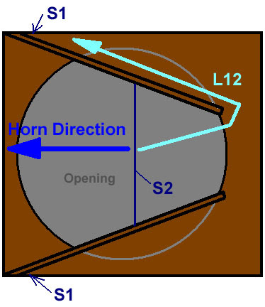

Hi Zwiller,
It is possible that L12 is longer than initially meets the eye (but I doubt it).
I remember djim talking about a folded around section in that area:
"Danley seems to use another approach. Some owners describe the Danley throats as having a "V" shape. Such "V" shape has two advantages:
1.) The "V" shape opening is closing towards the end of the driver probably to equalise the pressure.
2.) The second advantage of the "V" shape seems to be that the horn length from S1 to S2 is at least 3 times the diameter of the driver. By positioning the driver more away from S1, the pressure/loading differences between the two sides of the cone becomes smaller.
(The picture is meant as an example of the principle and is not a realistic representation of any Danley's TH's)" (end of quote)
And that is just one quote out of 100's of posts in the TH-18 Flat to 35hz! (xoc1's design) thread.

Forgot about that! Many thanks. Maybe someone here with more clout than I could mock something up and test and put it to bed. Seems simple enough to do a single fold design shootout one with a v throat and one without (and maybe even a Keystone for giggles). I also concur some of the Danley magic occurs at high power testing...
The "V-throat" approach looks like it might just do the trick (though it may also mean significantly reduced cross-sectional area at S1 and S2). I'll modify my spreadsheet tonight to consider that option to see what the calculated path length difference looks like.
