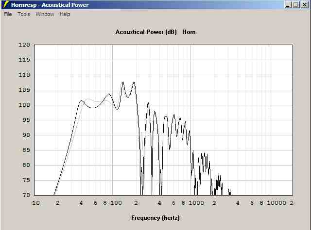

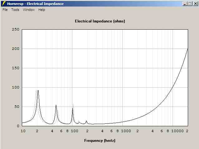

Hi Y'all,
I ran through the drawing from speakerplans, and tried to come up w/ a couple of different Hornresp simulations.
My conclusions are simple. It does not look like there is anywhere near to 61cm of additional path length v. a SS15-style enclosure w/ the driver at the same point in the box. It does not look like there is any chance, that the fb has changed from 37Hz to 28Hz through the modifications that have been suggested going from the TH-115 to the TH-118.
A more accurate analysis will require extensive work in AkAbak.
I'll attach my files.

Thanks Oliver. Did you include the effect of the increased volume between the cone and S2 in the TH118? It should be somewhat easy to come up with a reasonable estimate (flat disk of diameter ~16.5" and depth 0.75" caused by the adapter plate, plus the increase in volume as a results of the larger cone of the 18" driver).
Also, to model the effect of the adapter plate on S4 to S5, try decreasing S4 and S5 by about 100cm^2 each.

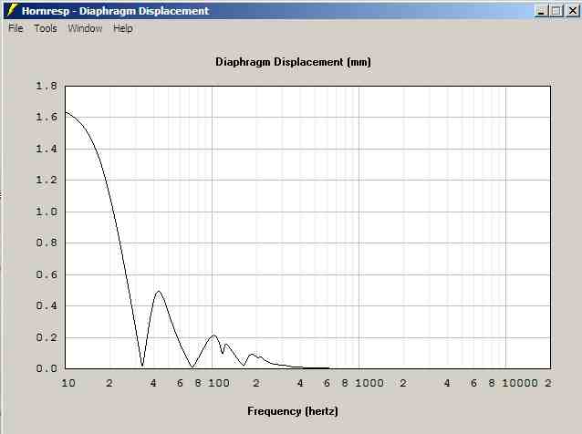

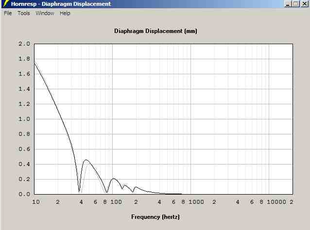

Extension of Post #68 and #70
Hi Y'all,
This is an interesting subject, isn't it?
I make no claims of accuracy, and this is only an attempt to clarify for myself, what the result of putting a large 18" driver into the drawing that was presented on speakerplans.com (see: link in Post #44) would be.
A few explanations, to the Derived TH-118 drawing:
As a driver for the drawing I used an 18TBX100, that's what I had in my drawing driver library. In the simulation I used the 18TBW100.
I did not worry about the driver/cone volume as I'm working of the cross-sectional areas. Once I know the, e.g.: cone cross-sectional area @ S2 I then divide it by the common internal enclosure width to arrive @ a length that I can use in the enclosure development (roll-out?). This is just for the drawing. For Hornresp @ S2 you have the sum of the cone, and the mounting baffle (hole) cross-sections. @ S4 you have the standard free duct cross-section minus the estimated cross-sectional displacement of the driver @ S4.
As to Exp v. Par, the horn is an exponential horn, still in some places it might be better to use PAR, but overall, and especially in the long runs that combine multiple individual horn segments, I feel Exp is more accurate. Accuracy is going to be limited more by the number of segments in Hornresp in this particular case. I have taken the attached simulation, and moved the sliders around in the Wizard to find a better "simulation", looks to me like (within reason) this is pretty much it. Changing the L34 segment to Par does not change the SPL much, and changing the L23 segment to Par does not reflect the horn flare.
As to fb, the Diaphragm Displacement shows a minimum of about 34Hz for the Derived TH-118, so that's what I'd go with. If I eyeball some centerpoint between the two lowest impedance peaks I end up w/ 29Hz. The total horn length L15 would indicate a quarter wavelength of ~27.1Hz, so the length is there.

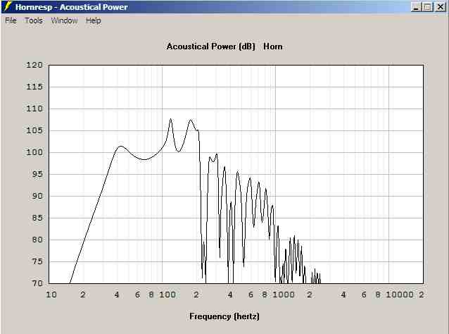

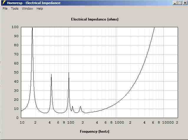

Post #75 - Derived TH-118 Simulation
Hi Y'all,
Forgot to post the simulation(s) for the Derived TH-118.
Here are two simulation, one using TH, and the other using TH1 (as shown there is a reduction of the mouth area reflecting a 1"(2.54cm) wide frame. Just play around w/ the Wizard, e.g.: w/ mouth size reductions.
I do not believe, that Hornresp simulations suit a case like this, it would be better simulated using lots of individual segments in AkAbak. Just to get around the general driver area (in the drawing from S1 to 1) takes about 5 to 7 segments (?). Still, the final result will probably not reflect the changes induced by measuring @ 10m/28.3V, nor will these types of simulations correctly predict the exact behaviour @ maximum power and excursion. I don't think that's what these programs were designed to do.
In the end I side with Tom Danley: "Measurements trump simulations."
Absolutely agree, it's pointless to sim this with Hornresp, there's way too much going on in this cab, Hornresp doesn't have nearly enough segments to even come close.
