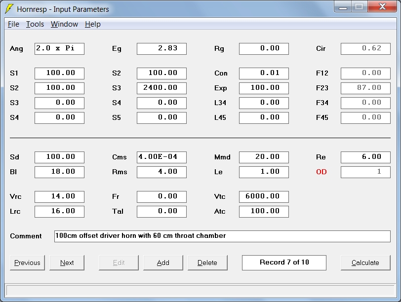

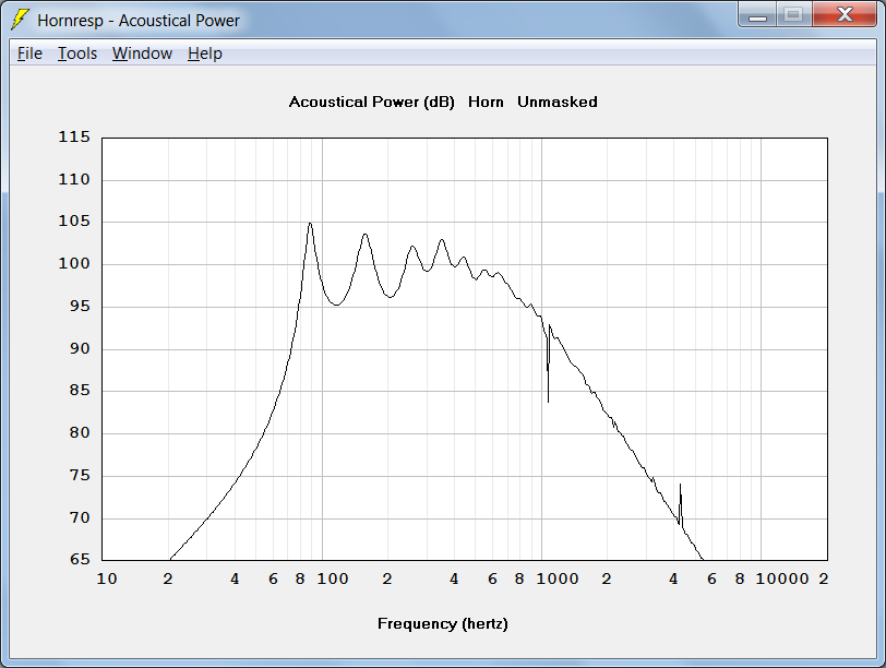

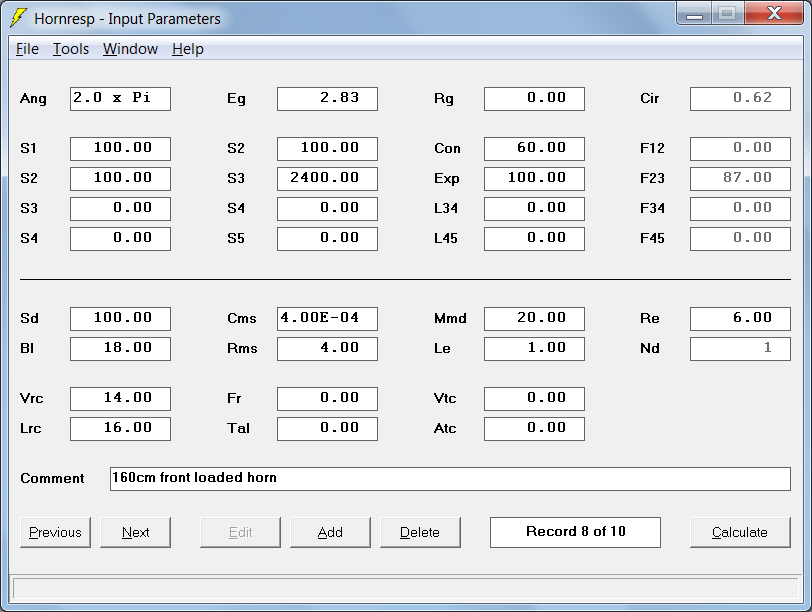

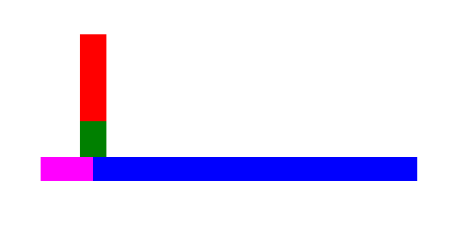

I realize that, but in an Od sim the throat chamber is beside the horn flare so it can't add length to the horn flare. Brian is trying to use it to compensate for horn flare length. A small lump of volume beside a horn flare that's too short is not the same thing as having that lump of volume as a part of the flare that contributes length to the flare.
Hi just a guy,
While the throat chamber can't contribute to the horn flare directly, because it is assumed in the simulation model to be cylindrical, it can be used to increase the effective horn length, as shown in the attached 'extreme' test examples (chosen to clearly illustrate the effect of the length of the offset driver horn throat chamber). It is also possible to use Ap1 and Lpt in an OD system to further increase the effective horn length.
The unmasked power response results for the 100cm offset driver horn (with 60cm throat chamber) are virtually identical to those for the 160cm front loaded horn, as compared in Attachment 3.
Attachment 4 is a representation of the complete acoustical path from the driver diaphragm to the offset driver horn - the red line is the throat chamber length Ltc, the green line is the port tube length Lpt, the pink line is horn segment length L12 and the blue line is horn segment length L23.
Kind regards,
David

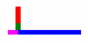

Comparing the drawings from Post #44 and the drawings from Post #33/#60 I noticed that there are quite a few discrepancies. I'm not quite shure which one to use for an AkAbak simulation, do you have a preference, or comment? Or should I combine them with an eye on longest path? For example, the little piece @ the bottom of the V above the throat is missing in 33/60.
Thanks for those posts.
  • Drawings_Post_33_60_v_44_overlay.pdf
These are just pictures I found on the internet, I have no idea who posted them, what they are based on or how accurate they may be. Your picture shows clear differences (it appears all the internal panels drawn in red except the reflector in the last corner are shifted a bit to the left) but they look fairly close, for example the overall path length appears to be the same but the csa is slightly different through most of the horn. Personally if I were interested enough to sim it at all the first thing I'd do is look for more drawings and see if I could find a definitive dimensioned drawing. If not, I'd try to contact the people that originally posted those drawings and find out where they came from and how accurate they are. The difference between those two drawings may be as simple as a scaling error when the pics were saved or something silly like that. It's hard to imagine they would be so close if one or both were just drawn freehand without knowing the actual dimensions. Failing those two options I'd run the sim both ways you've shown and see what happens. The answer is likely that one of them is correct, or if neither are correct the real dimensions are probably somewhere in between.
The biggest reason I didn't want to do the sim myself is because I didn't want to figure out the cross sectional area as the path moves through the cone. I'm not good at math and I don't envy you that task. It would take me a few hours just to plot out the first couple of feet of this horn. I'm sure there's an easy way to go about it, but I don't know what that easy way is.
