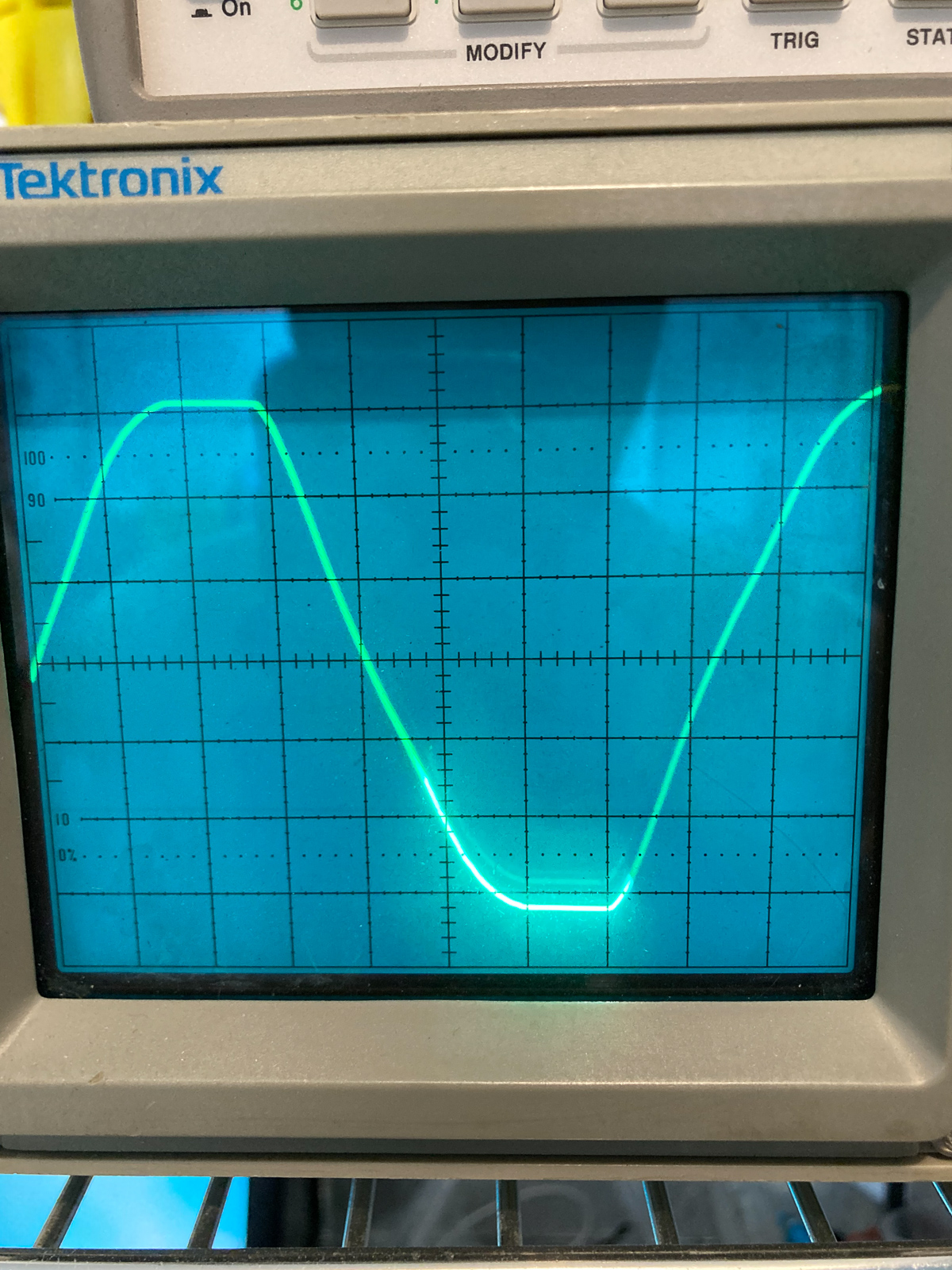

I assembled the power supply with Jan's recommended resistor changes and have the same MBR1045 heat issues as others in this thread.
I am a bit skeptical that the MBR1045 is at fault when the MBR1060 or MUR820G work fine.

I removed the 47nF capacitor and the MBR1045 was still very hot, so that does not seem to be the issue.
There were a few MUR820's in my parts bin so I put them instead of the MBR1045 and they remained cool to the touch.
I don't know what the problem is but maybe best to make a BOM change since this has been an issue for a few builders.
Edit: Is it possible they are simply underrated? Do they see twice the peak voltage or is it different in this configuration? 18V*1.414*2 = ~50V, and the MBR1045 is rated at 45V.
Tested the PSU again tonight. The transformer has 115V primaries while my mains are around 123V, resulting in 23VAC secondaries when lightly loaded.
I hooked up the scope, and with 10V/div, there is just over 60V across the diode.
I'm still learning... does that entire 60V cycle apply to the Vrrm rating of 45V, or just part of it?
The MBR1060 is rated at 60V (maybe that's why it did a bit better), the MUR820 at 200V and the FES8GT-E3/45 at 400V, so I think any of the latter two would be preferable.

Parts should be applied with "margin" with respect to most of their parameters. A diode rectifier for example, should be specified to be used at no more than 70% of its rating for what would be called an "Enterprise" class products. "Consumer" class products might go with a 90% de-rating. As a DIYer you get to decide what your reliability goals are. If you are good with "Are you feeling lucky today, punk?" reliability, go ahead and use parts at their full rating. In this case, the diode is being stressed to the full voltage shown in the scope shot.
