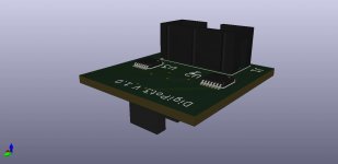

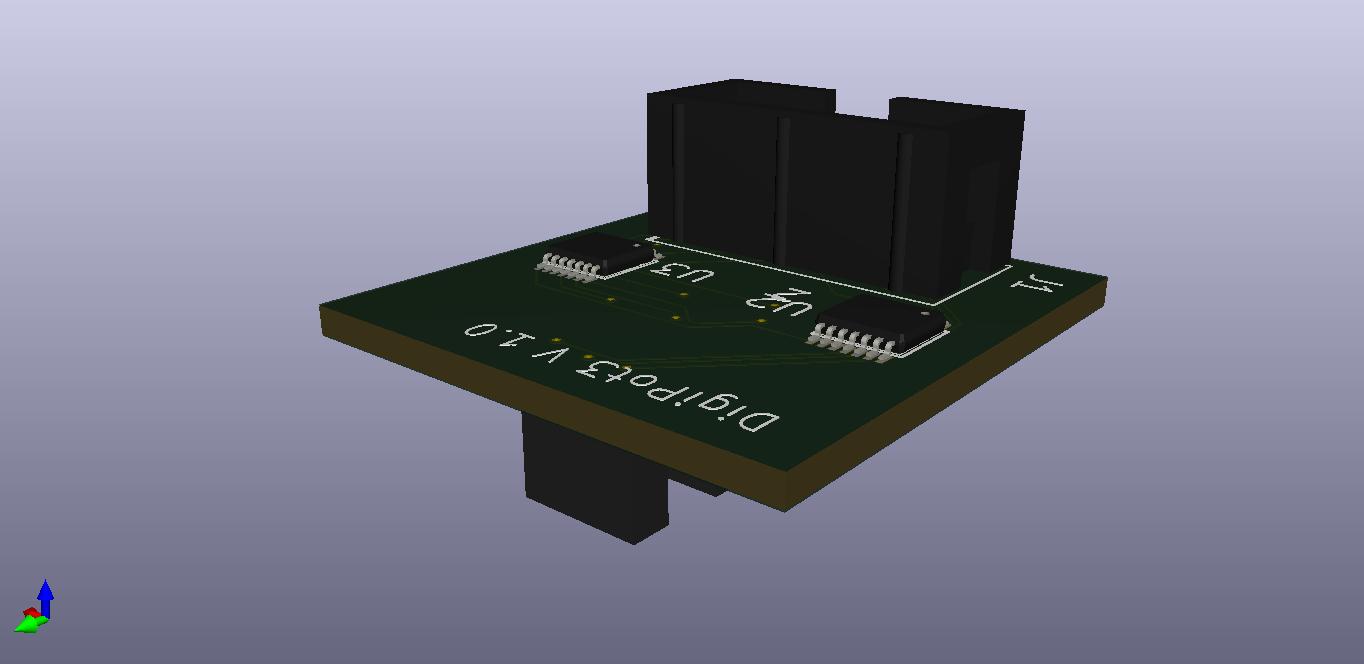

A while back, I put together a piggy-back board to directly replace the manual volume pot on my Self 2012 pre-amp which also implements the Baxandall volume control . It uses two MCP45HV51-502E/ST devices (I2C version of the digital potentiometer), one for each channel and was controlled by a home-brew ATMega16 microcontroller board (similar to an Arduino but running native C code). An Arduino or anything similar would do the controller job quite happily.
I never got to implement this on my existing preamp as other projects came along instead but if it's of any use to anyone, here it is.
  • digipot3.pdf
    digipot3.pdf

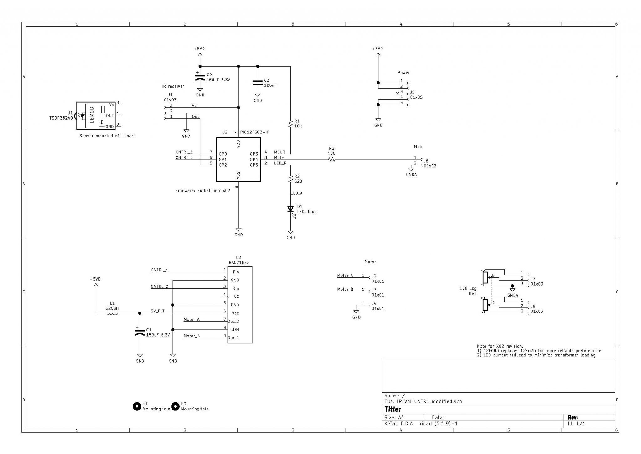

Yes, I too am interested in the generic question: how does one integrate a motor-pot with this preamp, for volume control?
My plan was to use a simple Arduino Nano processor. An infra-red receiver reads from a standard hand-held remote control and spins the motor thru a simple bridge circuit. I had planned to build the whole thing on the back of a PCB that has a display showing volume level relative to zero. Overall pretty simple.
If you used the 5K linear motorized pot Carl previously identified, you then need some way to drive it. A simple micro to decode the IR signals and a driver chip. The attached schematic shows such a circuit. Then all you need is the firmware. The code I used as a starting point was from
