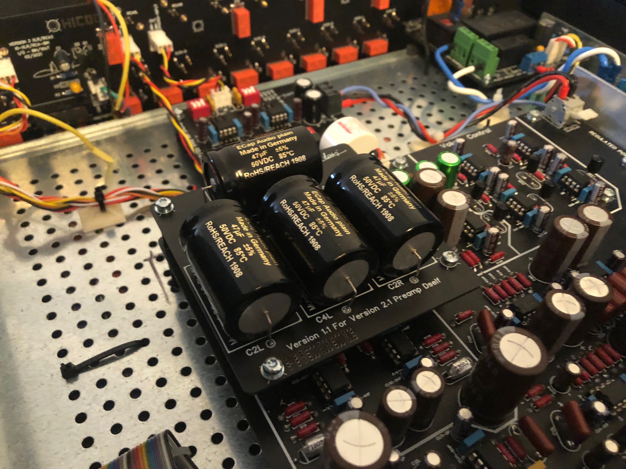

I don't have the article in front of me so I won't speculate, except that in general you'd use coupling caps to keep DC from upsetting stages and/or the output.
BTW As explained by Doug in Small Signal Audio Design it is the signal voltage level across the electrolytic that determines its distortion. That is not related to the DC it is blocking.
If the signal voltage across the electrolytic is less than about 80mVrms its distortion can be ignored. So you size the cap value so that it has less than 80mV across at highest expected signal level at the worst case frequency (normally the lowest reproduced frequency).
Jan
Thank you everybody for suggestions. I have some Panasonic caps so I might as well try those. And if I can hear the difference I'll replace them with Nichicons when they become available. I'd very much like to get this preamp running, parts and boards have been sitting for a good while now.

What exactly are VR1/VR2 on the power supply board? My schematic and BOM does not appear to have them, but the board does.
I subjectly find this pre sounds bad when populated with 100% of ES bipolar caps but I do hear difference between caps and admit that what I hear at the end is not the pre alone but all the hifi chain through my loudspeakers at the end.
Can you please connect this preamplifier to a recording device, or to the line-in on your computer, and record the audio output with the different capacitors? This could make for an easy A/B comparison.

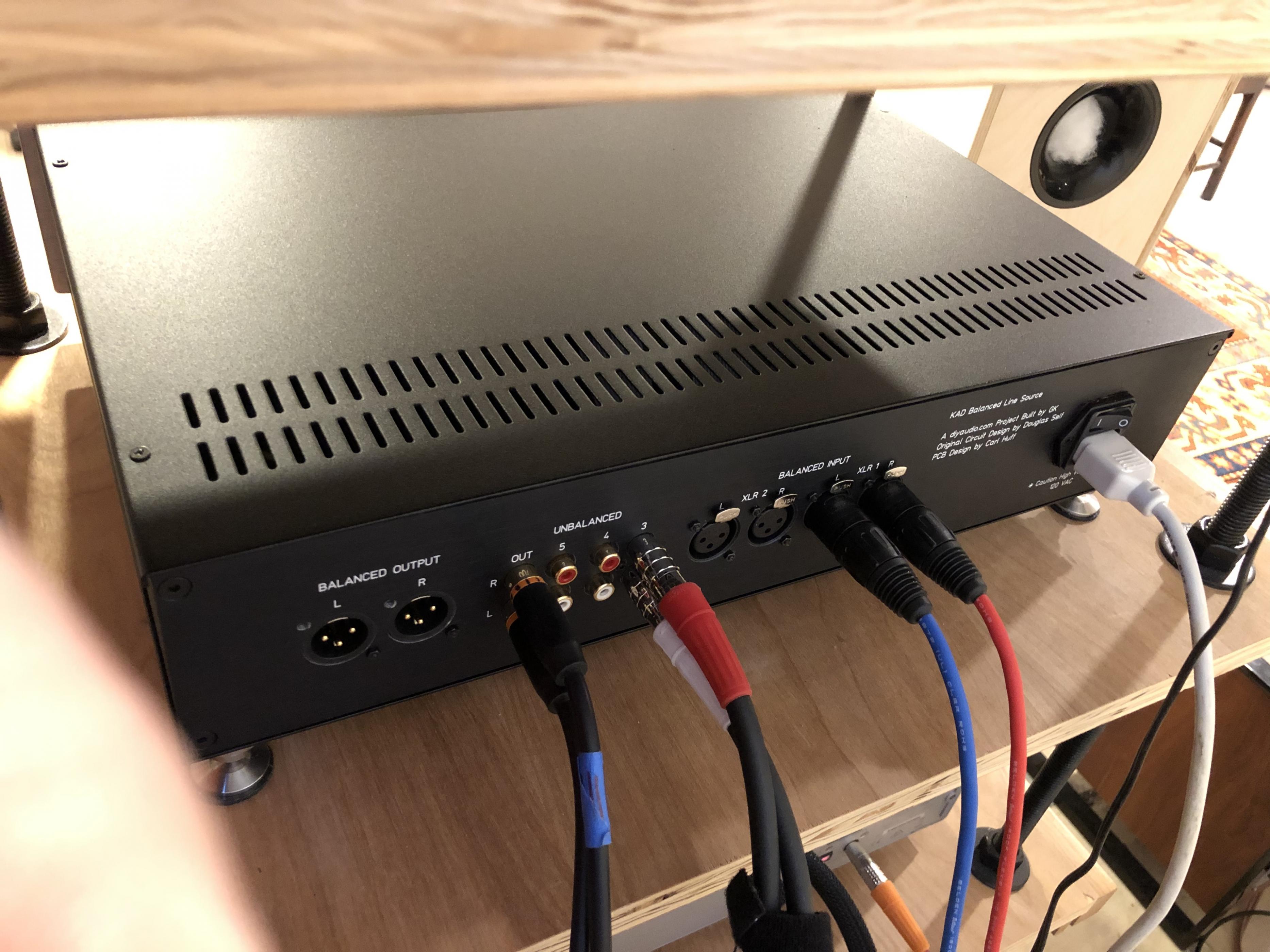

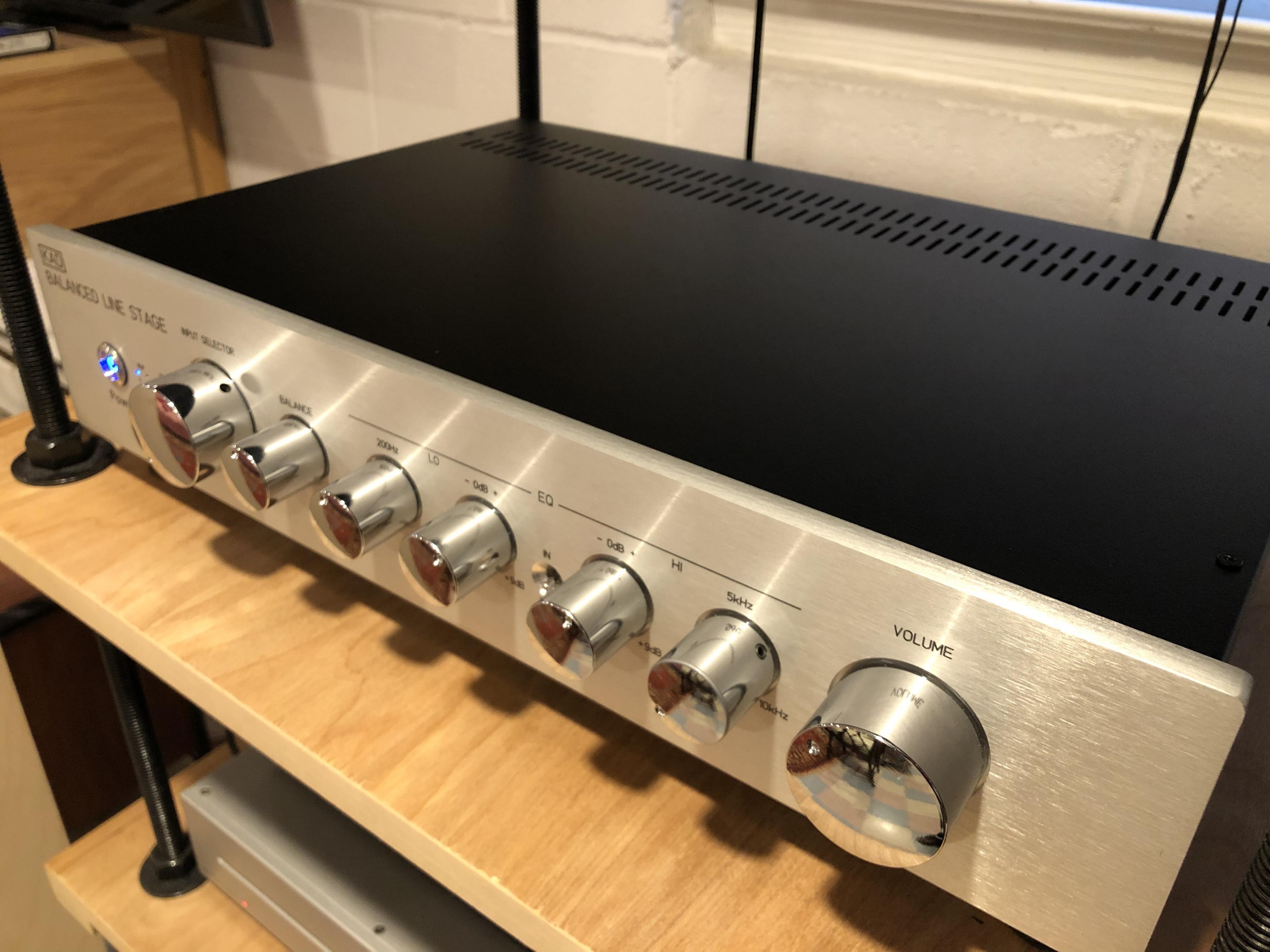

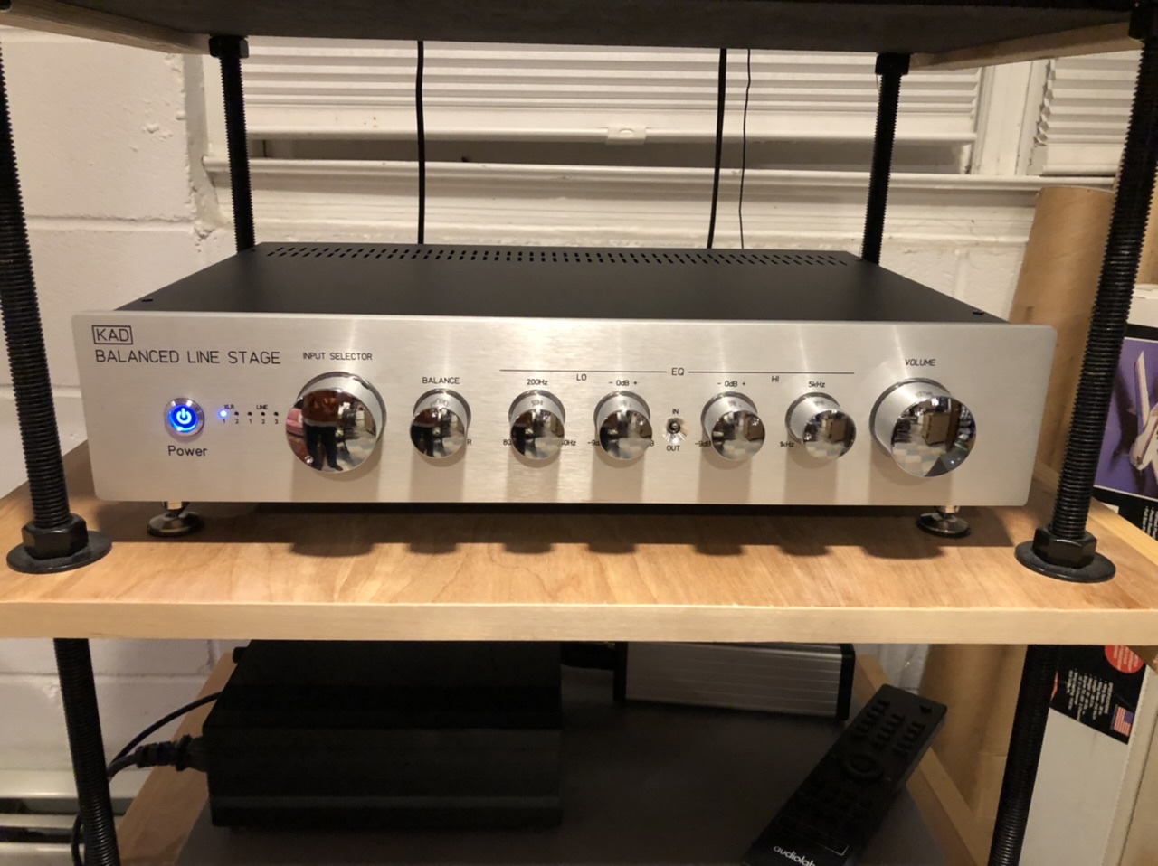

Finished!
Hi Carl - I finally finished my build! I have been listening to it for a couple of days, and I am very pleased with the result. It just sounds great.
I ended up using Elna SILMIC II polar caps after encountering the backorder blues on the non-polar caps. Other than that, it’s a straight forward build. The case is a 2U Slimline with custom machining and lettering by the Modushop. I took most of the elements from your design and coaxed them into a slightly different configuration.
Thanks to you and Doug for this great project!

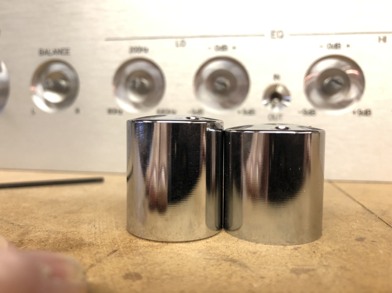

Are those stainless steel knobs? They seem to have a mirror finish. And what kind of switch did you use for the tone defeat?
Reactions: glenv6
Gorgeous.

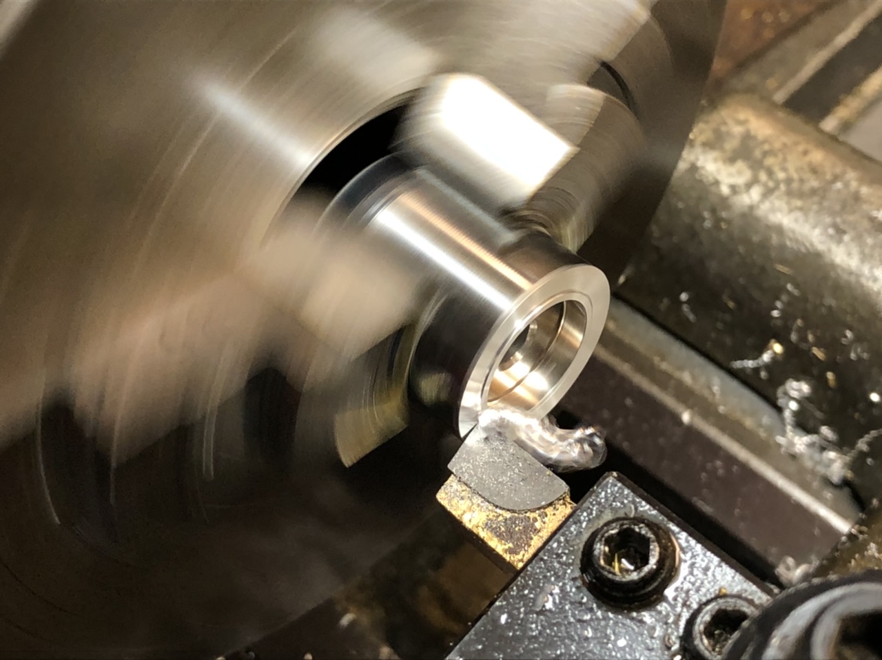

Thank you!…. Those are the knobs from the diyaudio store. I cut them down 2mm in depth to recess them more nicely into the panel. The switch is the once Carl specified in the BOM, the C&K Components 7201MD9AV2BE available from Mouser.
