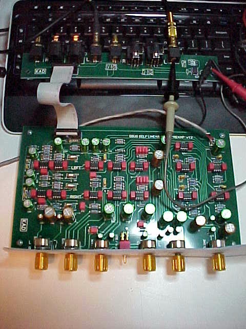

The IO PCB measures 260mm wide and 38mm deep.
Note the addition of RCA phono connectors and delay ON circuit that was not in the published article. The IO was purposely separated from the main PCB so as to allow users freedom choosing a chassis for the project and to allow the further development of IO greater than the single pair shown here.

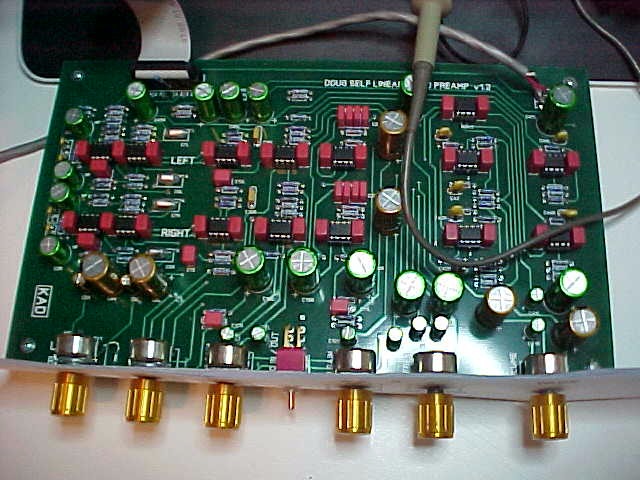

The main PCB measures 260mm wide and 155mm deep.

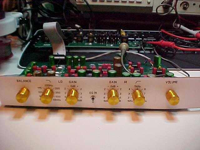

Here is a PIC of what I propose to be the front panel layout. The 'gold colored' circles are 15mm diameter control knobs.
Note the centrally located toggle switch that when operated to the down position bypasses the tone controls.
