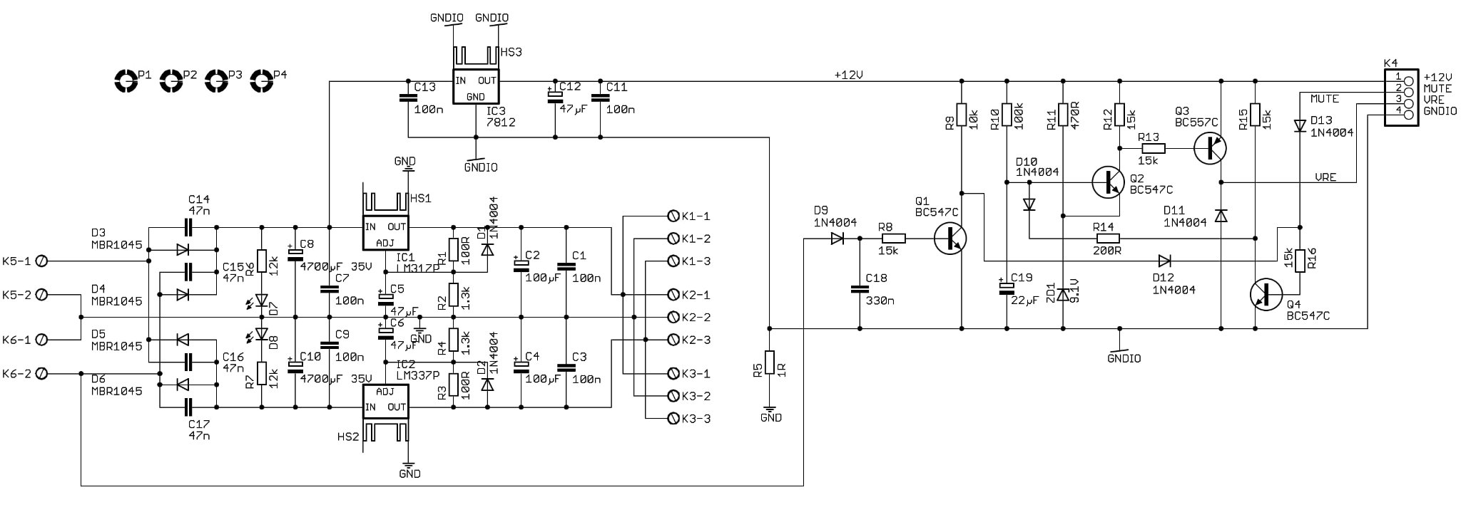

A continuation, the original turn on delay can be replace with the attached one. This one is triggered by mains....
