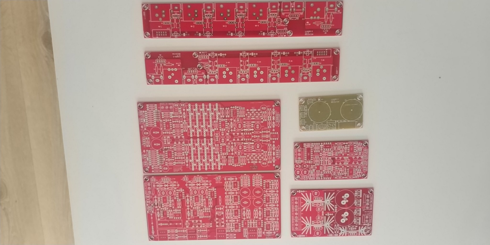

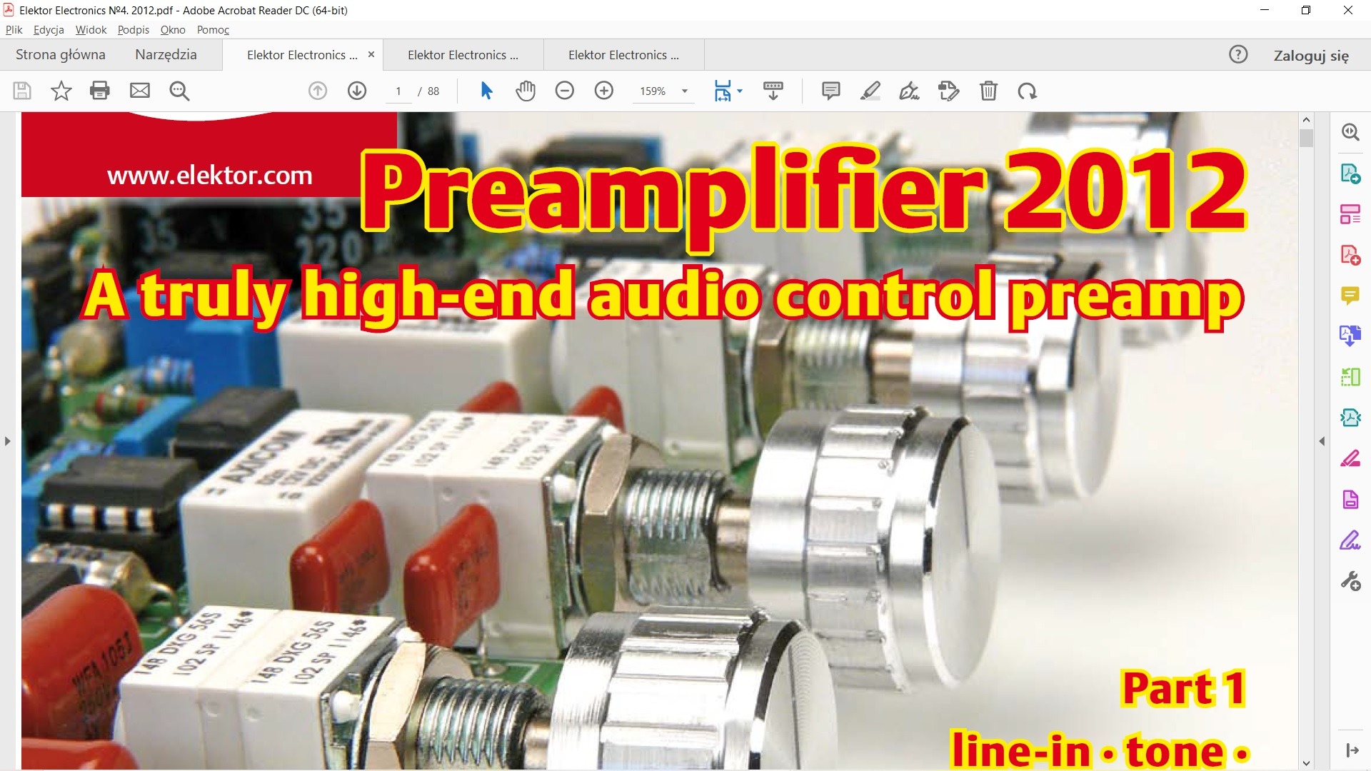

Hi wolframIf I can put in here, I have three sets of PCBs left to sell to Douglas Self pre from elektor 4,5,6/2012.
I am sending a PDF this elektor for viewing by e-mail.
Cost 50$ + shipping
View attachment 1163038View attachment 1163039
Please send me in PM how you want to procédé to ship me one set
Regards
Georges
Hi CarlJust a quick point of clarification for those who have recently joined this thread or haven't really been paying attention.
This thread is NOT about Doug Self's 2012 preamp published in Elektor magazine, rather this thread is all about the Doug Self circuit fragments published in Linear Audio #5 in 2013. A couple of years later I strung together Doug's ideas into the project that this thread is about.
Once again I want to thank both Jan Didden and Doug Self for all of their help and support during the long run of this thread.

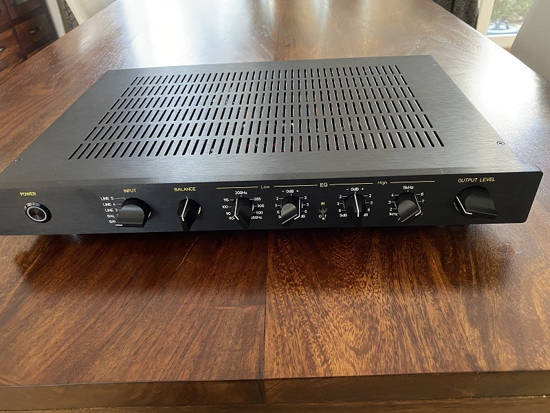

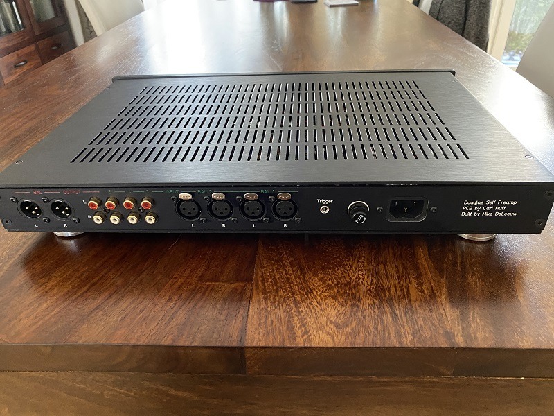

Just thought I would share some photos of my now (finally!) completed preamp. In a 1U Hifi2000 chassis with engraved front and rear panels by Schaeffler. Super quality. It took some time to get it all together, and along the way I did make a few changes:
Some adjustments were made to the fpd file I downloaded. The XLR input layout was not quite right, and I went back and measured actuals on the center spacing. I have an updated file which works very well if anyone is interested. And yes - be patient and seat the connectors in the rear panel prior to full soldering makes life much easier. I learned the hard way.
For the front I wanted a 10mm panel so I had to counterbore for the pot bushings. I used the counterbores to recess the knobs. Biggest issue there was managing tolerances but it all worked out. I also swapped the In/Out switch for one with a longer barrel and tweaked the leads a bit to get body of the switch right up to the back of the panel. This avoided a countersink on the front and makes for a cleaner look IMO. I need to go back and put a bit of black paint inside the cbores to cut the sliver of glare.
Anyway a very interesting project and thanks for all the support from the forum, Carl, and Doug Self!

Amazing look ! I love it. Please can you give the caracteristics of the case you used ? What brand and size please.
Thanks a lot
Georges
Beautiful job Georges!
Your build is among the best looking that I have seen. It looks like a commercial product. Congratulations!

very amazing look,
Can you also share photos of the inside?
