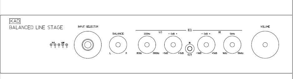

Here is a rear panel layout for a 1U case. I cannot remember who sent it to me, so thank you whoever you are.

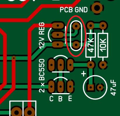

I think (?) I have the latest version of Carl's IO board (has the signal diodes on top, just below the relays).
I am consistently getting 14.8 V downstream from the 12V regulator (17V at the input), and just a bit over 15V across the 1N4148.
It seems like the regulator is damaged, but is there anything else to consider before changing it?

Hi Johnny - there was some discussion about the 78L12 possibly being unstable without caps on the input and output side - starting around post #1058, here:
https://www.diyaudio.com/forums/ana...-preamp-linear-audio-5-a-106.html#post5490511
There are some recommendations in the following threads about adding caps, and values to use. I think put the caps from the App note (TI?) on the underside of the board.

Thanks fvzeppelin, that's a good idea and easier to find something close to TI's indicated capacitance.Soldering a small tht tantalum on the bottom side is as easy.
Thanks Carl, my board doesn't have space for a decoupling cap so I guess not quite the latest version.PLEASE NOTE: The latest IO PCBs have a place for a decoupling capacitor. It is circled in red immediately behind the 12 volt regulator.

Just an update - 10uF across the output and 0.1uF across the input and the reg is stable at 11.8 V (happened to have some SMD pieces in my parts box).
Thanks to all for pointing me in the right direction.

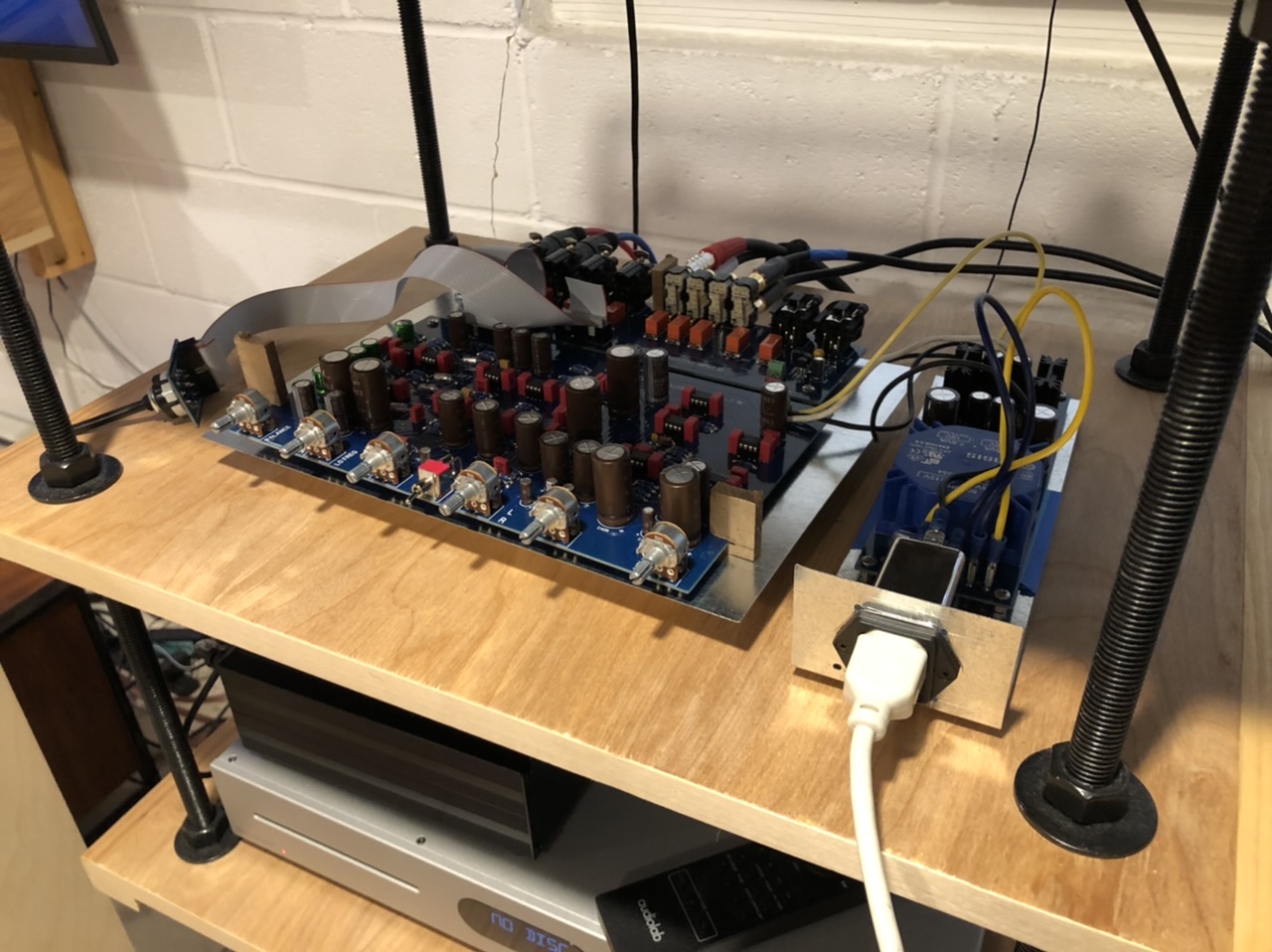

Thanks again Carl for your designs. I modified your 1U design to better fit a 2U case (just my preference), but before I order a case, I decided to spend some quality time listening to it.
I really like this preamp! As I said in a previous post, this thing is quiet. And it sounds very good - the soundstage is the best of my three preamps. The other two are a vintage NAD 1600 I bought brand new decades ago, and the Wayne Coburn 2018 I built last year. The NAD is warm, transparent, and a little on the restrained side. The WC2018 is clear, clean and spectacularly detailed. This DS/CH preamp is somewhere between those two, but the soundstage really sets it apart. Instruments and vocals are suspended in specific separate locations across a wide stage. Music is well, musical and enjoyable. I have listened for hours without the magic of that soundstage wearing off.
So, I will be ordering a case and boxing this thing up ASAP. It will probably spend more time in my rack than the other two.
