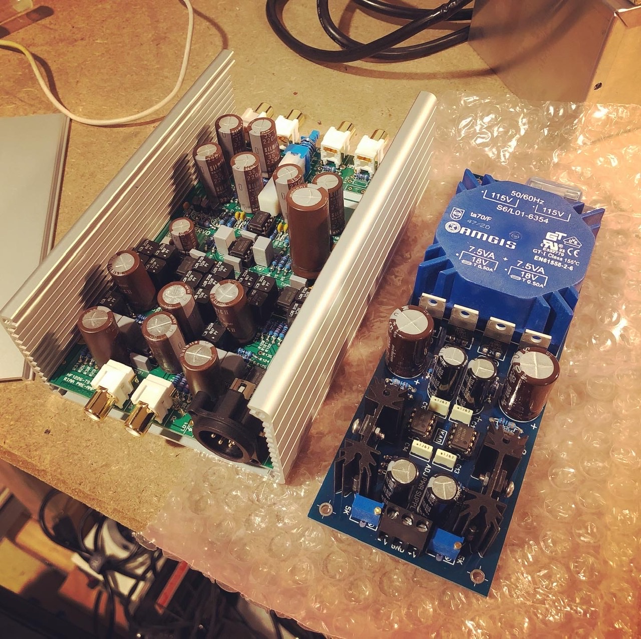

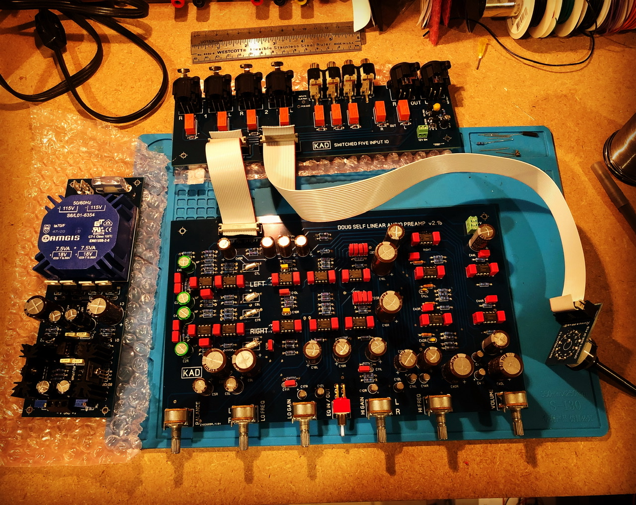

It works! Thanks to everyone on this thread, especially Carl and Doug, I have arrived at the point in my build where this thing actually plays music.
First impression is that this is one quiet preamp. And does it sound good! My first listening test was far from ideal, but I did prove that, a. It works, and b. It didn’t blowup or burn down the house - two good signs in any build.
The images show the boards completed and connected to each other; the preamp connected to a test setup on my bench; lastly, I thought I would show off the Douglas Self/Signal Transfer Co. phono preamp I built at the same time. I used one of Carl’s PSUs to power it.
Next step is to box it up. I’m debating 1U or 2U, deciding knob choices, and planning how I want my silkscreens laid out front and back.
