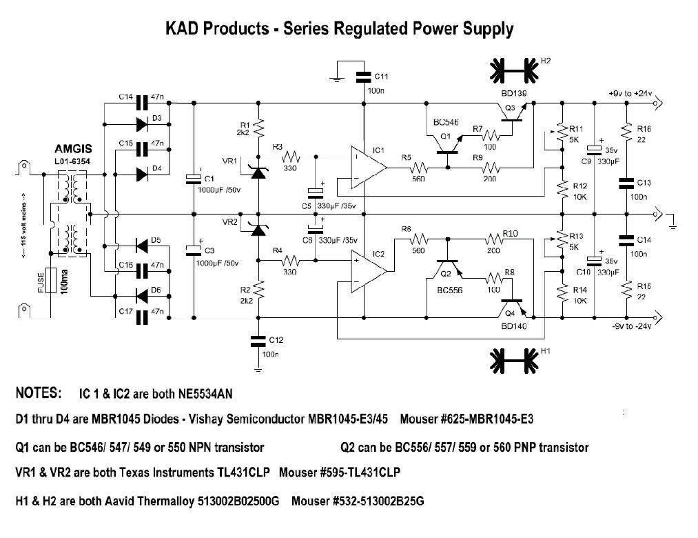

The BD139 and BD140 devices that are available from distributors are BD139G, BD13910S, etc. Does this matter in the power supply circuit?
Do we have a few named substitutes for the discontinued BC560C in the power supply? The NPN complement, the 550C, seems easier to buy than it's mate the 560C.
I've had trouble finding genuine BC560C. Digi and Mouser are out.
In the case of the TL431CLP (VR1 and VR2 positions of the power supply), the TL431BCLP is more plentiful from Mouser. Any hazard if I use these 0.5% versions instead of the 2% version?
I find it amazing how low vendor parts stocks are these days. I never expected to see them get this low.
BC556/ 557/ or 559 can substituted for the BC560 called out in the drawing.
And since the voltage is adjustable using a pot, substituting the described TL431CLP should not be a problem.
I wouldn't use this power supply. A good voltage regulator is more economical and also has less noise and better ripple rejection.
