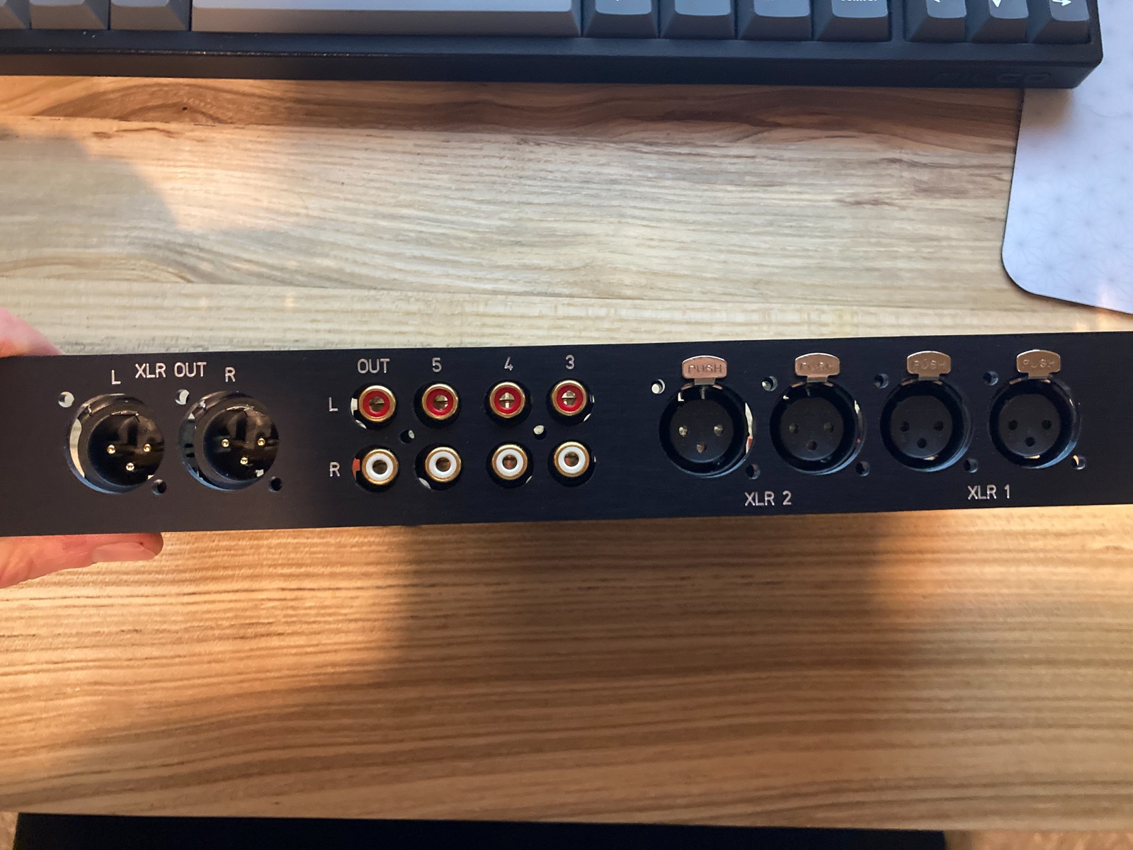

I ordered a rear panel from this FPD and unfortunately it has a few inaccuracies that are sufficient for the IO board not to fit.
Front Panel Express are extremely accurate, has anyone else had an issue with this file?

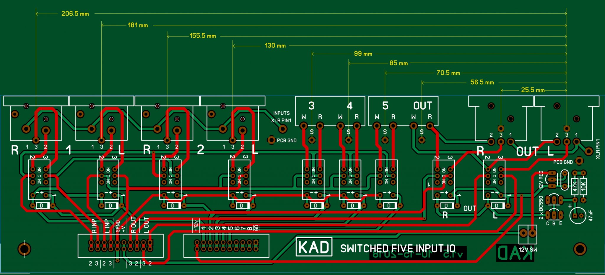

Carl, does your PCB software allow to export the PCB as DXF? I've used that method in the past to make perfectly aligned layouts.
If not, would it be possible to provide the exact distances of the XLR and RCA sockets from the PCB layout itself ?

Thanks Carl, that diagram is exactly what I need.
If it wouldn't be too much effort to do the same for the front PCB, that would be great.
Unfortunately I have already soldered the IO board, but hopefully with these more accurate measurements it will be a perfect fit

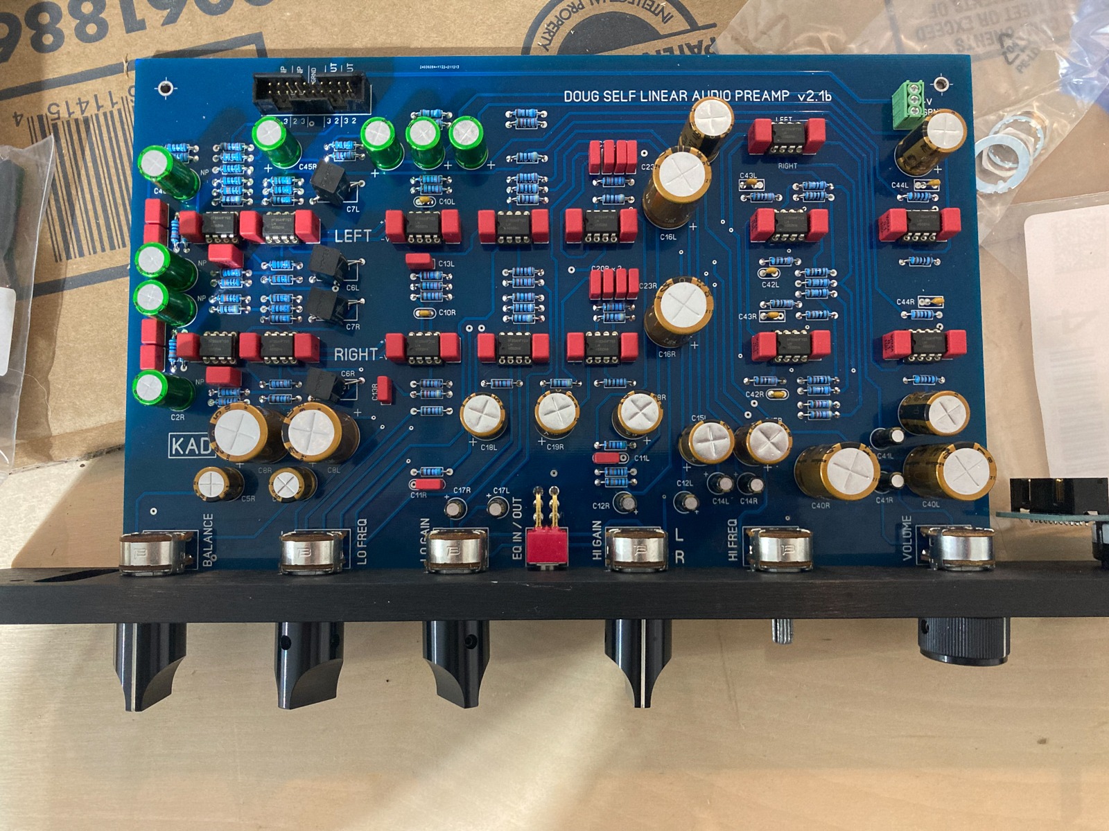

9DCB2683-1B59-453B-AD21-84A6E6D23EF7.jpeg I used that file, but I adapted it to a 2U chassis. I verified placement of all the parts using measurements of Carl’s I found somewhere in this thread, and I measured my finished board, which I had to do anyway to fit the 2U back. I don’t recall making any changes to the component spacing, but it’s possible that I did.

Sure, I can do the same for the front panel
That would be helpful, just as an additional sanity check.

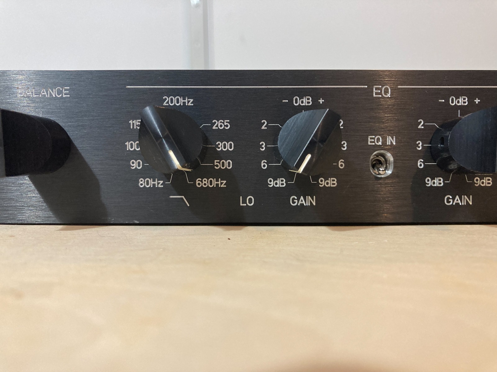

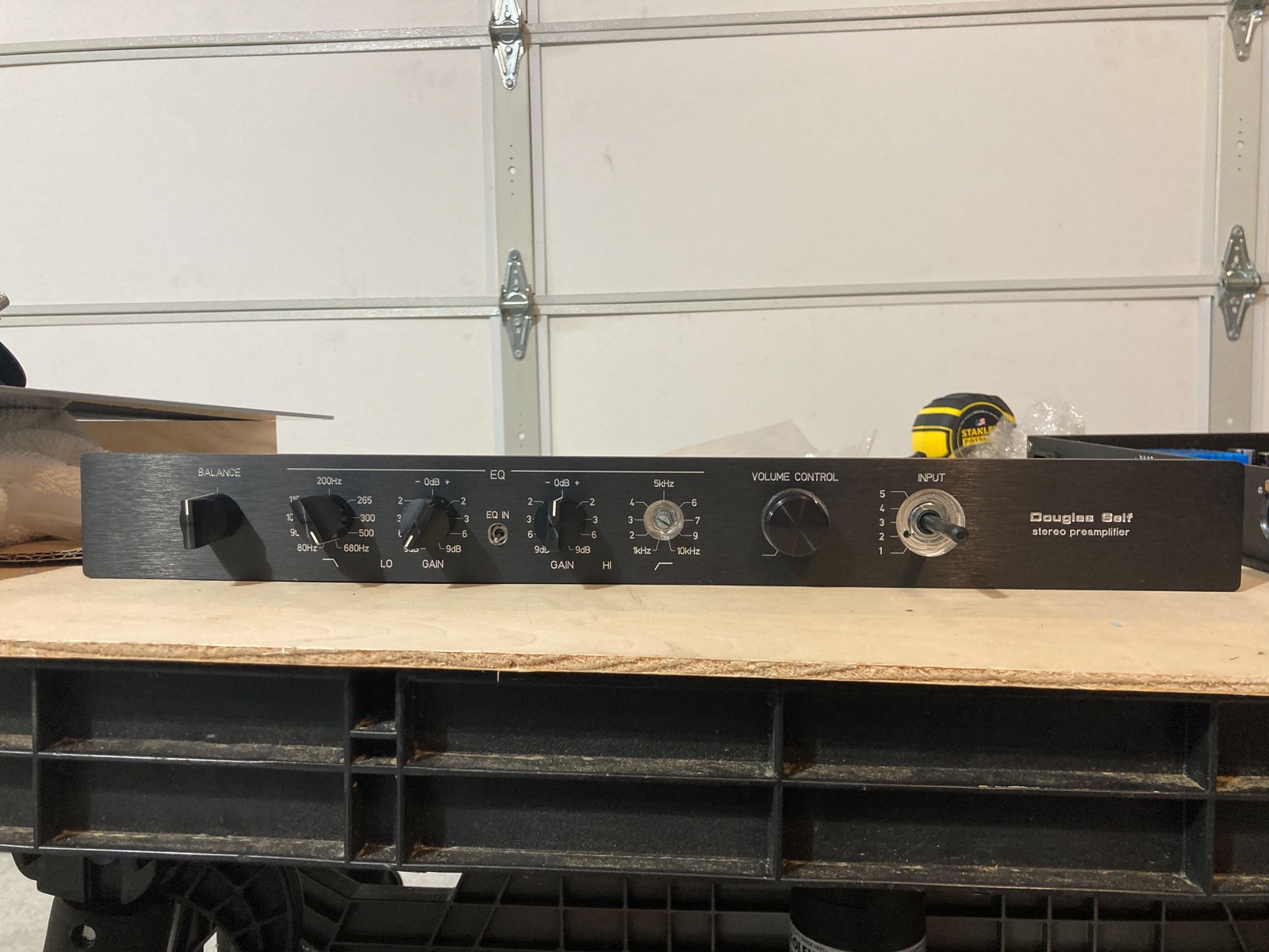

I made a few changes to the front panel templates, they look great but I overlooked a few details and they have a 2 minor issues:
1) I didn't account for the pot range correctly, so the knob marker doesn't align properly to the markers on the extremes.
2) The cutout intended for the volume knob is slightly off-center so I can't use the pot I originally planned on using.
Unfortunately I am a perfectionist when it comes to the panels and I will re-order a new one.
If someone has a blank Slimline 1U panel, and doesn't mind these minor issues, I'd be happy to swap and you could save quite a bit.
Otherwise it will likely get recycled some time soon.
