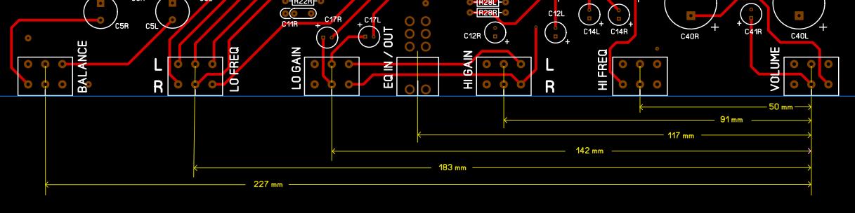

* I received the rear panel based off of the scaled PCB in post #1953 and it is a perfect fit. I will upload all of my files when I am finished with the project (updated BOM, front and rear panels). The 230mm depth Slimline 1U is a perfect fit.

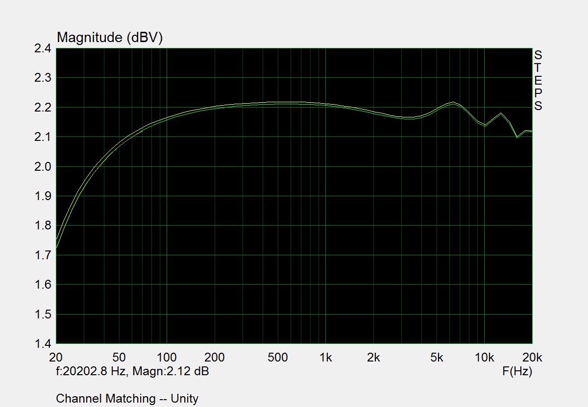

* Balance and channel matching -- I used Bourns center detent pots (PDB182-K220K-502B) in all positions except volume. At the center detent, the channel matching is off by 0.5dB (at Unity gain). As such, I figured its better to use the Alpha pots without the detent and screw center the knob where the channel matching is optimal. At unity gain (and less even), channel matching is better than 0.1dB. (graph attached)

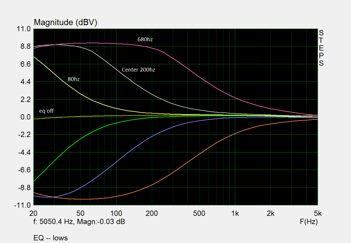

* EQ measurements -- I measured the EQ with gain set to max (-/+ ~9dB), and the frequency at the pot extremes and center detent (80hz, 200hz, 680hz).
With the knob at the center (200hz), 9dB gain occurs up to around 50Hz, whereas there is ~3dB at 200hz.
At the 680hz mark, 9dB gain is up to around 200hz, whereas again it is around +3dB at 680hz.
Given that, I could use some assistance in understanding whether this is expected, or the front panel markers should be updated to more accurately represent where the EQ is happening

I re-read the original article and have a slightly better understanding of the tone controls, although where the actual EQ happens with regards to the selected frequency is still a bit confusing.

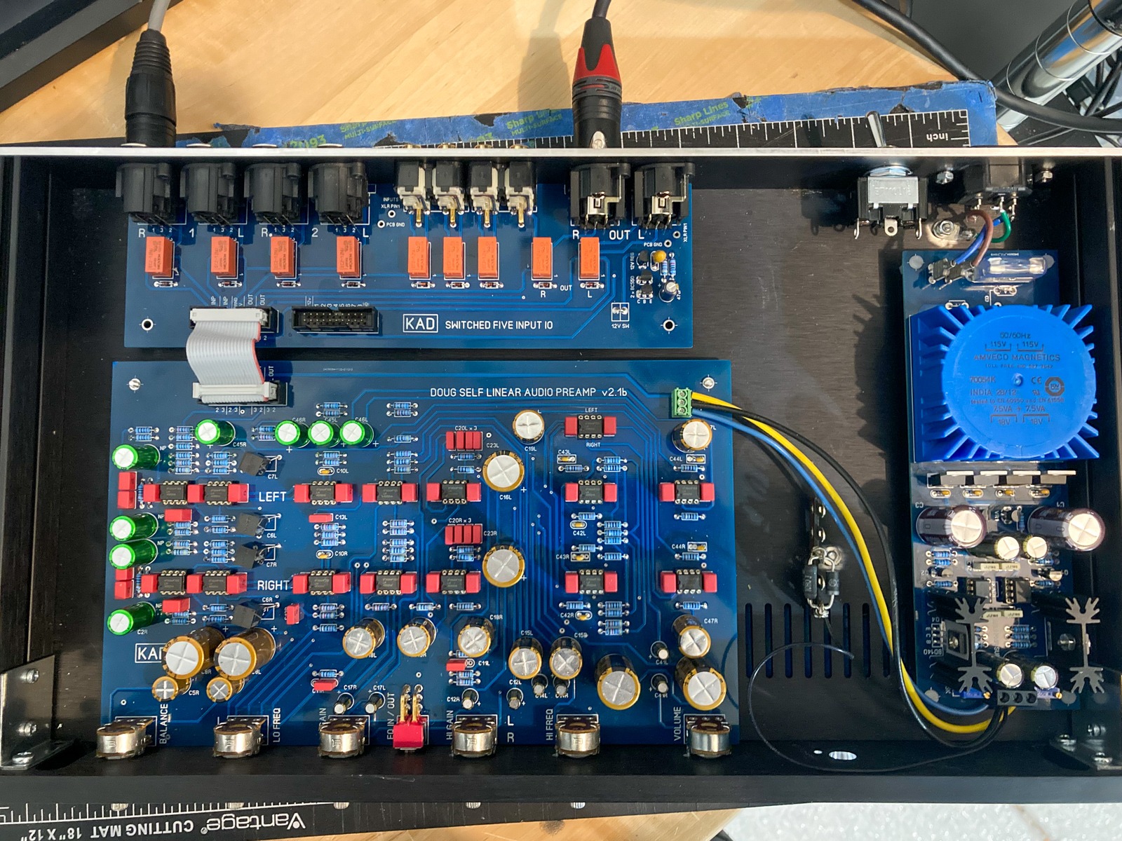

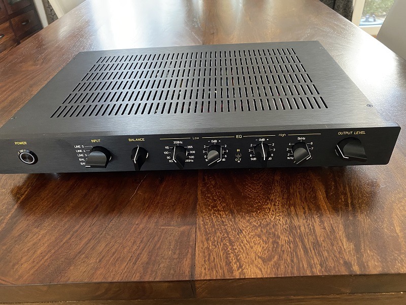

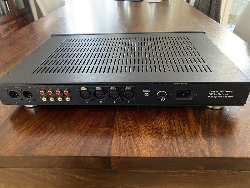

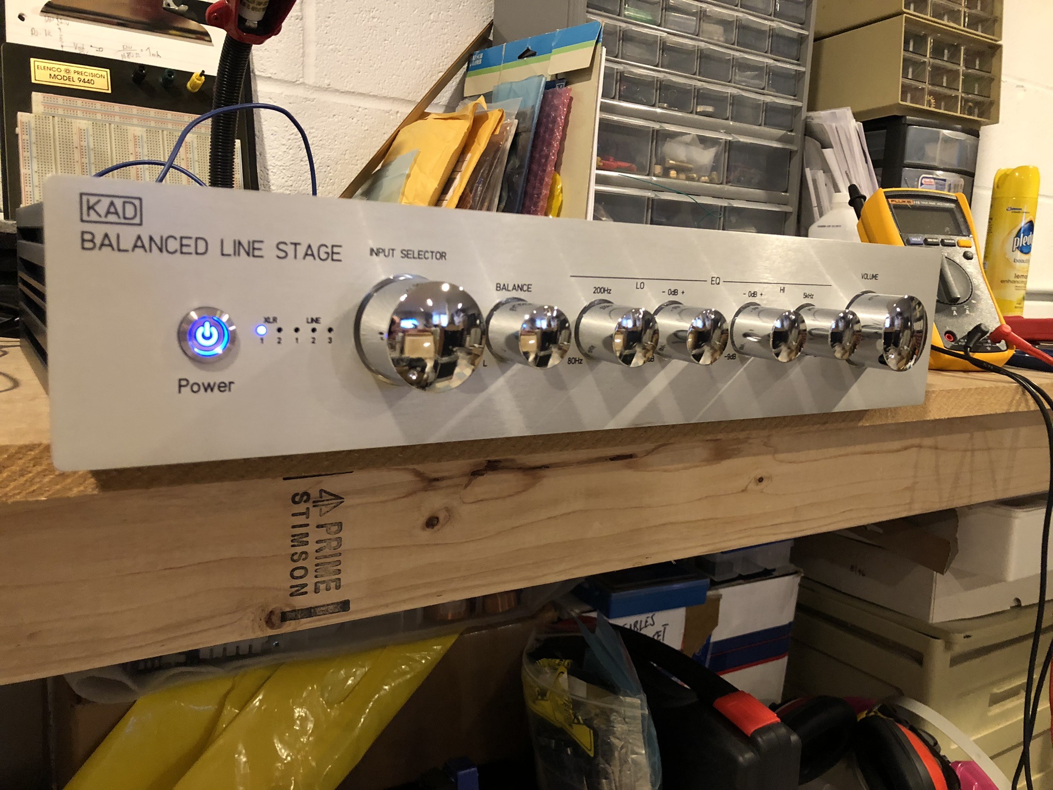

Hello All,
Just thought I would share some photos of my now (finally!) completed preamp. In a 1U Hifi2000 chassis with engraved front and rear panels by Schaeffler. Super quality. It took some time to get it all together, and along the way I did make a few changes:
Some adjustments were made to the fpd file I downloaded. The XLR input layout was not quite right, and I went back and measured actuals on the center spacing. I have an updated file which works very well if anyone is interested. And yes - be patient and seat the connectors in the rear panel prior to full soldering makes life much easier. I learned the hard way.
For the front I wanted a 10mm panel so I had to counterbore for the pot bushings. I used the counterbores to recess the knobs. Biggest issue there was managing tolerances but it all worked out. I also swapped the In/Out switch for one with a longer barrel and tweaked the leads a bit to get body of the switch right up to the back of the panel. This avoided a countersink on the front and makes for a cleaner look IMO. I need to go back and put a bit of black paint inside the cbores to cut the sliver of glare.
Anyway a very interesting project and thanks for all the support from the forum, Carl, and Doug Self!
Best,
Mike

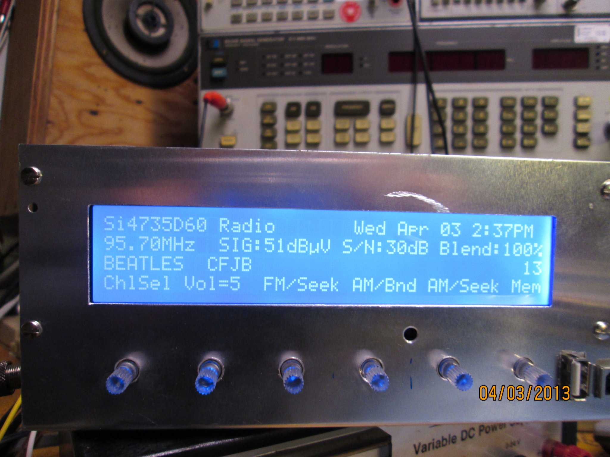

I built a complete radio media player a few years ago. Running on a Atmel xmega, it has a 4x40 character display, Bourns Encoders with LEDs, USB CODEC, etc. I stopped dev at getting the remote IR to work, built a home made remote using a ATtiny2313? its been a while. Mom likes the radio with FM RDBS song name being displayed.
That was enough coding for me 🙂 Do you want to take it over? 🙂 and/or use any of it. Its written in BASCOM-AVR.

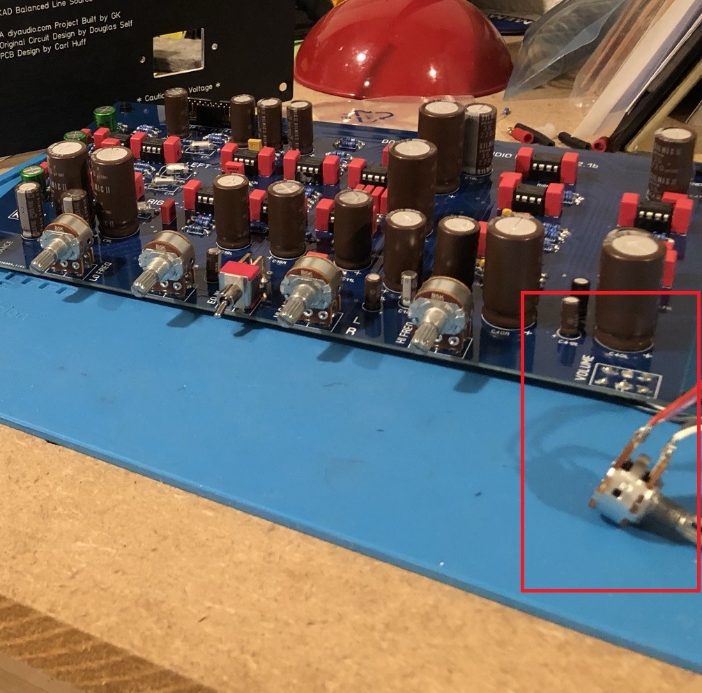

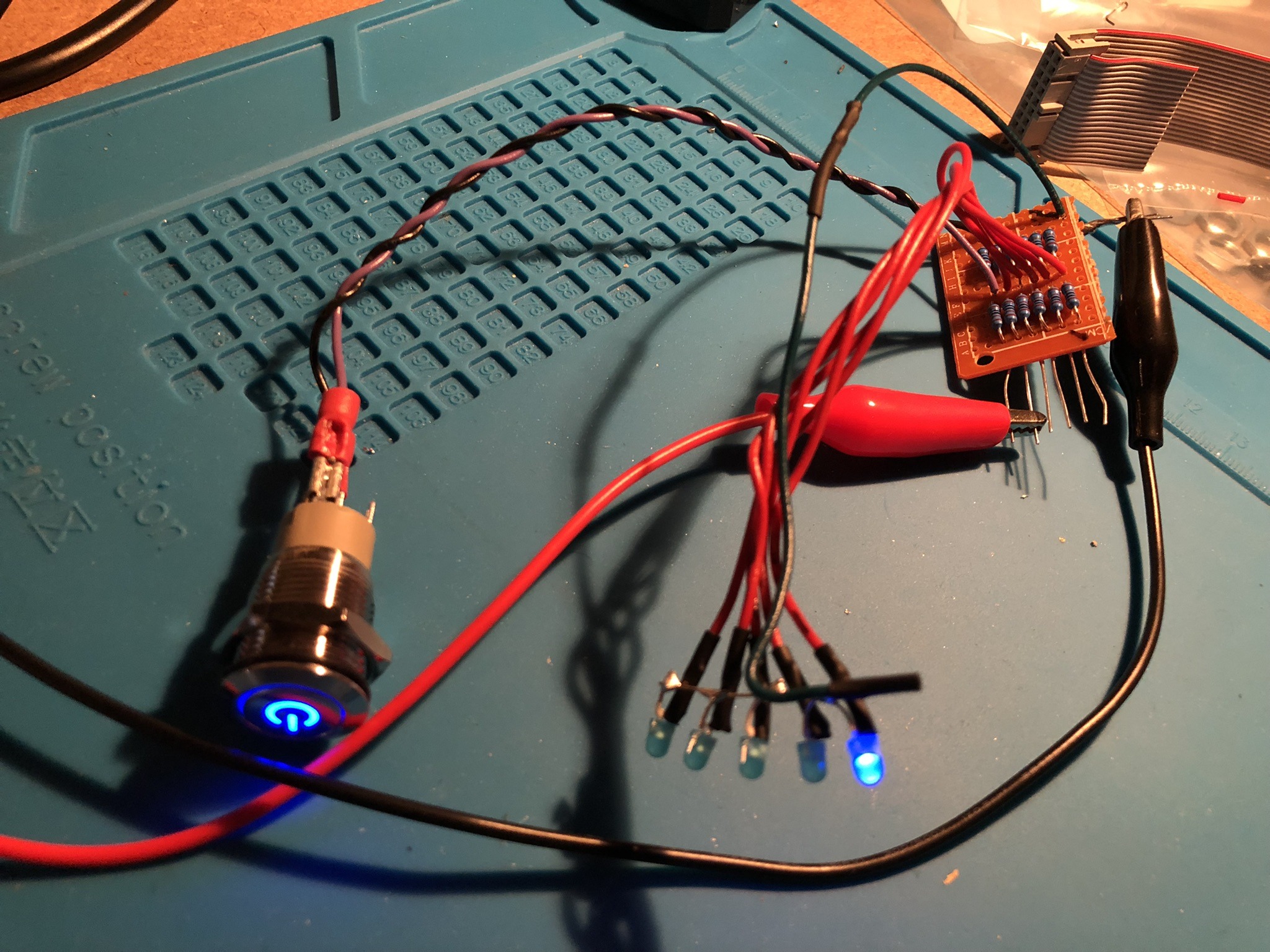

I like the modular approach with the input board being separate, and I think this could be taken a little further. For example, since the selector switch is separate, I wired the volume pot to the board rather than mounting it so that I could achieve the spacing I needed between the vol pot and the tone control to the left of it to match the spacing I had between the selector and the tone control next to that. Maybe keep the tone cluster on the board and split the vol pot onto its own little PCB?
Selector Indicators were easy to fabricate and solder to the selector PCB. I took the long route here and created a voltage divider for each LED. Perhaps the only change here could be to add another row of drill holes to the selector PCB to wire in LEDs.
An ON/OFF provision using a relay on the PSU board would be really nice. While you're at it, add a very simple soft start circuit (using a couple of thermistors?) and provision for switch indicator LED. I took power off the selector switch for my power switch indicator.
Provision for an OLED display would be really trick! Bonus points if it is able to display input selection and individual levels for vol and tone controls.

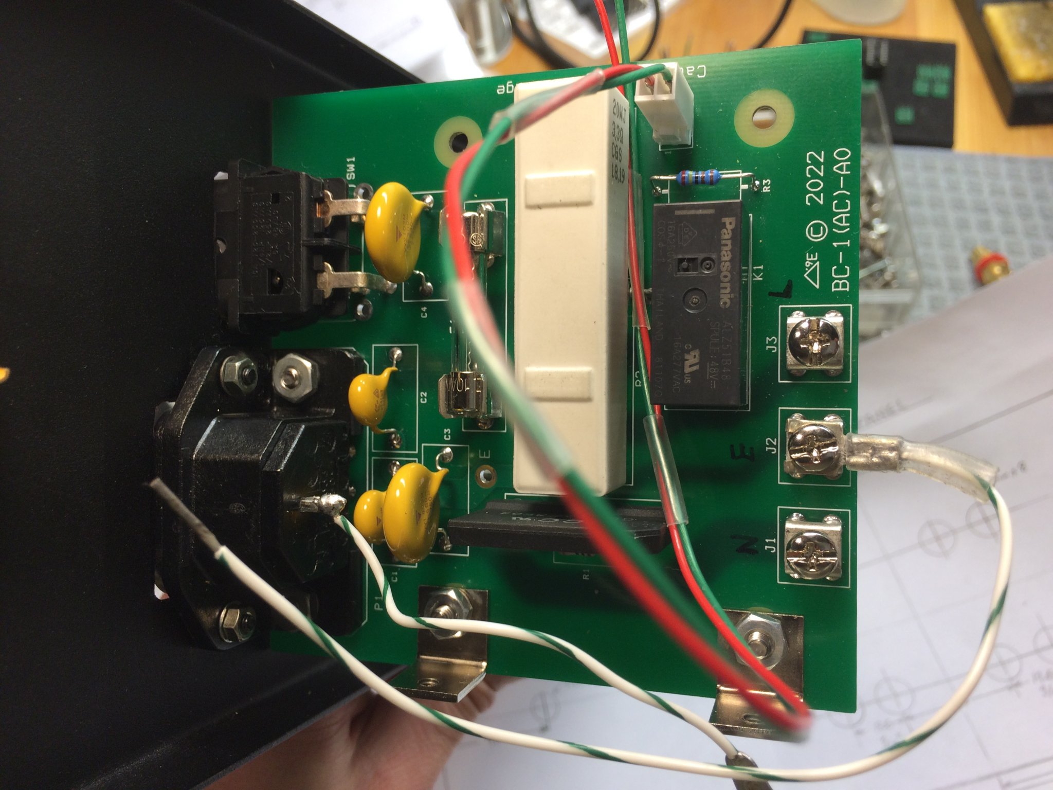

I do not think a soft-start is necessary for the power draw, but
I have done one for the BC-1 power amp that I got going recently. This is used in a HiFi2000 dissipante 3Ux300mm chassis with the base pan.
Learnt something about X & Y cap do and do nots 🙂 PS. Just use the ceramic X & Y rated devices
Having a soft-start means two relays, one to short out the limiting device and the other for on/off, more complication?

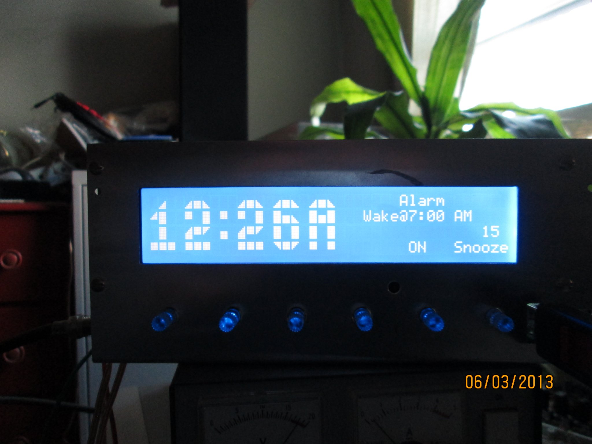

I included a few pics of the BC-1 soft-start & the portable radio, to show an example of a cheap and easy to program user interface,.
Look Mom, it can tell date and time, has a alarm clock too 🙂
Now I remember, damn, I could not figure out how to code the daylight savings time correction 🙂
Mother, at 92 is my GUI tester 🙂
