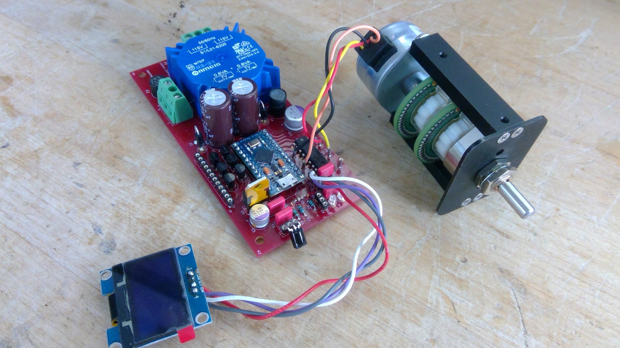

Goldpoint now offers a 47-step attenuator. I have developed an Arduino based board to control the Bent Audio stepper motor. A small quantity of these motors are still available. As the Arduino offers the possibility of much more functionality than just volume control, I added outputs to control relays and an I2C port for an OLED display. If there is interest, I will start a new thread.

Yes, excited to see details in a new thread. Nice work!

I fail to understand what you're trying to tell us (which, of course, may be my fault):
The preamp was designed for 5k linear pots, while the attenuator which you mention starts at 10k log. How should I integrate it into the preamp?
Fair question. Earlier in this topic a number of volume controls were discussed, all with the intent of being remote controlled, but some controls also were suggested that could be seen as offering better performance of the volume control stage. If I understand Mr. Self correctly, the active volume control circuit in this preamp has the primary benefit of offering a closer approximation of "logarithmic" attenuation than traditional "logarithmic" taper pots. However, it may still suffer from channel-to-channel inaccuracy, which is a function of the mechanical alignment of the two wafers. Stepped attenuator solutions, either rotary switch based or relay based, can offer more ideal performance in this aspect of their behavior.
Relay based attenuators have several disadvantages as well, one of them being that they offer no visual clue as to what attenuation they are set for. This can be dealt with by displaying their setting on a display. But there still remains the issue of the initial setting of the attenuator when the circuit is first powered up. A solution to both issues is to use a pot with a DC voltage across it, read the DC voltage with an ADC, and then translate the reading into a setting for the attenuation relays. All well and good, but certainly a rather complex solution.
A rotary switch based stepped attenuator, has a somewhat more complex issue with motorization, as it must be driven with a stepper motor, rather than a simpler DC motor that can be used to drive a linear pot. The solution I offered is simply that: a way of adding the remote control function to a stepped attenuator rotary volume control. In terms of how it would be applied to the pre amp in this thread, it would replace the entire active volume control stage. The same would be true of a relay based stepped attenuator. The stepped attenuators, by the value of the resistors chosen for each step, create the logarithmic function. There is no point to placing a precision stepped attenuator inside a feedback loop.
Please understand that I am in no way suggesting that the motorized linear pot, placed inside the feedback loop to become an active volume control, is not an excellent solution. It was only that the discussions in this thread sent me down a different path and I wanted to share that work if any others are interested.
