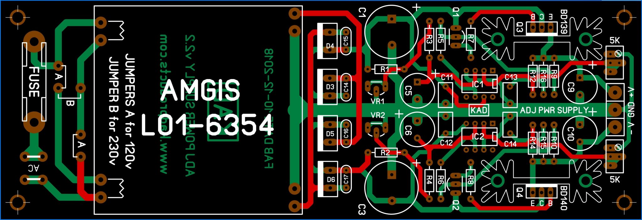

We've shipped a couple of different power supply PCBs in the kit.
Which one do you have? There should be version numbers on the bottom

Yes it is that one. Thanks!Does the PCB look like this?? I'll will post details ...

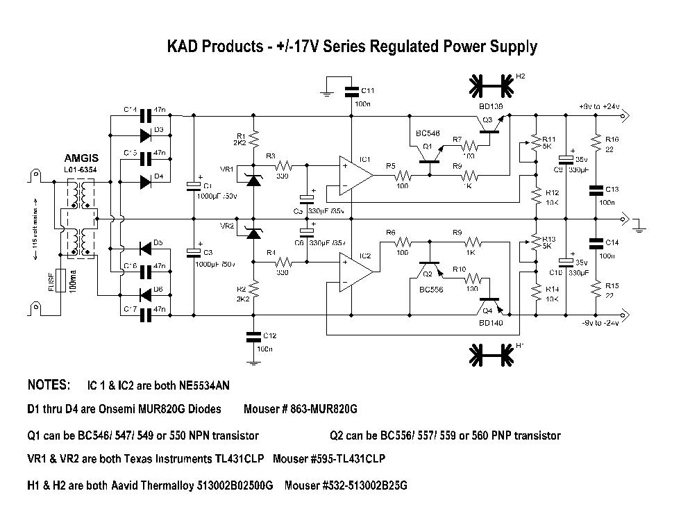

I wonder if MUSES01 or MUSES02 is a direct replacement for the LM 4562 Op Amps used here. I have a hesitation over their working voltage. Is there any other reason not to use them?
I am trying to use the power supply schematic in post 2053 to come up with the BOM for the 2.2 power supply. I think I have most of it but the image you shared is blurry in spots so...
Can't quite tell what the values are for:

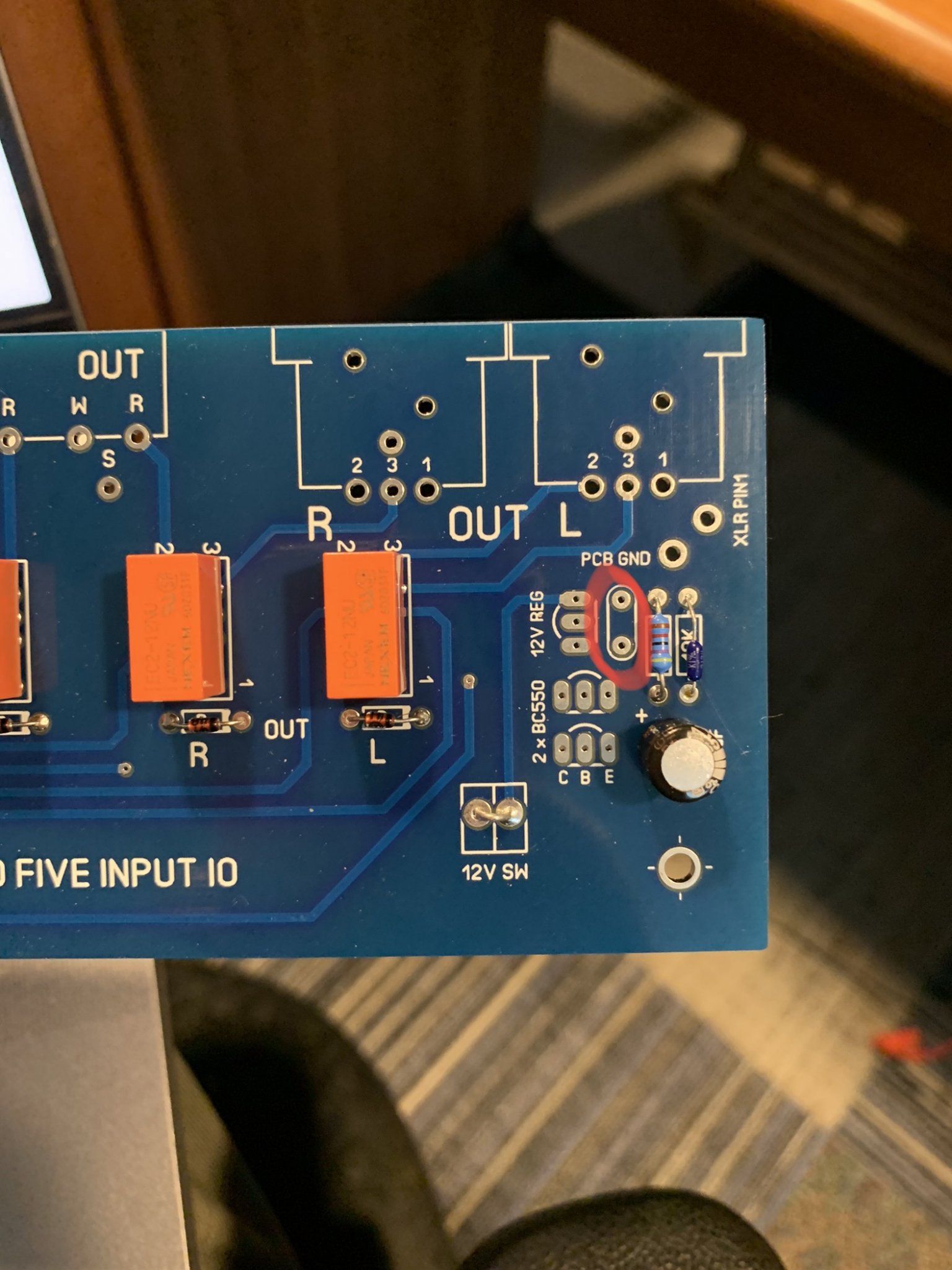

Also--while I am it...on the input board what goes in the spot circled in this image:
Never mind on the resistor values, I found the schematic as posted at 1893.
Assuming that the circled area on the image is for a small value capacitor but but what value?
