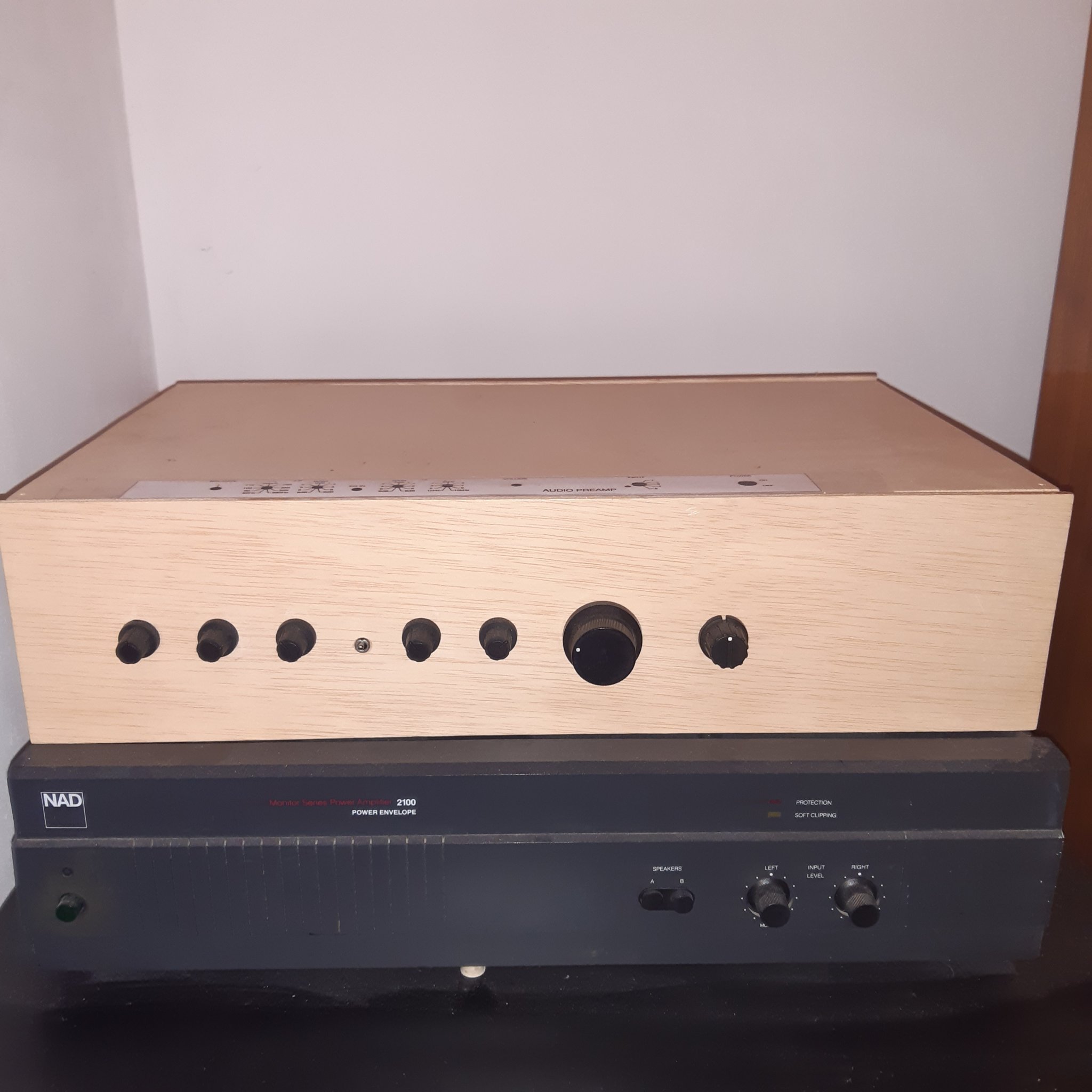

Please upload design file and Gerber filesI've been spending some time with this preamp and have a few interesting learnings.
Firstly, I would like to thank again Carl and everyone else's in this thread for the bits of information, this preamp really is special.
* Subjectively, it "sounds" amazing paired with the Benchmark AHB2 amp on low gain. The high voltage output drives the AHB2 perfectly.
I've played around with EQ with some records and the result is very satisfying.
* I received the rear panel based off of the scaled PCB in post #1953 and it is a perfect fit. I will upload all of my files when I am finished with the project (updated BOM, front and rear panels). The 230mm depth Slimline 1U is a perfect fit.
* Grounding -- I had initially connected the IEC socket to chassis, in addition the PSU 0V through a ground-loop breaker. With that setup, I had a buzz once the volume pot was at a moderate listening level. I had assumed that XLR Pin 1 is connected to signal ground based off of post #928, but it seems like on the latest IO board Pin 1's are not tied to ground.
Shorting the Pin 1 pad on the PCB to the chassis took care of the buzz and the preamp is dead silent even at max volume.
* Balance and channel matching -- I used Bourns center detent pots (PDB182-K220K-502B) in all positions except volume. At the center detent, the channel matching is off by 0.5dB (at Unity gain). As such, I figured its better to use the Alpha pots without the detent and screw center the knob where the channel matching is optimal. At unity gain (and less even), channel matching is better than 0.1dB. (graph attached)
* EQ measurements -- I measured the EQ with gain set to max (-/+ ~9dB), and the frequency at the pot extremes and center detent (80hz, 200hz, 680hz).
With the knob at the center (200hz), 9dB gain occurs up to around 50Hz, whereas there is ~3dB at 200hz.
At the 680hz mark, 9dB gain is up to around 200hz, whereas again it is around +3dB at 680hz.
Given that, I could use some assistance in understanding whether this is expected, or the front panel markers should be updated to more accurately represent where the EQ is happening
