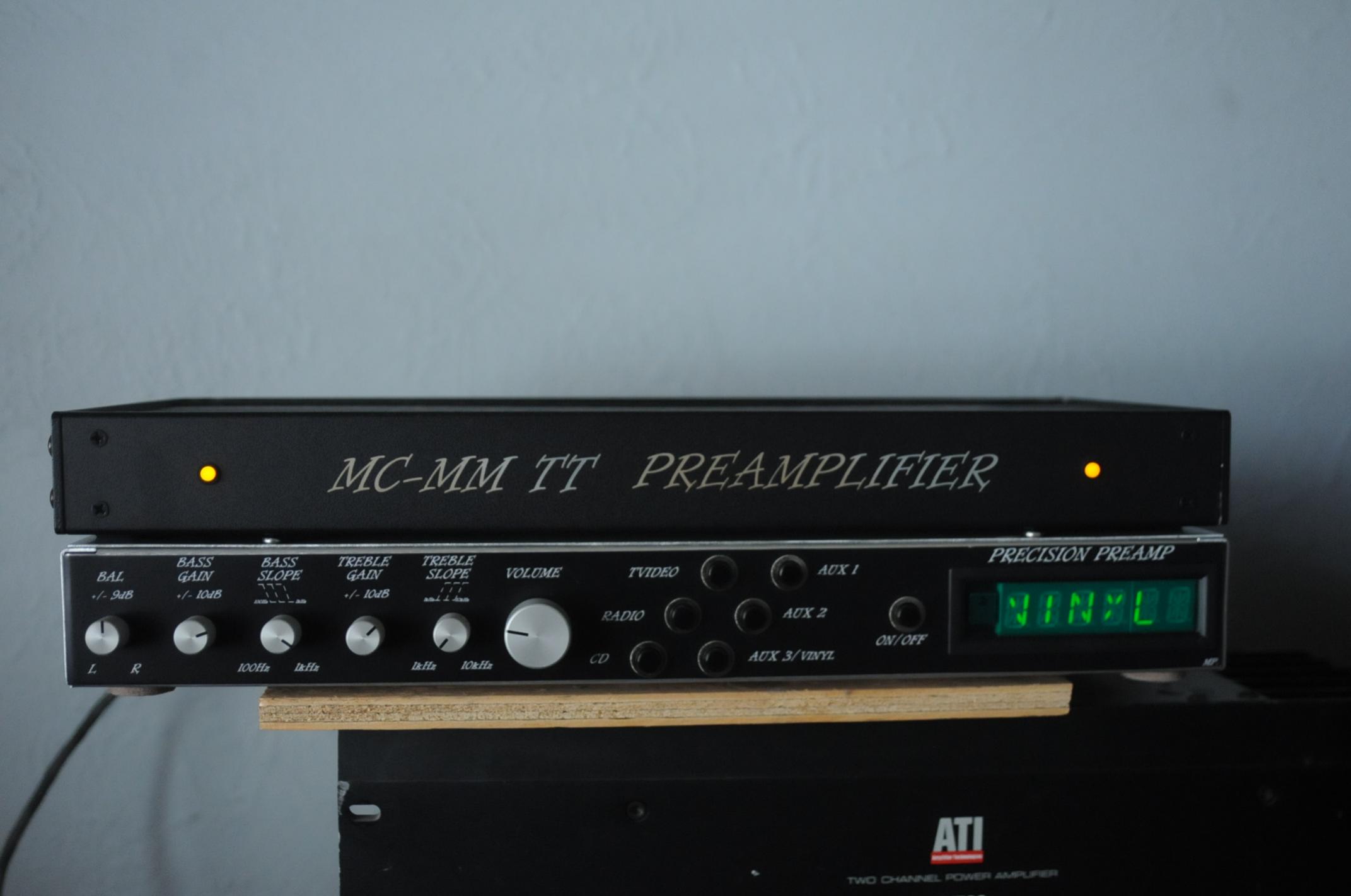

Hi everybody, nice to read that I'm not the only one that worked around Douglas Self's precision preamp. I started to read his articles in Electronic Wireless World back in 1996. It took me 20 years to decide myself to build it and it really worth it. I got rid of my homemade sub-woofer since the quality of this preamp brought the very deep sub bass even at low level listening.
The box I used cost only 45.00CAD and is 19'' wide. My contribution for the final look is the homemade display and remote control. The phono preamp is outside in an other box and it include a Devinyliser also from DS.

Forgot to say, volume is motor drive, have a mute and can select anything with remote.

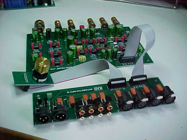

I need to troubleshoot my preamp. Signal getting lost somewhere. The component labels on circuit board are mostly covered by the components. Can a silk screen of the board be posted, or a photo of top of an unstuffed board?
Hi-Rez PIC of the DSelf v2.1b Main PCB
"I need to troubleshoot my preamp. Signal getting lost somewhere. The component labels on circuit board are mostly covered by the components. Can a silk screen of the board be posted, or a photo of top of an unstuffed board?"
Here is a URL to a 'Hi-Rez' PIC of the v2.1b main PCB. I am guessing that you either have a bridged or old solder joint. In any case this should help.
Dropbox - DSELF_PREV21b.JPG - Simplify your life
"Here is a URL to a 'Hi-Rez' PIC of the v2.1b main PCB. I am guessing that you either have a bridged or old solder joint. In any case this should help"
Yes, this did help. Problem solved, preamp works! Thank you Carl.
