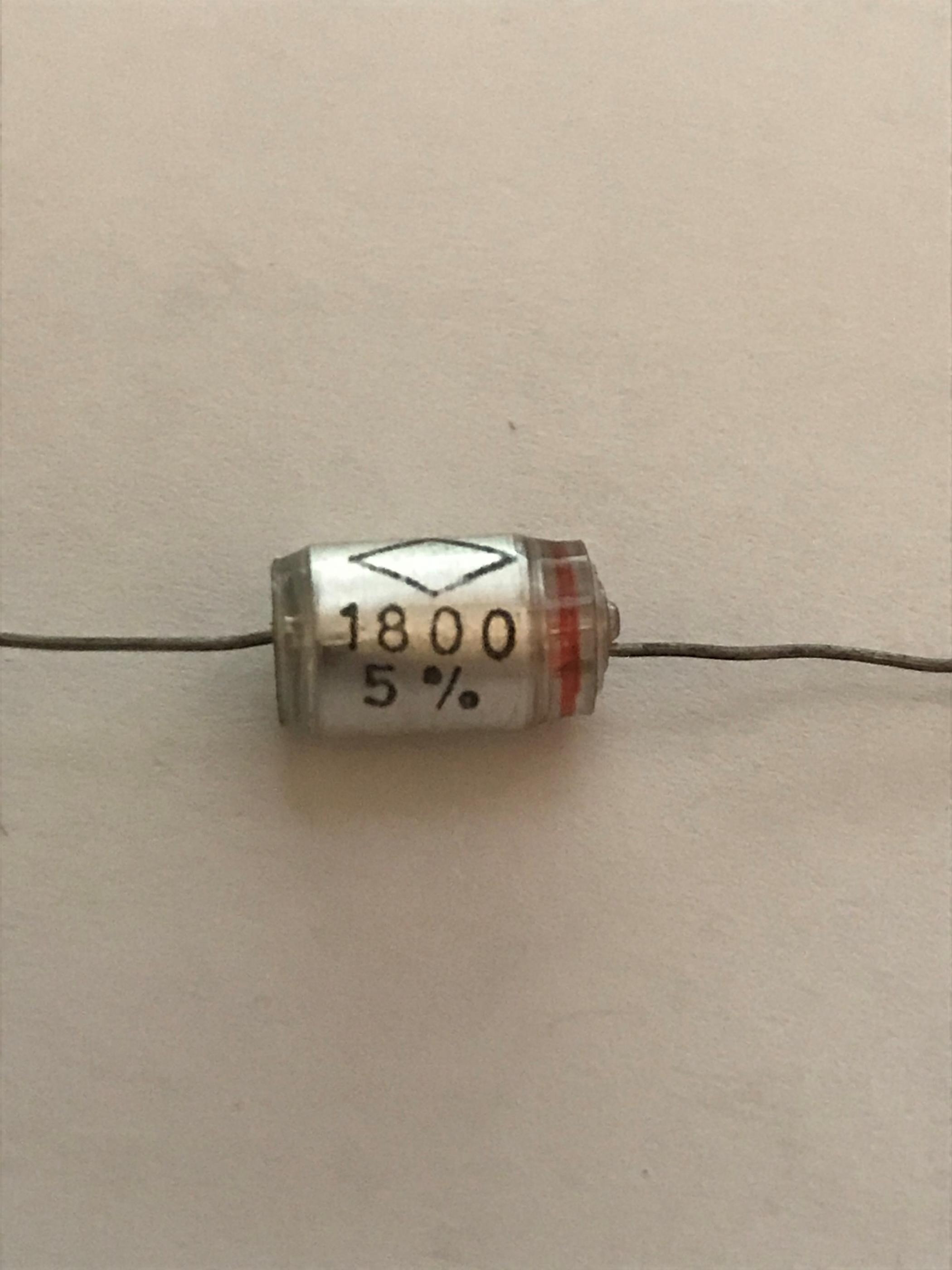

The band shows the outer connection of the foil and can be used to shield the internal part of the cap from hum/noise pickup if you connect it suitably.
For example if the cap were across an audio input to ground you would connect the band to the ground end. If it were a feedback cap across an opamp output and input then you would connect the band to the opamp output to make use of the low impedance at that point.

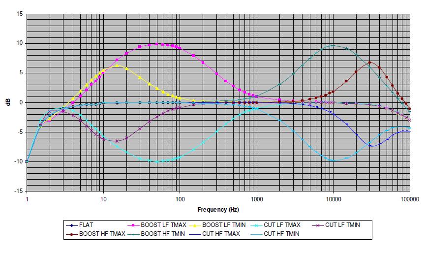

"Would it be possible to see response curves of 3dB or 4dB boost for the bass turnover points and -1 or -2dB for the treble points? "
I don't remember where this graphic came from but I do remember that it closely matched what I was seeing when I modeled the tone controls using my aging CircuitMaker software. I find the tone controls to be very usable and pleasant to listen to. I invite others to offer up with their opinions.

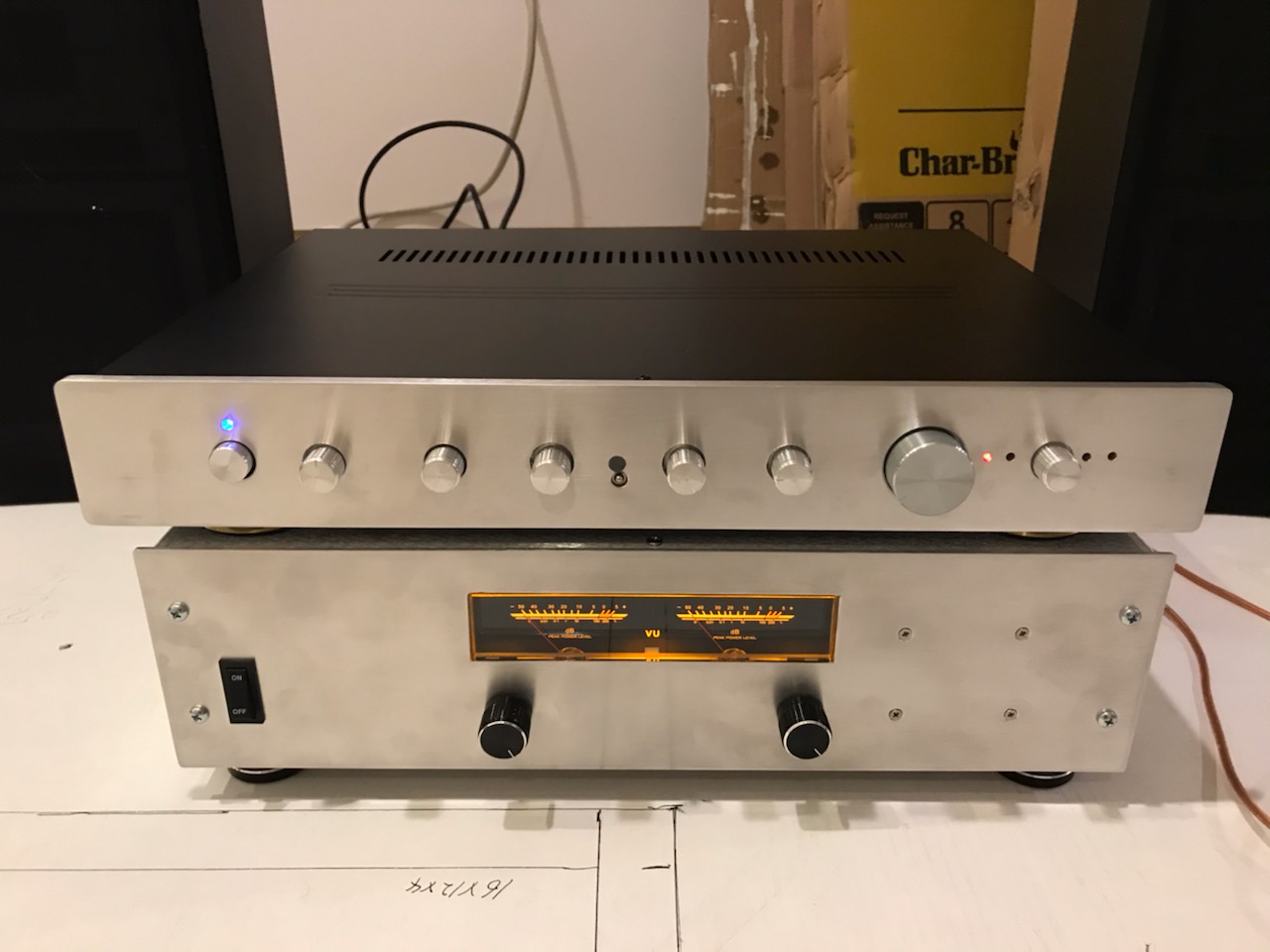

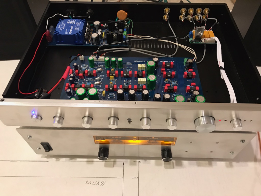

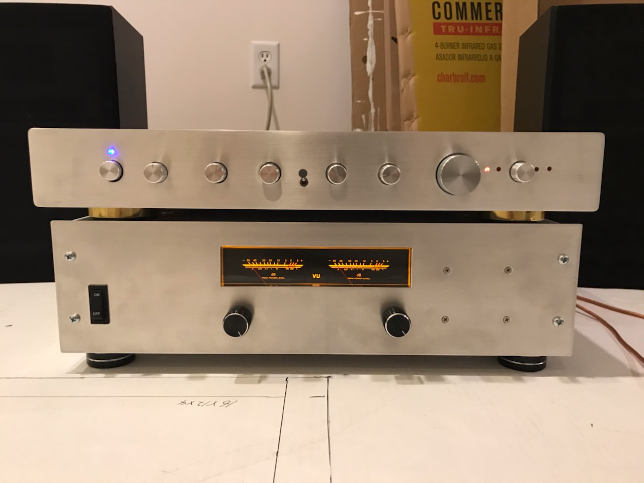

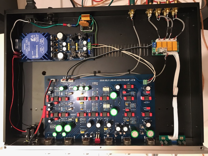

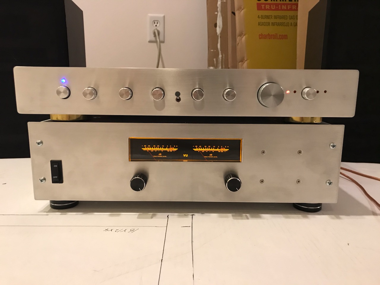

Finished Pre-Amp
Took a while...Lots of resistors and caps!

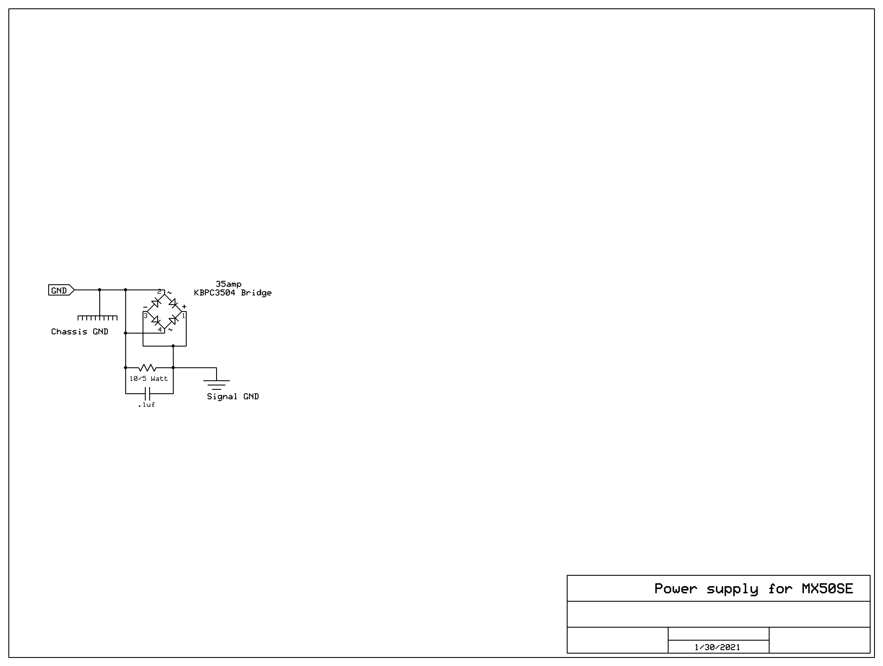

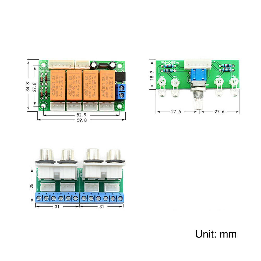

I decided not to incorporate the balanced inputs and to make the input selector I used work, I eliminated R53 L/R and put a ground on Pin 3 of the output also did the same for R1 L/R but put a ground on pin 2 of the input. This way the 3 pin plugs on the input selector worked. Also I powered the Power LED from the mainboard with a dropping resistor and installed a 2 pin connector. I ended up building the chassis to signal ground idea from Elliott Sound under his power supply section.

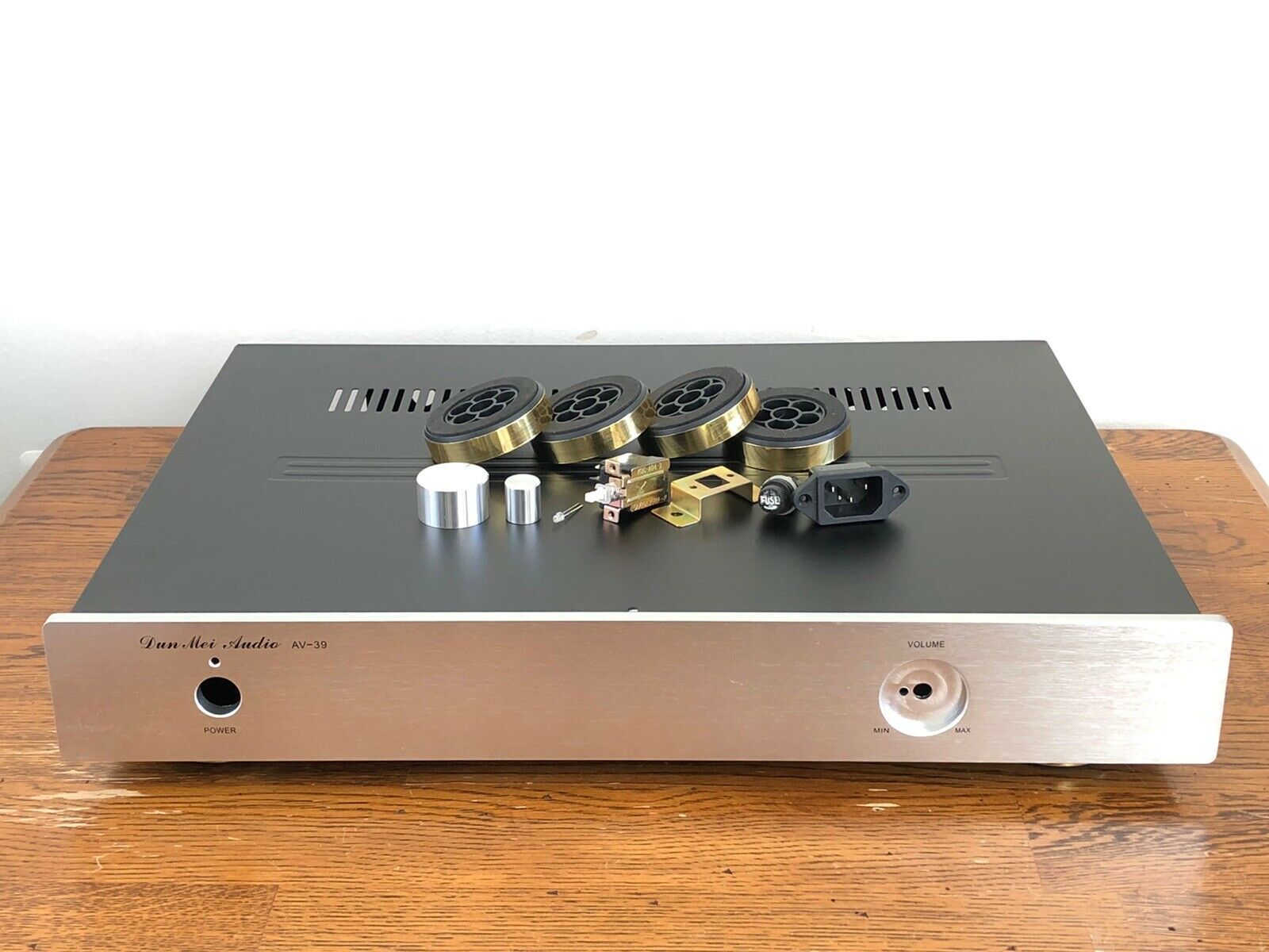

I purchased the Dun Mei Audio AV39 chassis. To countersink the holes I used a flat wood boring bit with a drill press so the knobs set in the face plate. REAL FUN!!
I set the power supply voltage to +/- 17.6 vdc per the reading in this thread. If this is wrong, please let me know.
The Sound is a very close match to my Yamaha C-50. Subtle difference of course is with the balance. The Yamaha does not have this type of balance.
I'll eventually setup a pair of Cerwin Vega D8-E's and do some comparison tests. For now I'm just using a pair of Fisher studio monitors.
It sounds very good through them.

an acrylic screen with the marking for at least what is on the board : EQ and Volume pot and balance (not source selection, this one being be positioned at right or left where the diyer wants best.
That's beautifull 90Scaraudio,
An acrylic screen with 4 holes a printed screen for the pots markings would permit to see the metal casing as well as the wood panels for those having one and perhaps would be less expensive than the metal printed one (around 100 USD and more just the front panel).
Any ideas where to source that, folk ?

I was told that the power supply should be set to +/-15vdc for the LM4562 Op Amps. Adjustment made, sounds the same, components are a little cooler.
Perfect:)
