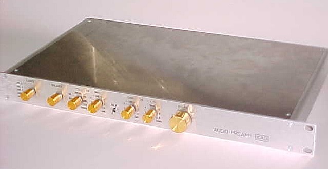

Just completed this preamp working on getting panels cut Rather than reinvent Foes anyone have available .DXF files that can be used for front and back panels? I have tried to convert the .pdf files I have found on the site bug won’t convert. Any help appreciated
Thanks. I'll check the thread. Parts came from Mouser.
