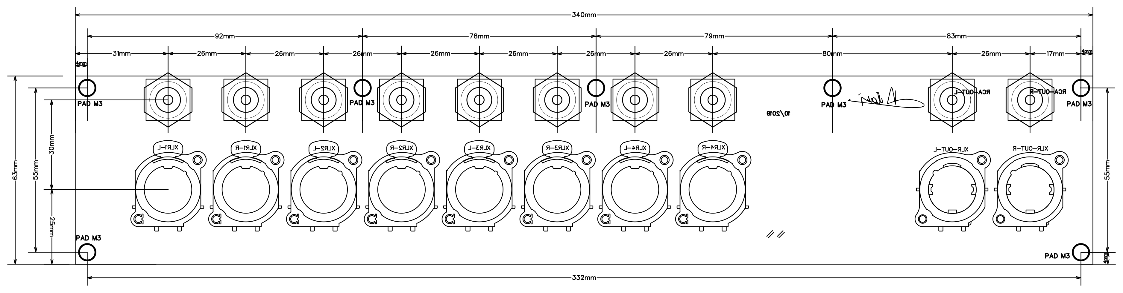

tER i have I/O board with phono input, look in my signature. i don't know if that can help

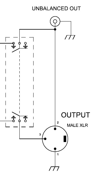

Thanks for the tip, it may very well! Do you, by any chance, have any FPD/DXF-files that'll fit the I/O board? And how would I go about connecting the I/O-part to the board? It's rather hard to tell from the images, but does the board switch between possible in puts (just like it would in the Doug Self I/O - output, see attachment) or are the RCA and XLR always active at the same time?
tER,

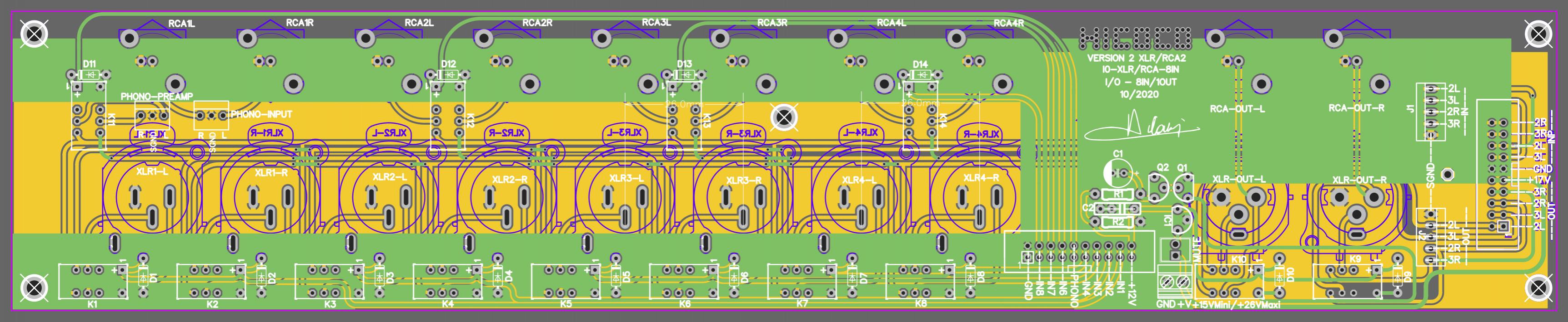

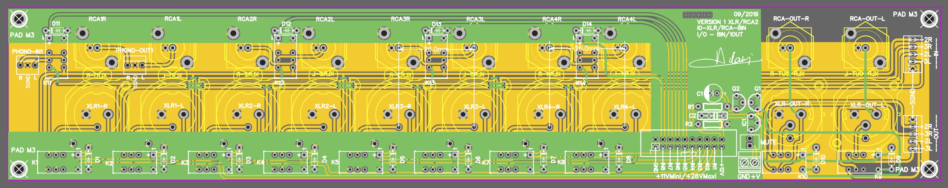

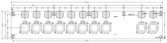

The board that will fit the best your need is 8 inputs with 4 RCA and 4 XLR ( separate from each other) with input RCA1 is reserved for phono input, the inputs switch between with the selector.
Yes i have FPD/DXF-files.
The inputs and ouputs connection to Dself preamp could be done easly from the HDR VERT DOUBLE 20P to the I/O board with the 5-pin Molex KK
The bad news is i am out of stock actualy of this board, i will need 2 weeks to get those, please PM if interested.
I updated and redesigned the 8 input Board (340mm x 66mm)to be able to use the same ribbon Cable who is connected to the Dself Preamp board with a new 20p connector. That is 4 Unbalanced RCA and 4 Balanced XLR separate Input.
