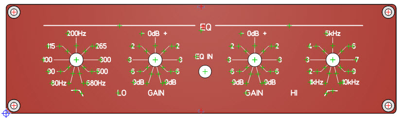

Just completed this preamp working on getting panels cut Rather than reinvent Foes anyone have available .DXF files that can be used for front and back panels? I have tried to convert the .pdf files I have found on the site bug won’t convert. Any help appreciated
Maybe I didn't understand your requirements but mechanical files for front panel provided in this thread are in .fpd format. they can be opened with the free software on www.frontpanelexpress.com then export as .dxf (even a 3D export is available -> .step format)

Hi Diyralf,

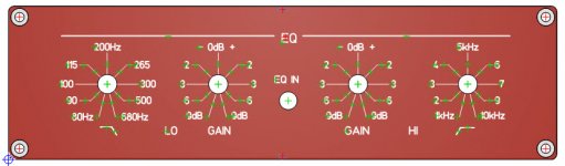

The software front designer allows non 19'' enclosures design. As the .fpd is provided in 19'', you can design with the software a non 19'' enclosure then copy/paste the "drawings" from the 19'' design. You can choose and change everything, the color of panels, .... just be aware to have an enclosure where the electronics board can be mount 😉
Example in attached file. The width is 200mm (19'' is 482.6mm). So maybe a width of 300mm + a height a little bit more and you can place all of drawings from the 19'' panels. Another solution is to place some things at the rear of the enclosure.

Hi Diyralf,
What I was trying to say was that I don't like these 19 inch audio racks. Nice metal enclosures are very difficult to buy.
