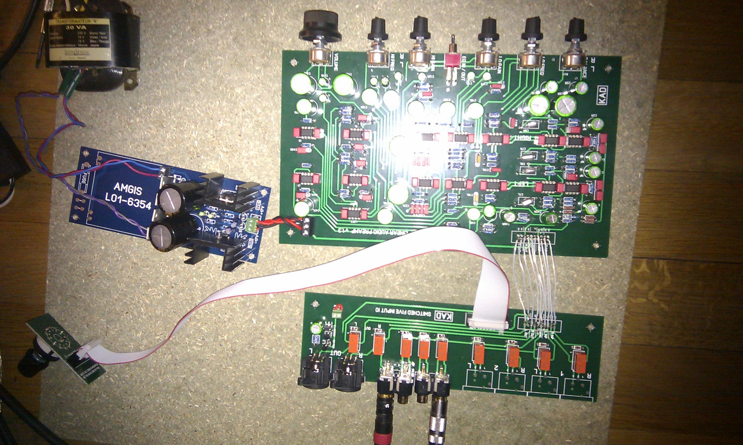

Yes, Muses everywhere on the main board ! (as BOM !)
I believe it diserves some others caps at power positions on the pre pcb for a "less" thin sound !
I saw some used Nichicon FK serie for the biggest caps of the pre board, I believe there is better to do .
YMMV, my amp and speakers are very on the clear side already !
Nich. KG for the PS board is a very good decision; I will change the others 100 uF caps of the the Power boards ! But it's a detail and I had no time to tweak the sound for my tastes/own system...
Last outrages to drosophiles as the design is good enough 🙂
Thanks to Doug & Carl

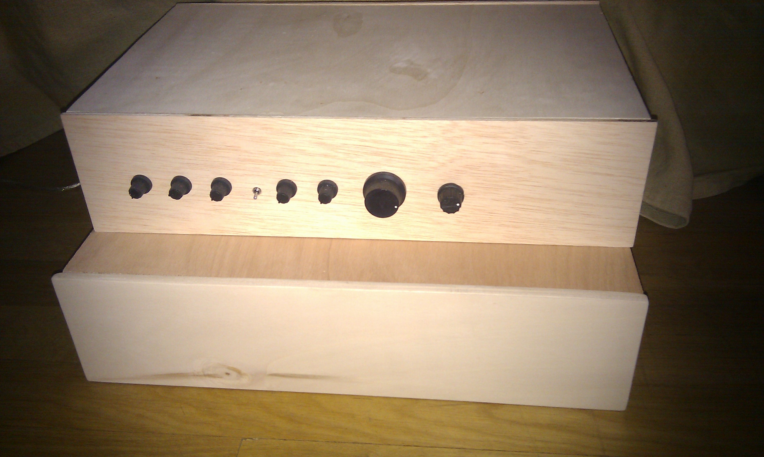

I should have mine up and running in the next few days. I'm waiting on some pcb screw terminals for the I/O link, I didn't like the 20way idc connectors specified in the BOM. I was thinking of hard wiring between the boards but this is impossible with them in situ and tricky otherwise. Also I'm going to use a supply that's already powering my active crossover. Do you think you'd be able to hear the difference with polarized caps? It will be interesting to see what graemed says after he's built his.
That's what I did between the main and I/O board : copper silver plated with PFTE suround! More by faith than benchmark, as most of the time it is what I use for my diy dacs.
My understanding is the flat cable for the select board rotary pot is not seing any signal ! Just for selecting the relays.
