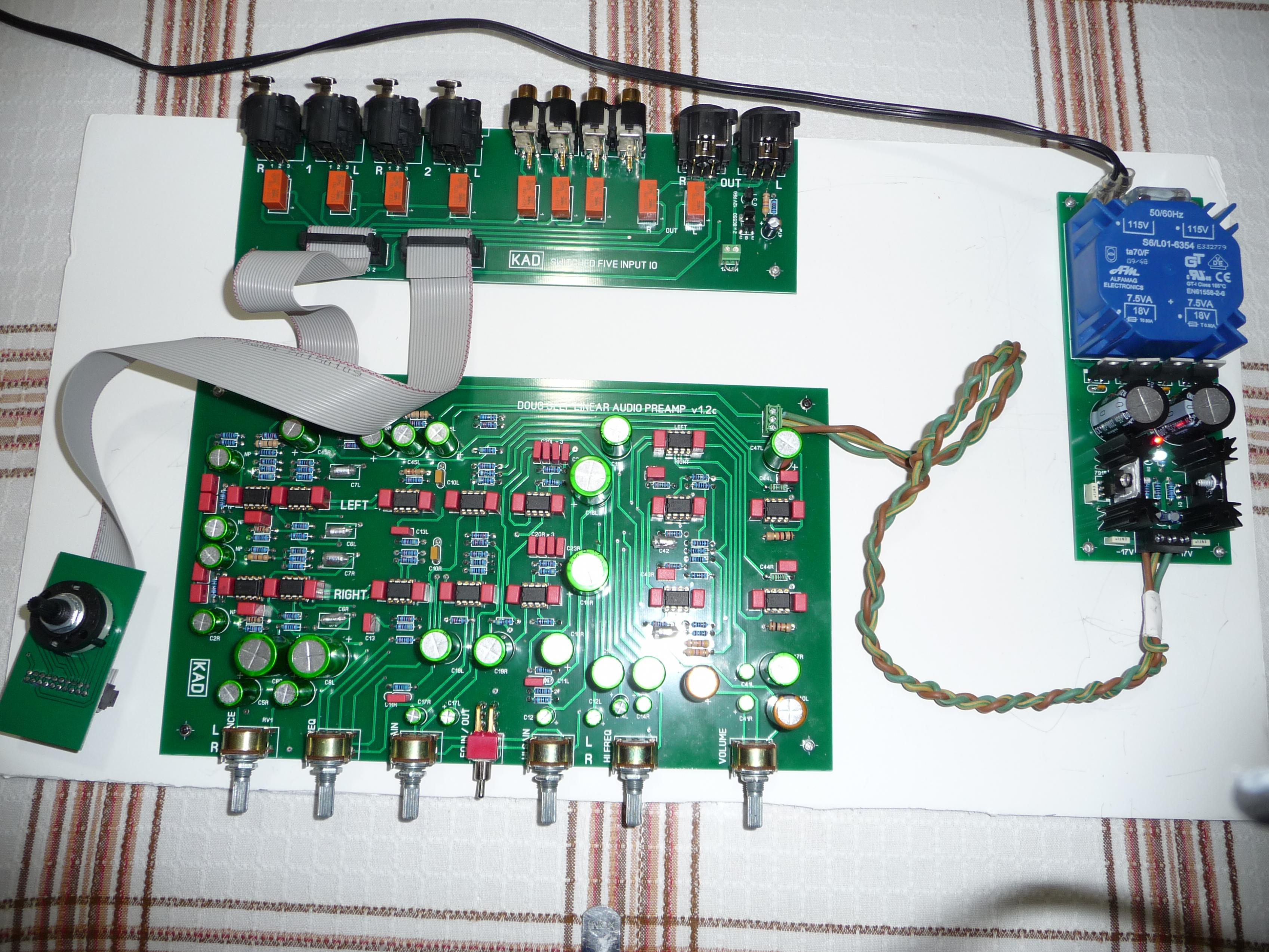

Today I finally powered up and listened to this competend preamplifier.Easy to build ,works perfectly,without hum,buzz or other weird noises.I noticed only one thing,in comparison to another pre,much simpler in design(a pot folowed by an op amp):noise at full volume with no signal was louder(with the ear sticked to the speaker,otherwise the difference wasn't noticesble).I listened to FM stations,through a pair of Visaton B80's.Sound was likeable,without flaws,as far as I can tell.Anyhow,the strong advantage of this pre is the tone control,which is very versatile.My compliments to Douglas Self and Carl Huff!

I wish you full success.I also intend to use an 1U chassis,but the one I found locally,according to the dealer's statement,has double bottom plate and somewhat lower internal height than 35mm,which is the minimum,in order to fit the selector pcb.I am interested to read about your progress in the construction.

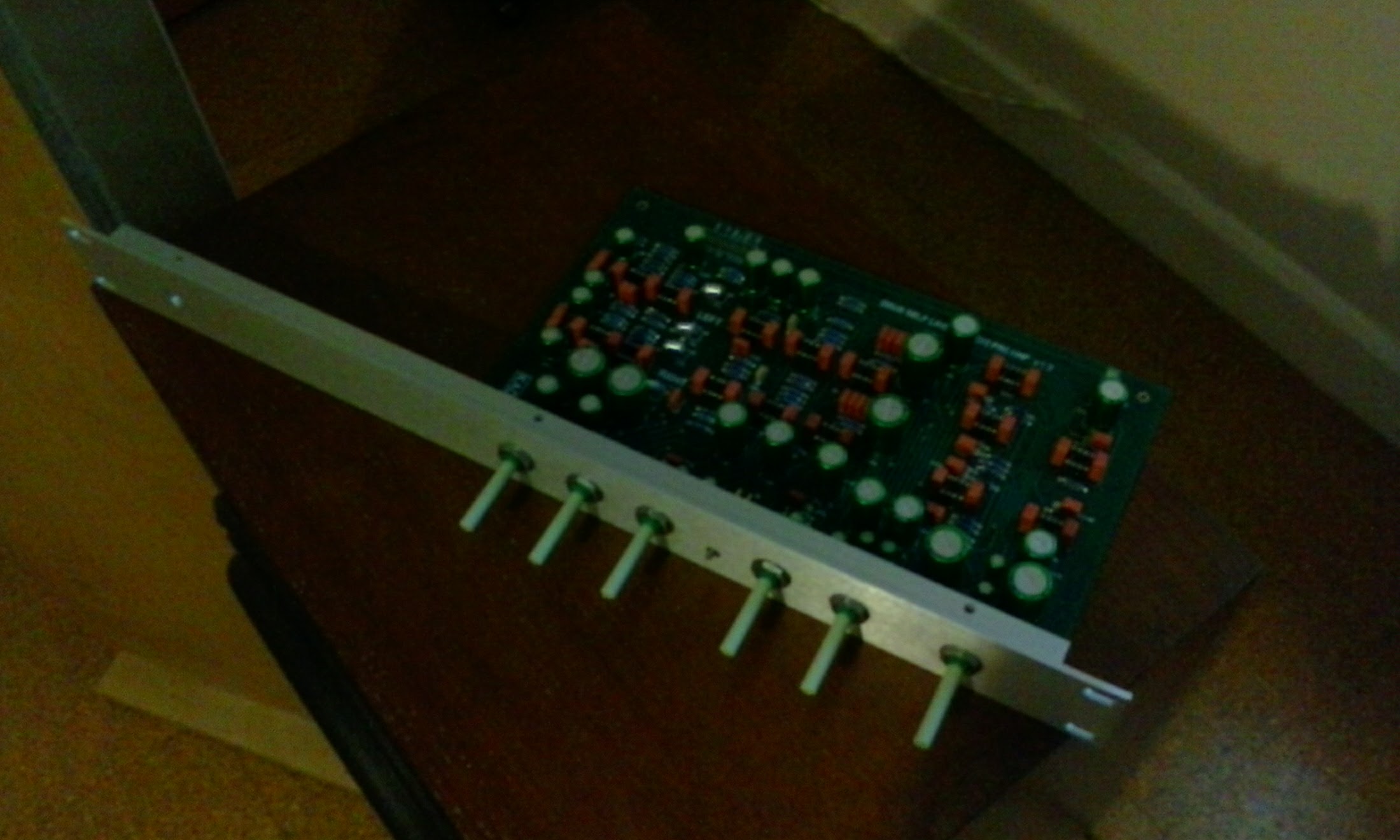

Thank you. I had a few problems with a couple of errors in the BOM. My PCB is the v1.3, very similar to yours, there was I minor mistake on the component layout printed on it, but thankfully I spotted it. Hopefully there aren't any I haven't spotted! Also I've used omeg eco pots which required slight pin bending to fit. I shall try to upload a picture, I haven't done it before so, we shall see..........or not 😀
