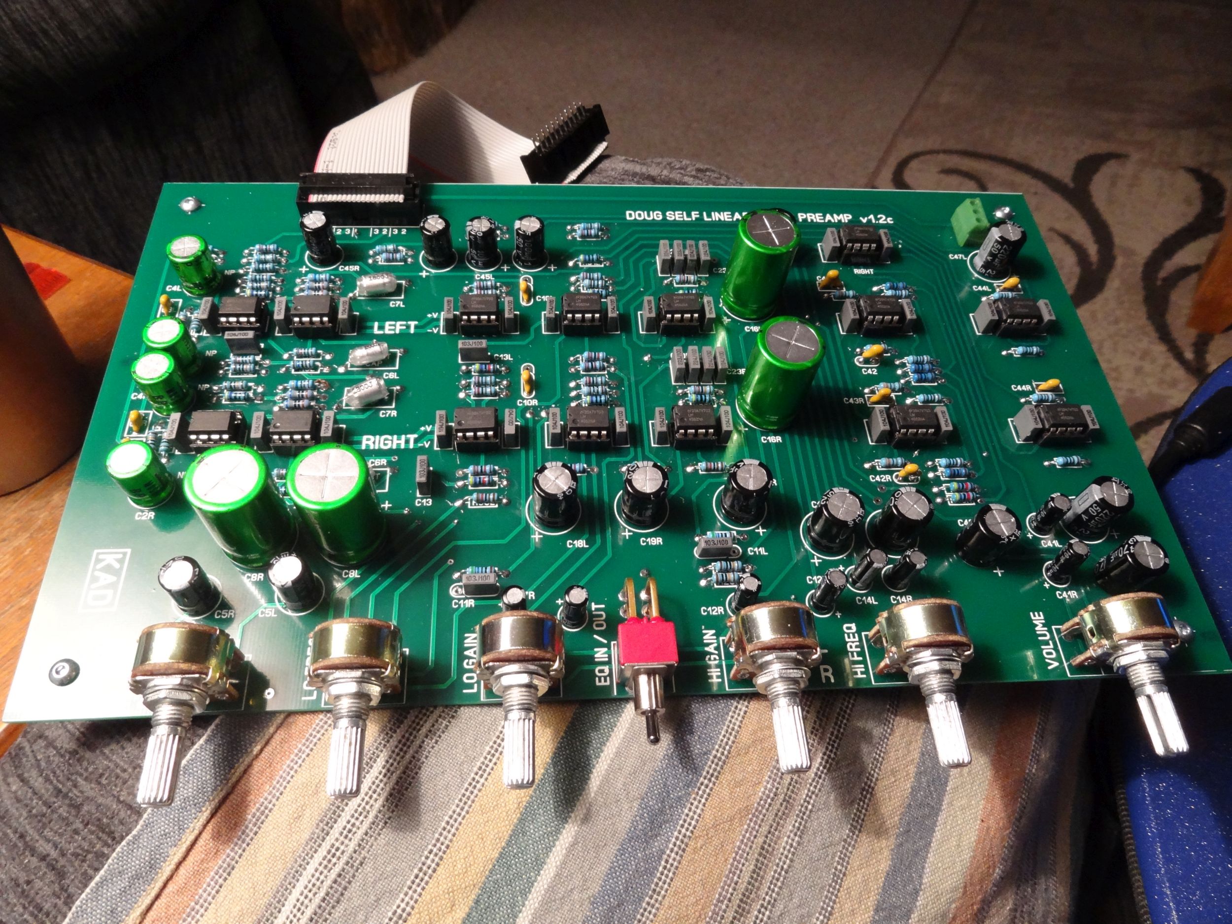

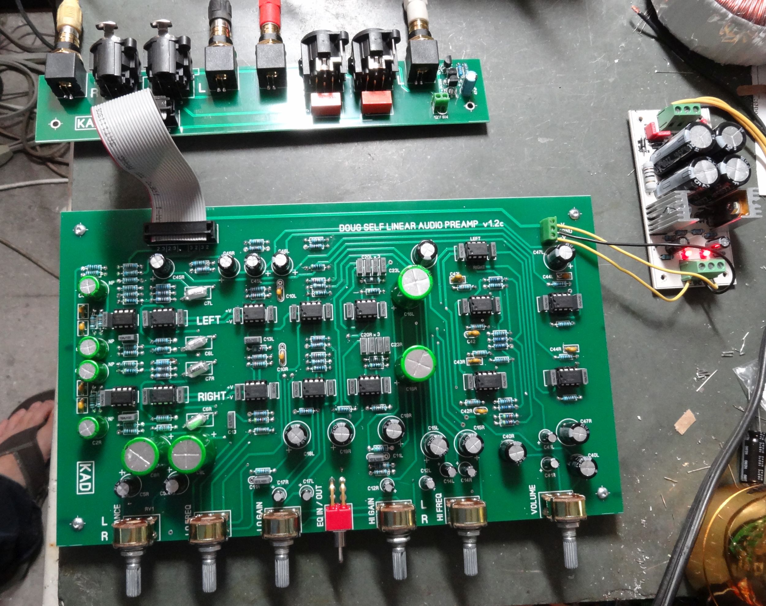

When I built mine, I used polar caps for everything except C2, C4, C8 & C16. The only reason I used NP for C8 and C16 is because I didn't have that value in stock so I just ordered what was in the BOM. Mine measures and sounds perfect.

Certainly would not hurt to actually test/measure this channel to channel gain imbalance. All you need is a sine wave signal source and a AC voltmeter (DMM). Use a sine wave for which your DMM can respond to. Many low cost DMM's the ACV function is designed for 50/60Hz AC line and the freq response usually do not not go much over 100Hz. The absolute ACV accuracy is not important, as you are comparing one channel vs the other, so it is a relative measurement.
Glad to hear you,mr Self!I suppose that,given the high gain of the combination pre+power amp,a slight turn of the volume pot brings one channel to life (and quite loud),whereas the other remains silent.
You also might want to check for 'solder bridges' top side of the PCB and under your volume control. You will have to look very closely as it will be mostly out of sight. That easily happens if you get a bit overzealous when soldering the pots in place.
You can even do a lot just with an ohmmeter. Methodologically check all connections starting at the input to the pot, going from solder point to solder point, checking for continuity as well as shorts to nearby traces. Compare the two channels. Sooner or later you'll hit the culprit.

This is what I found. However, my temporary fix with pot on power amp has bought things back in line. Initially it was impossible to get low level balance. I think the slight disparity at the start of the pot track was enough to get me worried. I will check over anyway and will probably reduce the gain on the volume control section.
