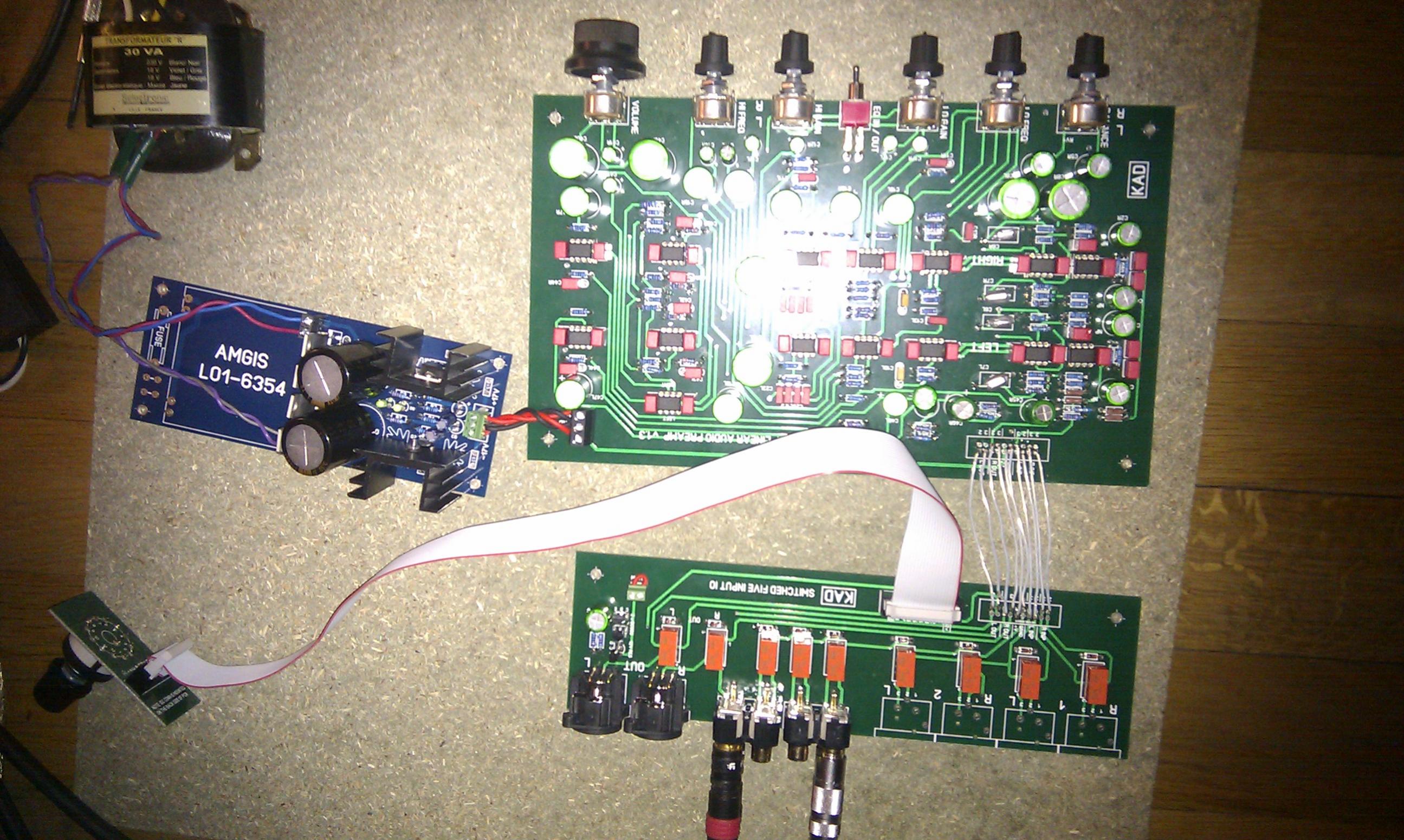

Hello Guys,
What I hear is good... but only one channel is working !
I checked with source & amp plugs by swapping : this is the pre which is involved !
After a visual check I saw one LM4562 (the one near the cap C2r on the left of the board) had two legs non pluged on the dip 8 , but even repluged, it doesn't work !
The balance pot is increasing the volume of the working channel when I turn in to the right but doesn't low it so much when I tuurn the pot at the opposite ??
Any idea what to check first ? Aops ? My bet is this is Something which works bad on the I/O boards... one protection diode ?
The selection rotary switch seems to work well and I checked on two inputs and this is the same result ! One channel only !
I use only single ended I/O !
I had at the first beginning a problem! one of the main cap polarity was reversed and was wasted after boiling but without shortcuts or explosion !
After changing the faulty cap and put it in the good position I have +16.5V & -16.2V.
Many thanks if you can help me for what I should check first !

Thanks Jan, Graemed,
Input/output cable was changed by 10 single wires. I just keep the flatted cable for the selector. I checked with the voltmeter/current buzzer !
I will check that.
For the aop, it was the pin 2&3 (left row) which were floating outside the dip 8!
I have two spares LM4562 🙂
The said faulty oap is working good. Btw it is on the RIGHT Row and the problem comes fron the LEFT Channel ine the ipper erea of the pcb!
I also resoldered all the joints and checked the caps polarities : all seems ok !
I'm going to swap the left row of oaps with the right one to see if the oaps are the gulties !
Maybe it was one of the reversed main Power cap at the first switch on which burned the left channel, I don't know but the 79015 reg involved seems ok with just 0.2 V difference with the positive rail !
Could it be one of the input orange relay ??? Or only one oap (not only the enterily Left row of oaps ?
Well I will swap Left with right oaps row to check !
fixed
🙂... The Douglas Self Pre is working !

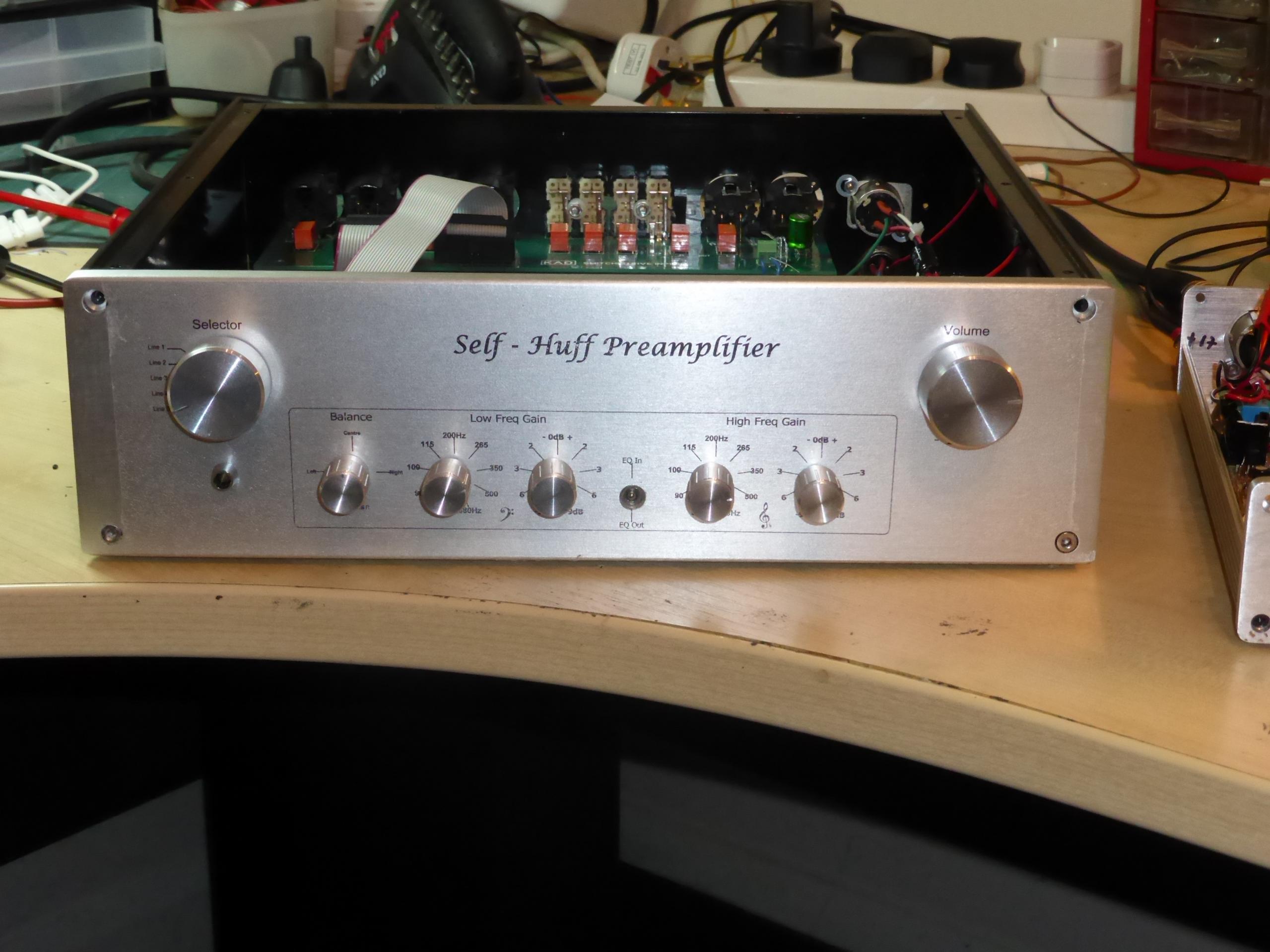

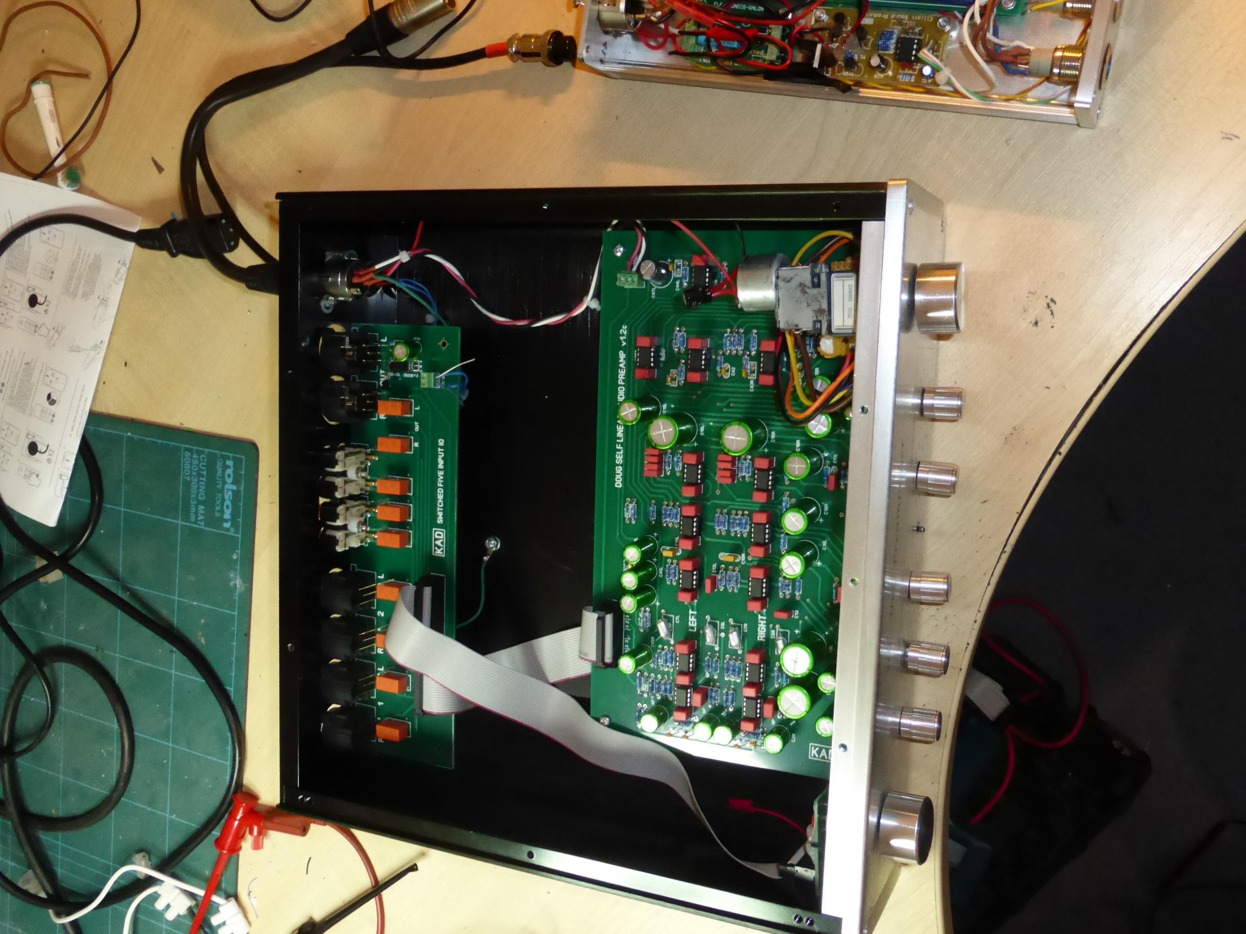

The Final Version
Well, it took a lot longer than I expected and I did embed remote controls for mute and volume control. The only issue has been a bit of noise when the mute is operated (it breaks the connection to the output board). Otherwise, the construction has been trouble-free.
There are two outstanding points about this preamp.
1) It is so silent that I thought it was dead when I first tested it.. and this is with headphones!
2)The detail that it reveals way improves over my old preamp.
Of course, the tone controls have enormously helped with tricky material, but also have contributed to a better room-balance for my NS1000M speakers. The only thing left me to do is to reduce the sensitivity as the volume control cannot be operated more than about 30 degrees before the sound is just too loud.
This is my second Douglas Self preamp. My first, from 1976, is still working and sounds pretty good...but not as goos as this.
So, thanks to Douglas Self, Carl Huff and Jan Didden for getting this all together
