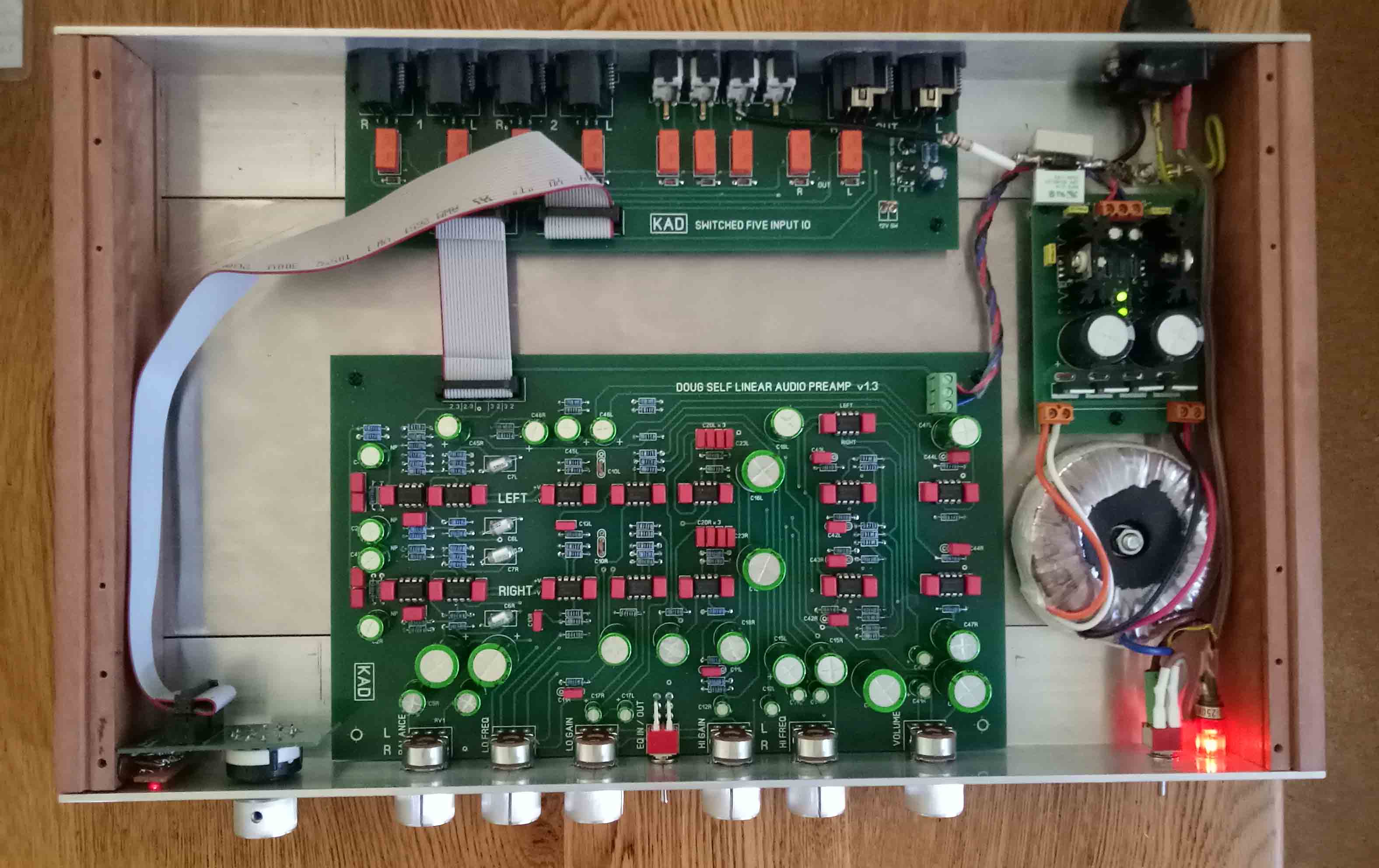

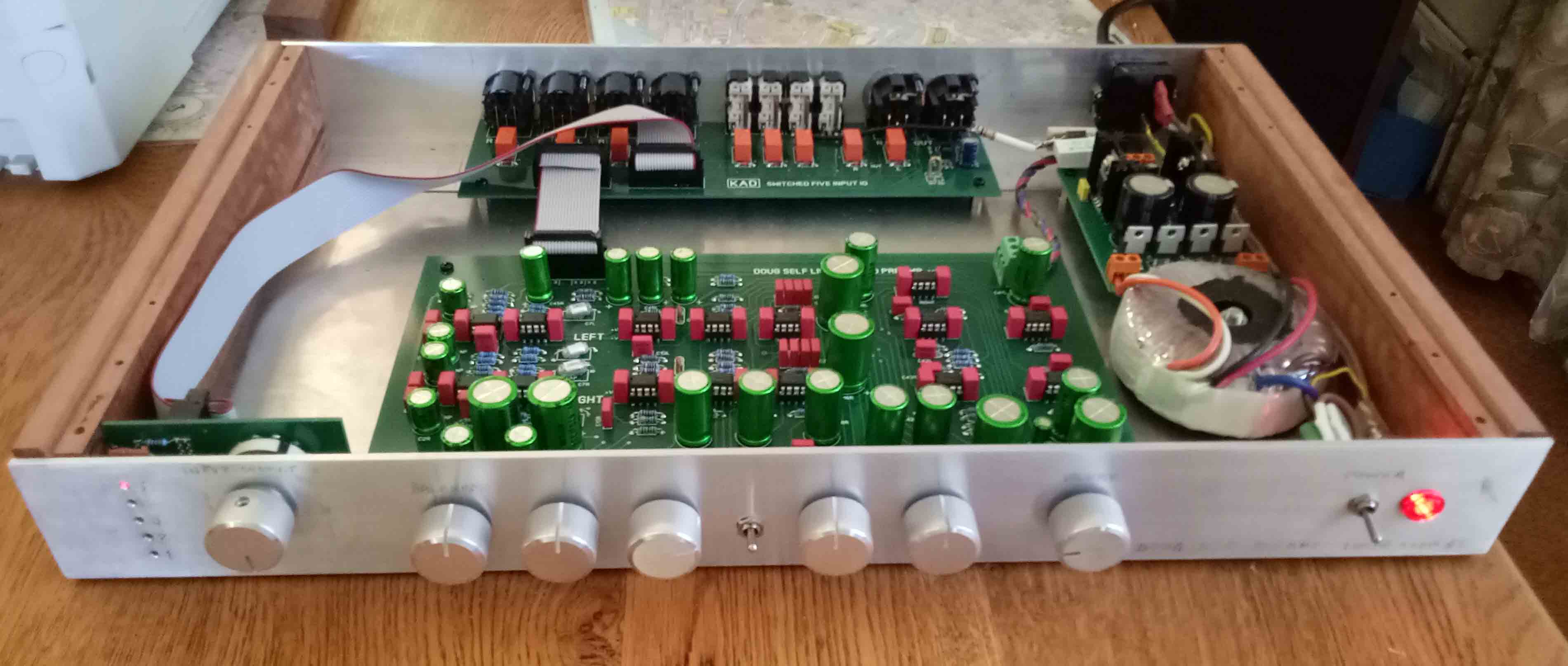

Received all of the parts and assembled the preamp. The finished preamp is shown below sans lid (still being built) and without proper graphics.
This piece of kit is quite magical. It is inaudible at full volume with no inputs, and the clarity of CDs, particularly well mastered ones is remarkable. I haven't tried it yet with the vinyl but am expecting great things.
Thanks to Carl Huff for his superb boards and of course to the designer par excellence Douglas Self, and Jan Didden for publishing the design in Linear Audio #5. Of course DIYAudio is the glue that connects us all and provides the vehicle for dissemination and day-to-day discussions.
Graeme

Nice Build. Clean Open layout. Is the Top going to be wood? Looks like you added led's to the selector switch board.? Well Done.
Thanks Rick. The top is to be timber - it's under construction. And yes I added LEDs to the selector switch: 5 red LEDs and 1 resistor on a bit of perf board wired to the switch board.
Still mulling over how to provide acceptable lettering on the front and rear panels.
Cheers
Graeme

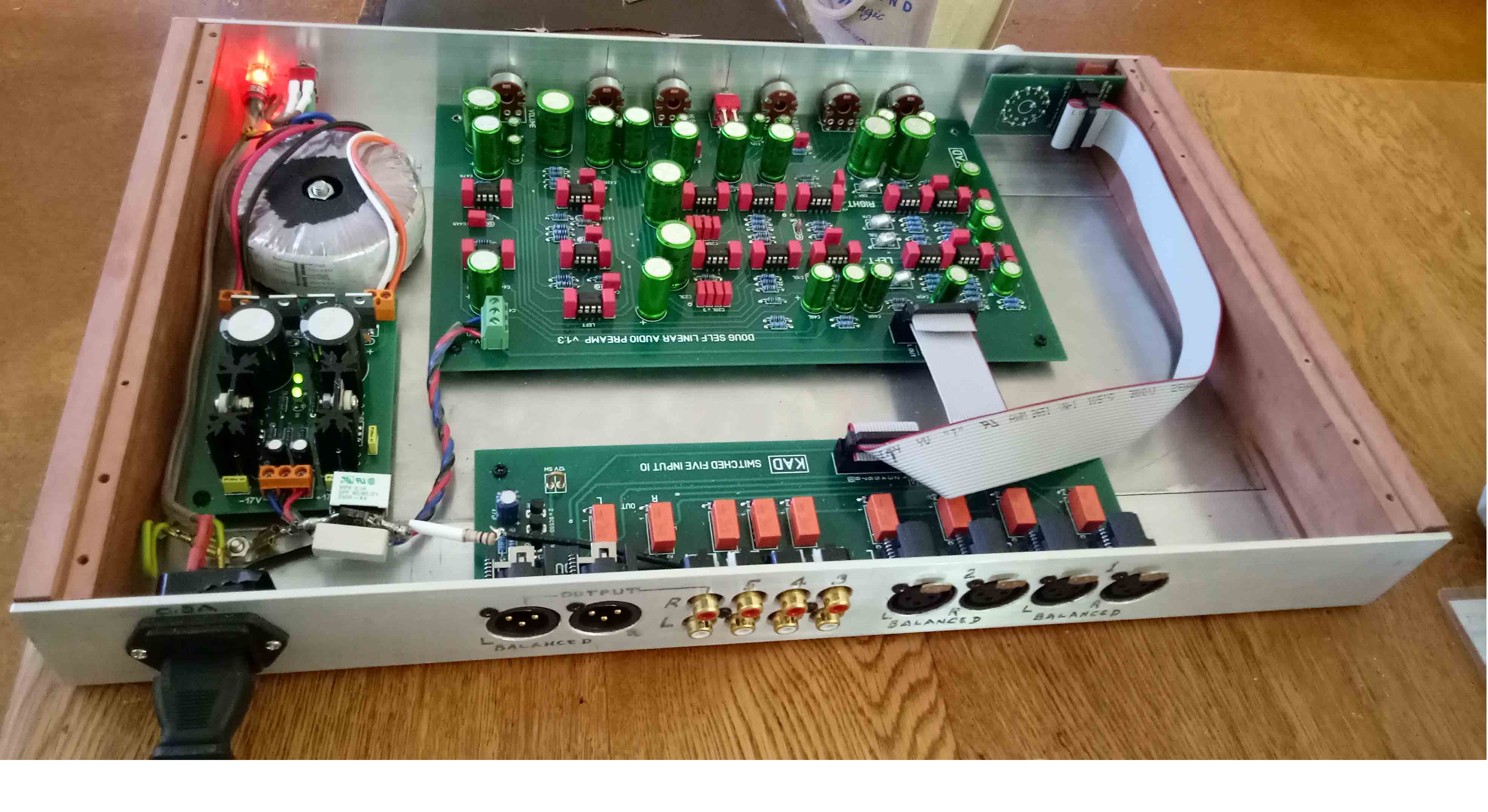

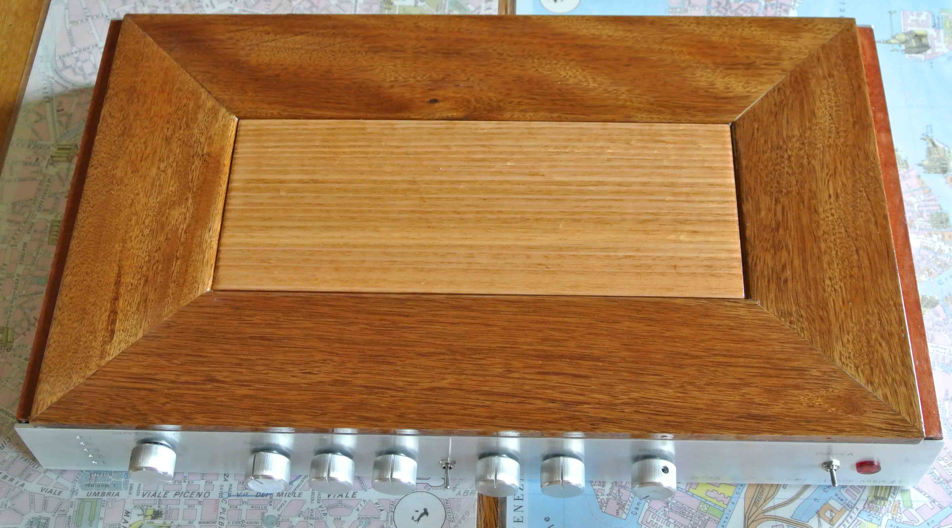

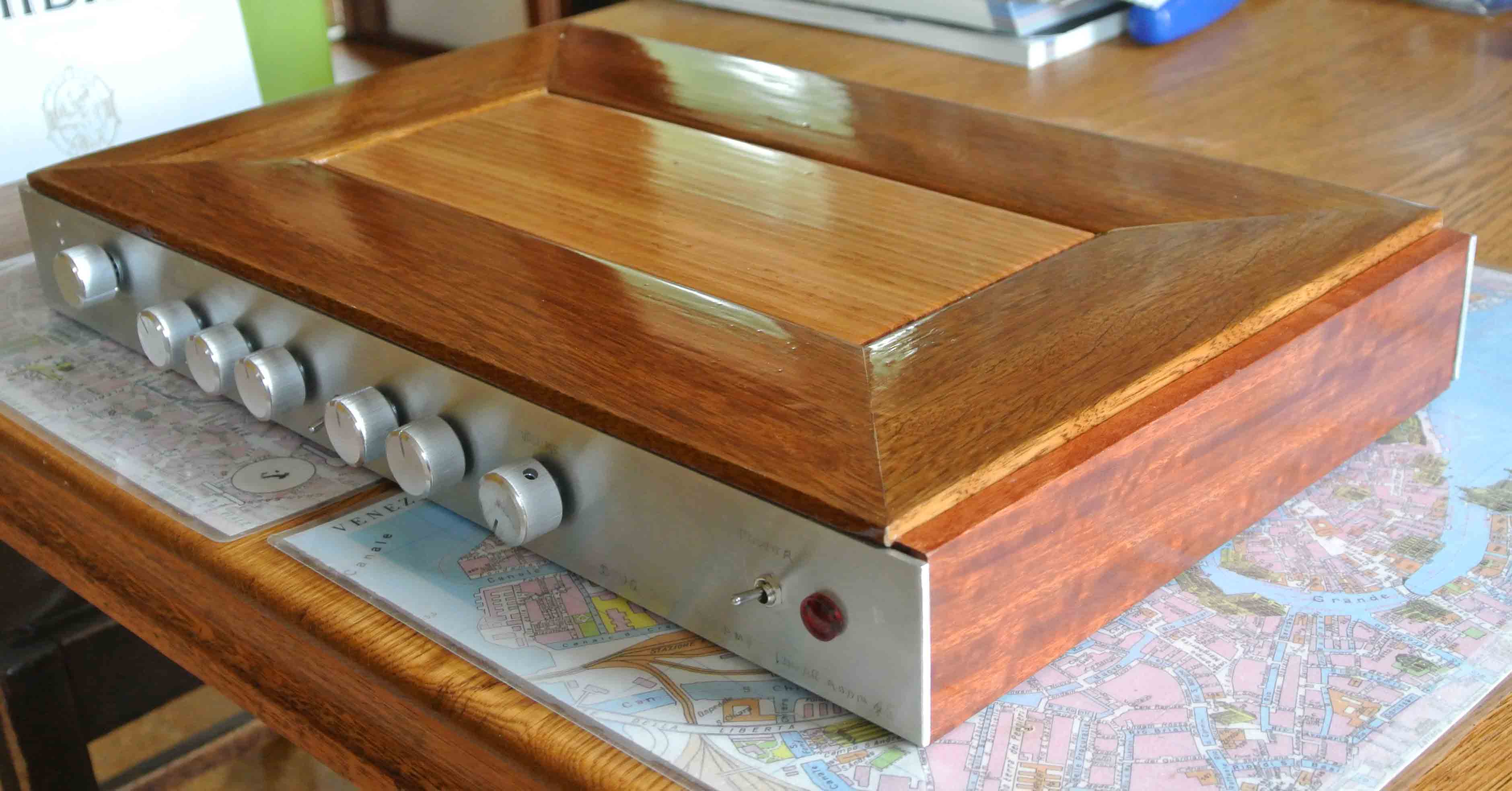

And now adding pictures of the completed enclosure. Still no front panel markings. I am very pleased with this new piece of gear. It goes beautifully with my Salas Simplistic phono amp, so quiet and so clear. Joyce di Donato never sounded so good.
Graeme

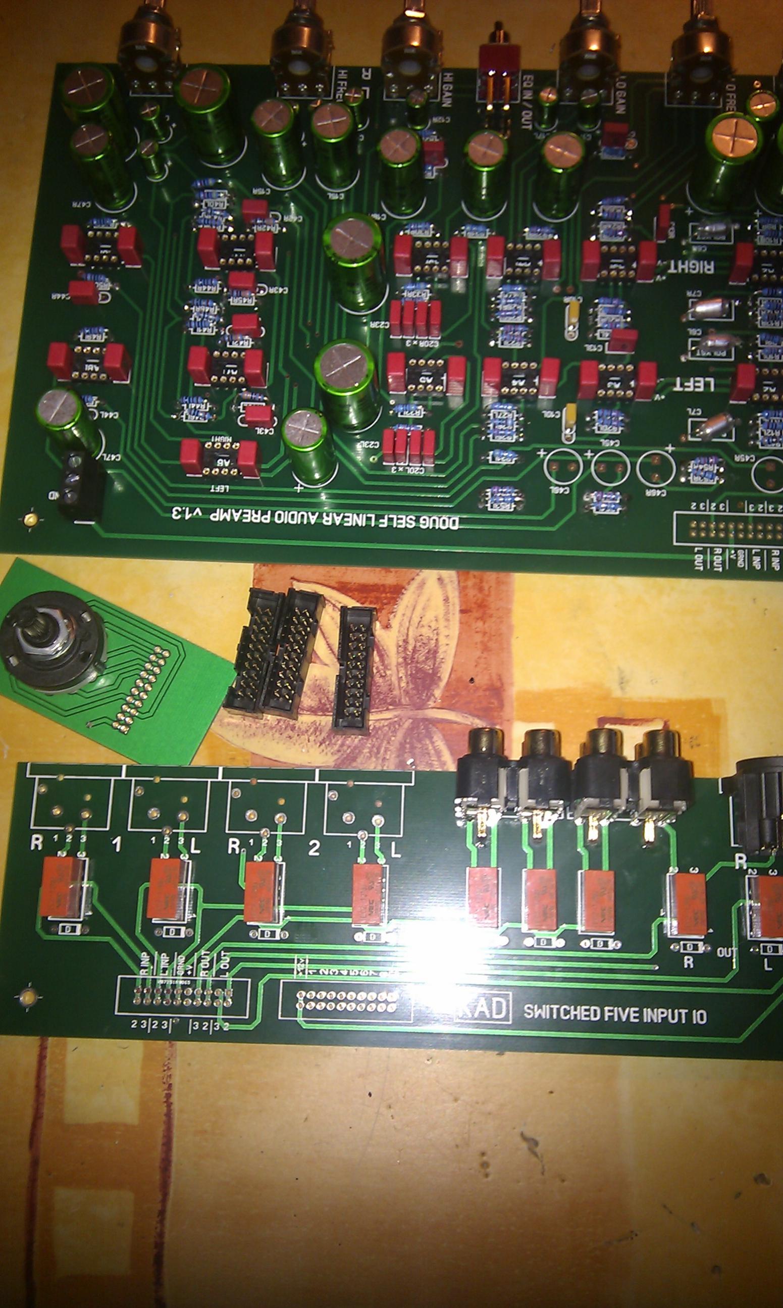

I'm going to switch on the Douglas Amp pre but I'm nott sure of what I am doing with the I/O board powersupply !
So I need a little advise please.
I use single inded inputt and outputt : do I need to short the plug with a wire as I saw in some post or do I need to power it with the 17 V from the power supply board (or from the plug of the main board? ) ?
My understanding is this powersupply on the I/O pcb is a delay, but dunno when it is usefull or not and if this is for the balanced output only ?
Thank you in advance for your help,
