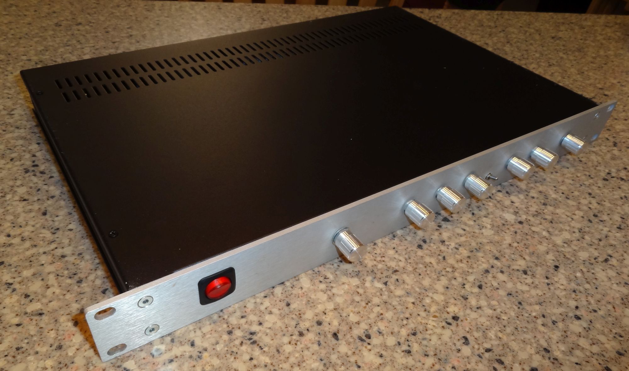

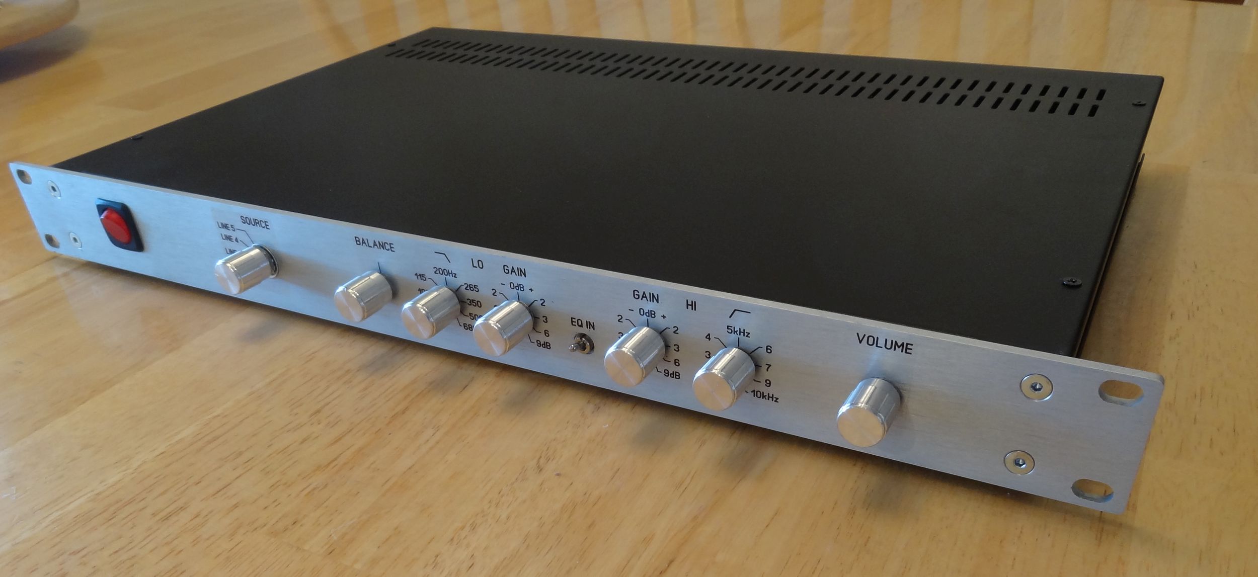

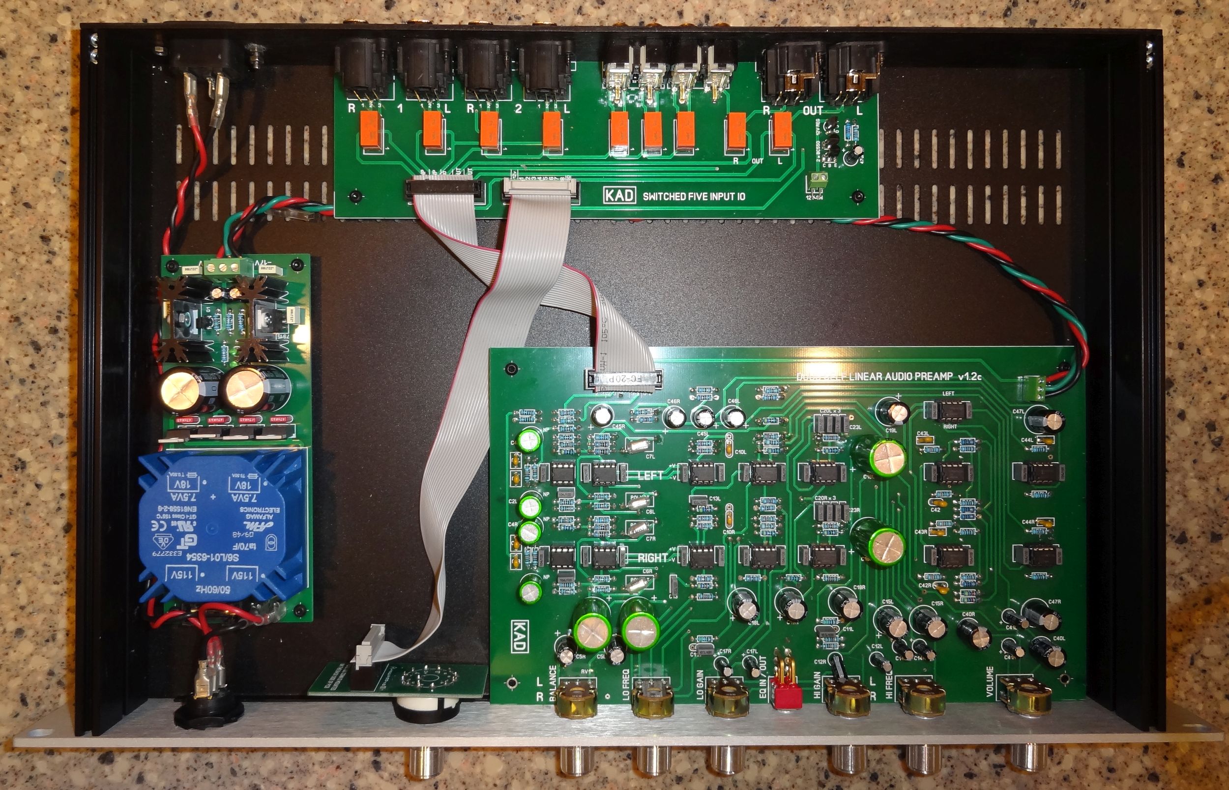

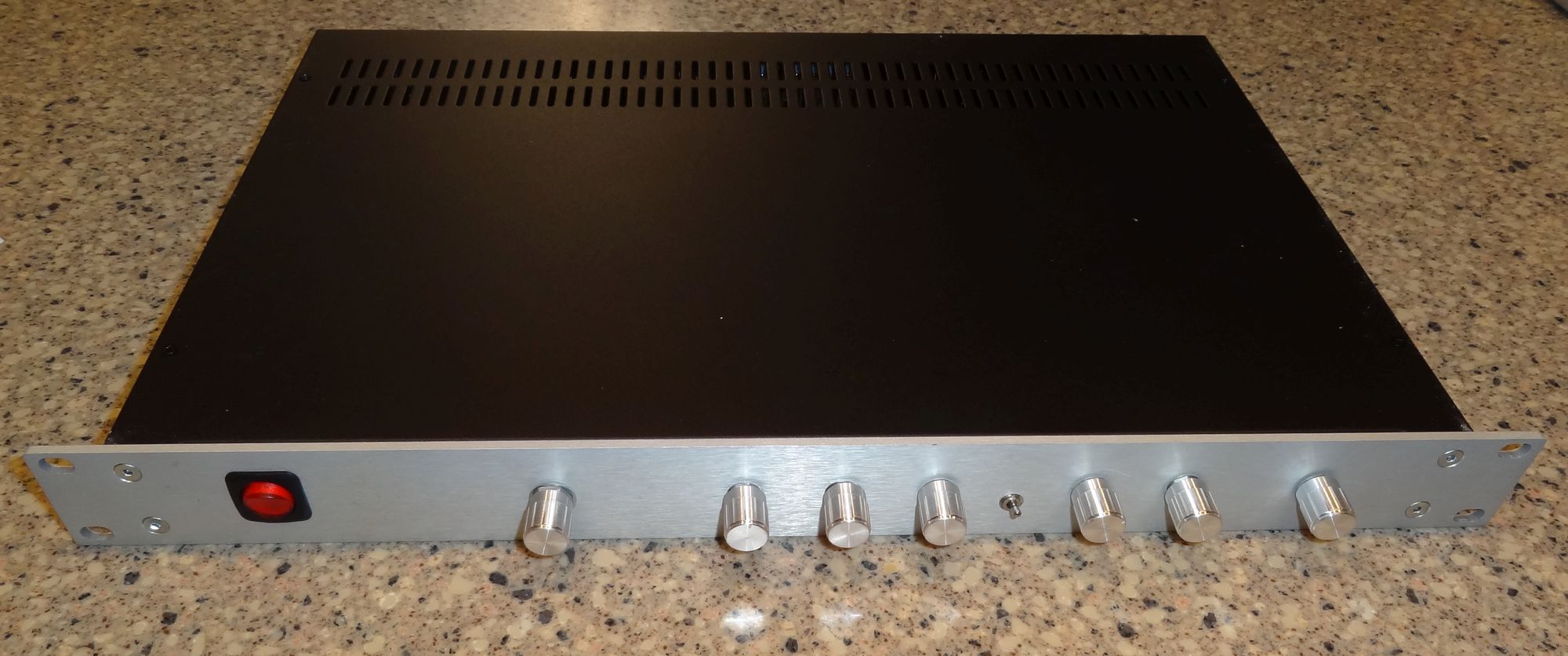

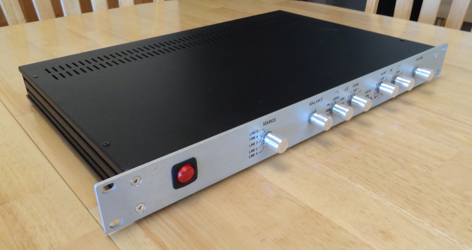

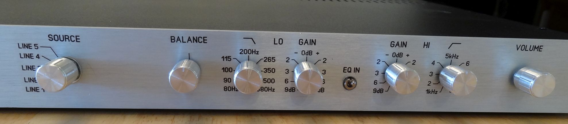

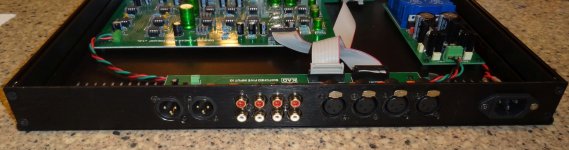

Well I finally boxed it up. First thing that I installed in a case in over a year. I bought the Slimline 1U case from the DIYaudio store. 280mm deep. I still have to devise a label for the front. I was going to use water slide but the front panel is brushed and I'm not sure how well a decal will stick to it.
I made a mistake when I laid out the back panel and drilled it the opposite of what I had intended, so the PSU ended up on the left side of the case. I wanted it on the right so the controls would have been more centered. Everything works fine as is I just would have preferred it the other way. The only thing bolted down is the PSU. The other boards are held in place by the front and rear panels. The stand-offs are there to prevent the boards from somehow touching the bottom cover.
Here are some pictures for your enjoyment.
Blessings, Terry
Blessings, Terry

That looks really, really good Terry. Congrats!
Looking GOOD Terry. Also, i believe the waterslide decals would look good on that front panel. You can always do a test on the backside it.
Rick
