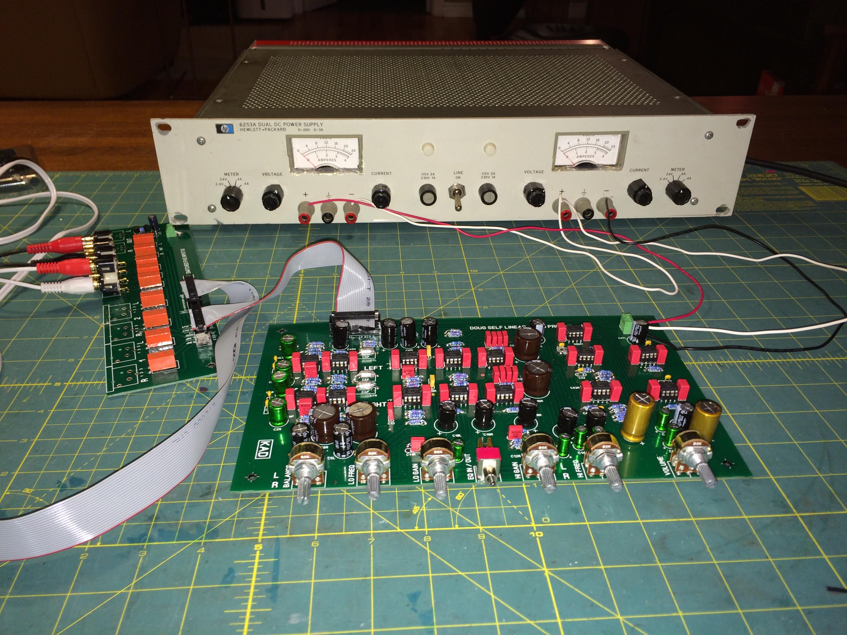

thanks Doug. i dont have a dual bench supply, but am going to try to borrow one. i am also thinking the problem may be there. will keep you posted
no luck. i got hold of a bench supply and still have same noise.
at this point, i assume i have a bad joint and need to start reflowing connections.

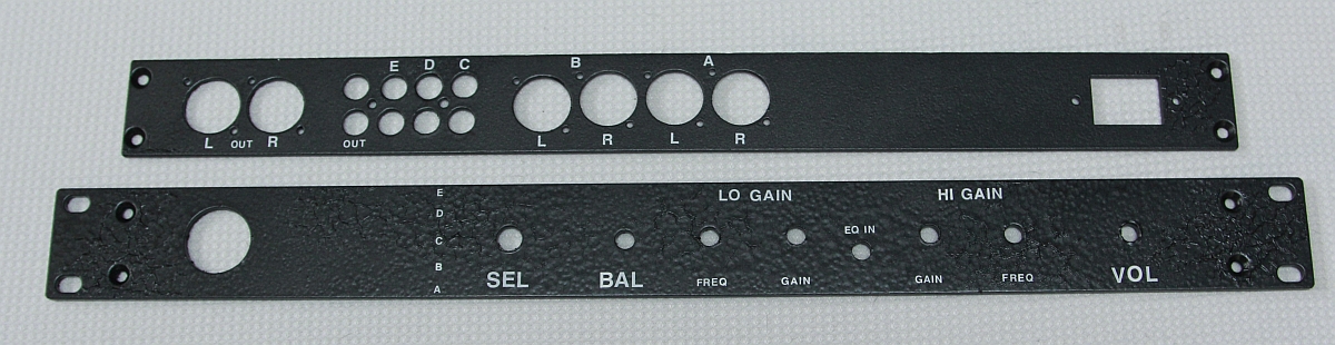

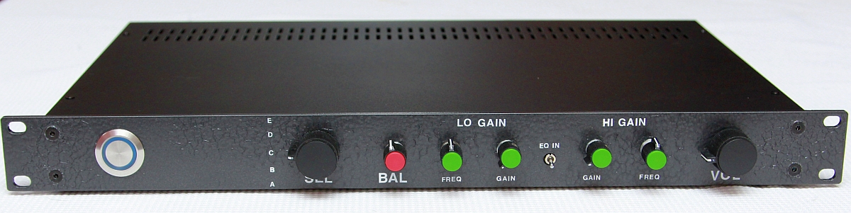

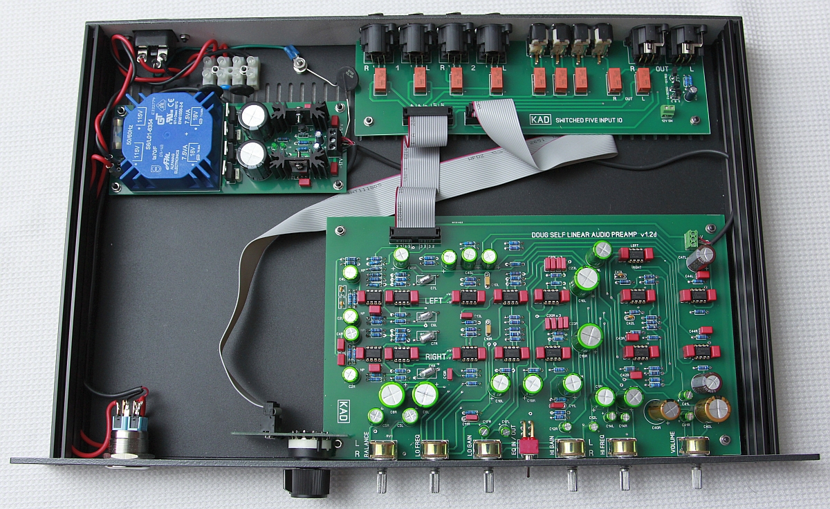

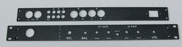

Well I finally finished the case work, the preamp has been completed for several weeks. I hate drilling holes and matching everything to fit, not my cup of tea. Same goes with the lettering.
Any rate, I used one of the DIY store supplied cases, a single 1U Slimline. Works well. Next time I believe I would have someone like FrontPanel Express handle the holes and lettering.
My current setup for the past 18 months has been a Pass BA-3 into a Pass F4 amp. The amplification duty is sometimes shared with a Pass F6. As I write this I am listening to the DS pre into the F4. No noise, extremely quiet. The low end is outstanding. Since the BA-3 has no tone controls I am using the DS pre without the EQ at the moment. Sound stage is excellent along with the detail. Definitely a keeper. To my ear the Pass BA-3 has a fuller somewhat fatter sound, but either pre would do the amplifier well.

Thank you very much. I think I spent as much time on the case work and lettering as I did on building the preamp!!.
The lettering is dry transfer. The company is in the Netherlands, but Amazon is your friend. White Gothic letters by Woodland Scenic. About $9 a sheet. Buy two because you will run out of some letters or like me damage them while they are in place. There are other vendors. Just search for "dry transfer letters", plenty of choices.
