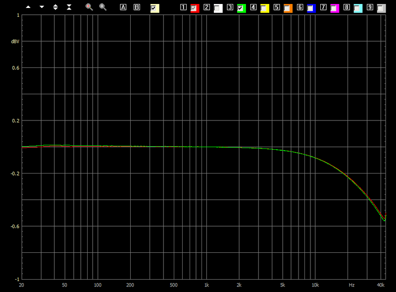

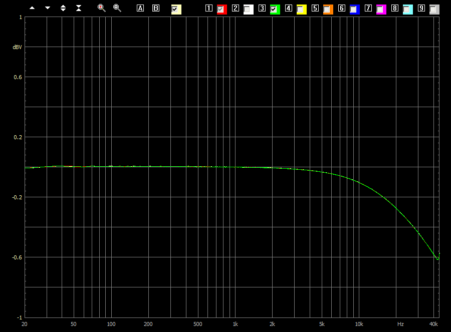

Tone control : when the pots are set to get a flat response, there was no significant level difference(about 0.01 dB or less) when on or off.
Here are the diagrams. Level full scale at +/- 1 dB
07. level with tone control flat, off and on, right channel
tone control, off -> red
tone control, on -> green
08. level with tone control flat, off and on, left channel

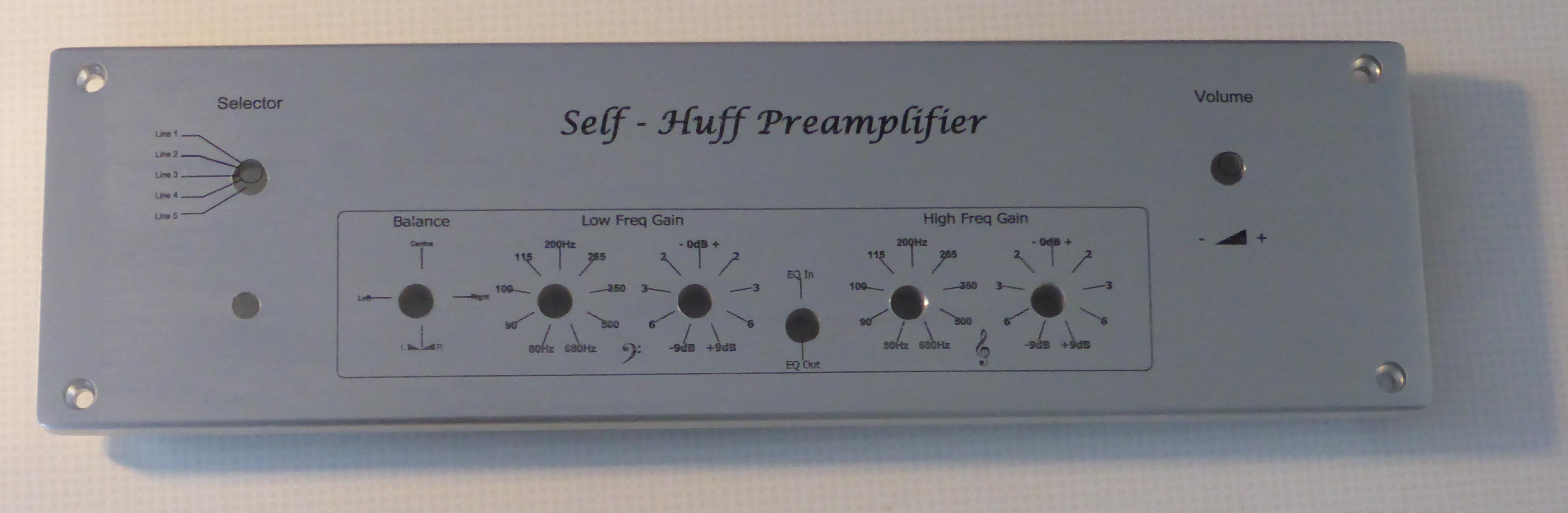

Front panel
Well, if anyone is still following this thread, I finally finished my front panel. Not perfect, but not too bad.
It was all done with a single transfer from CraftyComputerPaper at Frequently Asked Questions
Alignments are not perfect but we shall see. It is easy to remove and repeat. One small issue is that the transfer material can stretch slightly and this can make alignment a little tricky...that's my excuse anyway🙂

Transfer paper
George,
I am still working on my case as well. i am going to try this product on my Wood case.
Waterslide Decal Paper, Image, Transfer Paper, Iron On, Decals
failing that i will try what you used. 🙂
Rick
Hi Rick,
Let me know how that goes.
The only problem with the method I used is that the edge of the transparent film is just visible to the left and right of the panel. That was why I used one large decal..fewer edges to worry about. The best solution would be something that transferred just the text and used no film. Still, with a couple of sprays of clear varnish the edges are nearly invisible
