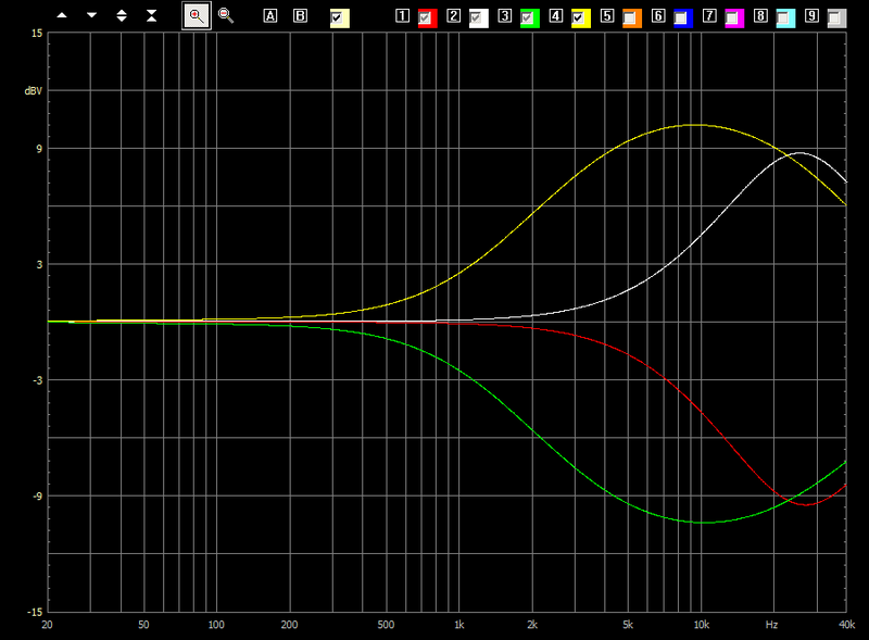

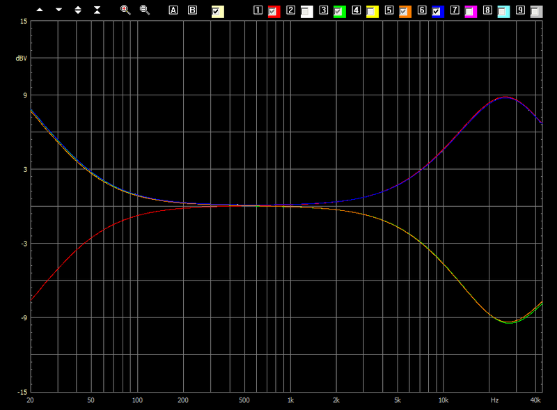

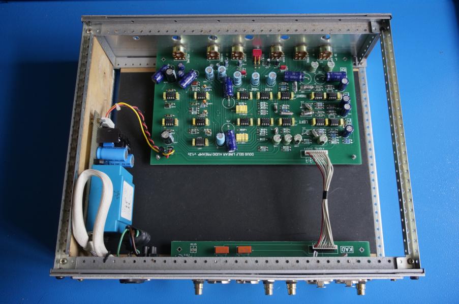

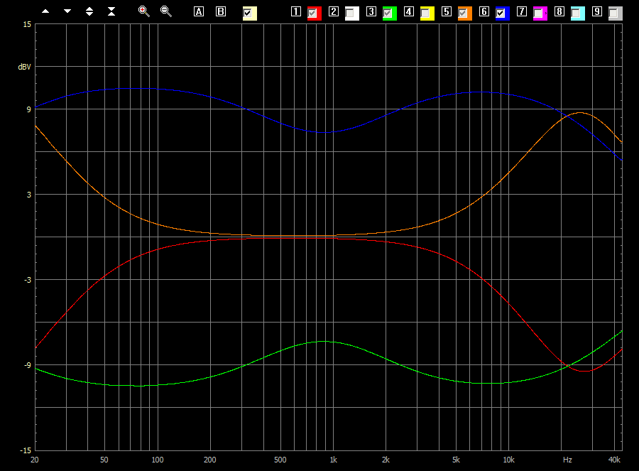

Almost finished, already working all right from the point of view of measures.
The case comes from my junk box, the front face, full of holes, needs cosmetic surgery.
Checking that everything was OK was a good opportunity to familiarize myself with Clio Pocket I purchased some time ago.
Self preamplifier,
'A low-noise preamplifier with variable frequency tone controls'
Linear Audio, volume 5, 2013-04
PCB by Carl Huff, built and measured by Forr
2016-06-07
input signal 1 Vrms
R = Right, L = Left

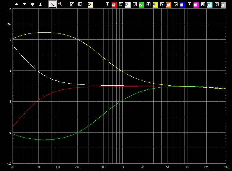

TONE CONTROL
01. extreme frequencies and gains
bass lowest frequency, -10 dB -> red
bass lowest frequency, +10 dB -> white
bass central frequency, -10 dB -> green
bass central frequency, +10 dB -> yellow
02. central frequencies, extreme gains
treble highest frequency, -10 dB gain -> red
treble highest frequency, +10 dB -> white
treble central frequency, -10 dB -> green
treble central frequency, +10 dB -> yellow
03. central and extreme frequencies, extreme gains
bass lowest frequency, -10 dB +
treble highest frequency, -10 dB -> red
bass lowest frequency, +10 dB +
treble highest frequency, +10 dB -> orange
bass central frequency, -10 dB +
bass central frequency, +10 dB +
treble central frequency, +10 dB -> blue

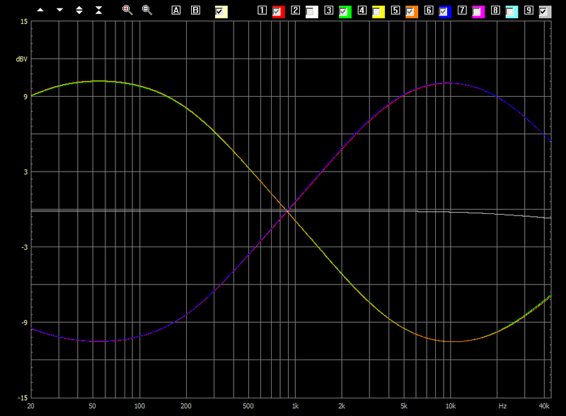

04. comparison between channels, central frequencies, extreme gains
treble central frequency, +10 dB R -> red
treble central frequency, +10 dB L -> blue
bass highest frequency, +10 dB +
treble lowest frequency, -10 dB R -> green
treble lowest frequency, -10 dB L -> orange
05. comparison between channels, extreme frequencies, extreme gains
treble highest frequency, +10 dB R -> red
treble highest frequency, -10 dB L -> blue
treble highest frequency, -10 dB R -> green
treble highest frequency, -10 dB L -> orange

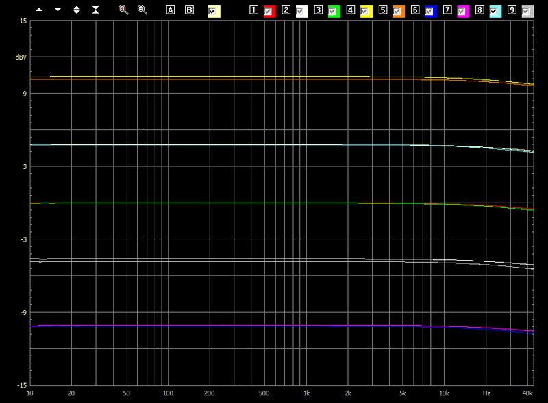

VOLUME CONTROL
06. level differences between channels at various volume settings
tone controls off
+10.2 R -> orange
L -> yellow
+4.8 dB R -> white
L -> sky blue
0.0 dB R -> red
L -> green
-4.8 db R -> white
L -> grey
-10.2 dB R -> purple
L -> blue
Tone control : when the pots are set to get a flat response, there was no significant level difference(about 0.01 dB or less) when on or off.

Nice job forr. Thank you!
And Kudos to Doug Self for making this available to the DIY community.
