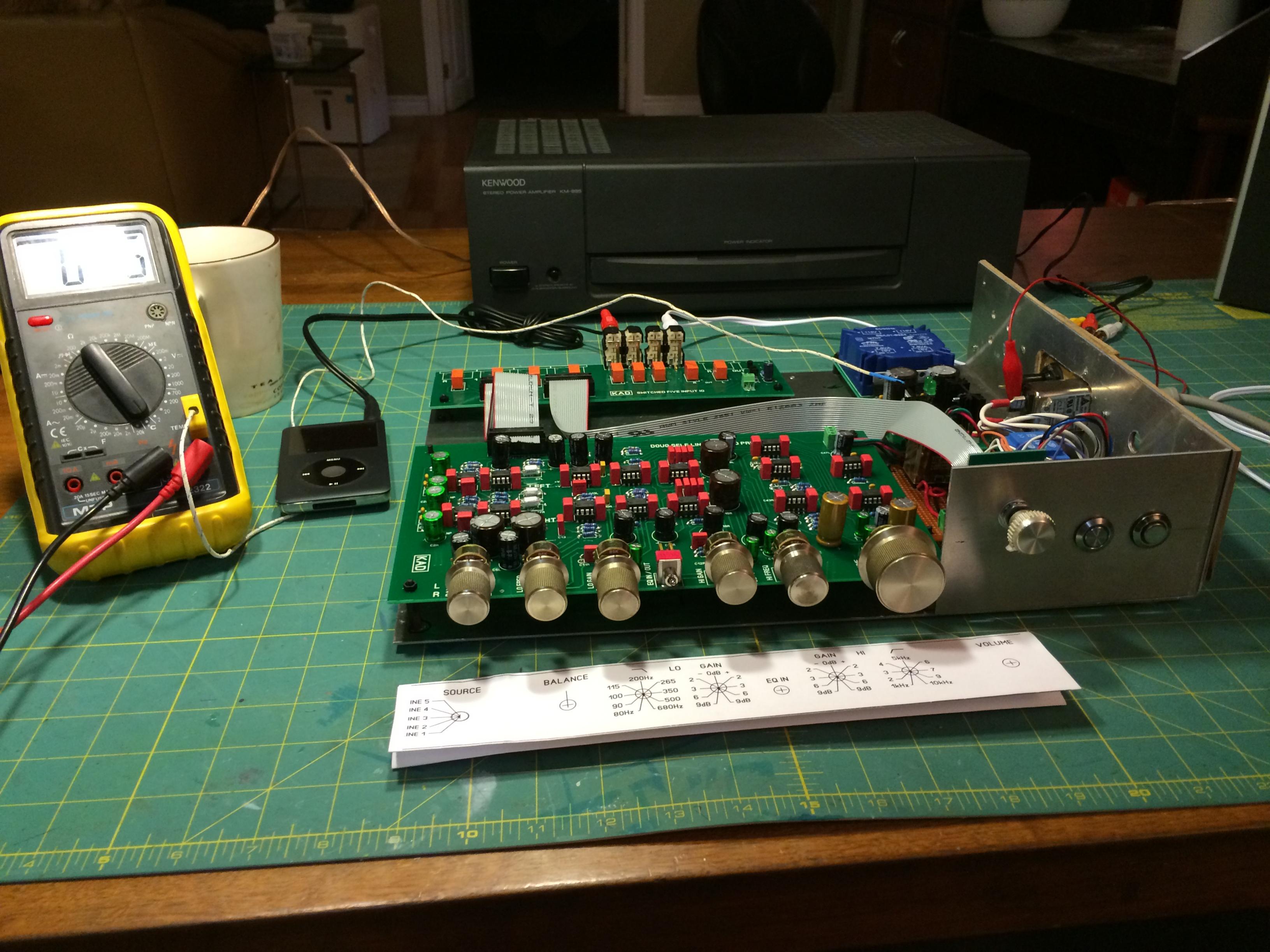

Finally done ! I received the last ribbon cable that I was waiting on and managed to hook everything up and give it a short test last night in my garage workshop system. My first impressions are very favorable, very clean and clear, low noise with big sound stage. Tonight I'll hook it up to a decent system and burn it in for a while and give it a hard listen. I'll be swapping out an Aikido pre to do a comparison on my F6 amp feeding a pair of Jordan JX92s back horns which is a pretty revealing combo.
Paul
Paul
Ok, burned it in for only a few hours and gave it a hard listen last night. Love the convenience of all of the controls, especially the balance control, and the multiple inputs. Very practical preamp. The tone controls were fun to play with, but I didn't really need them in my room. Really impressive imaging, wide, layered sound stage. Very precise, neutral sound. It didn't kill my Aikido however, the two preamps did sounded different, the Self pre seemed a little dryer than the Aikido. The Aikido seemed a little (very little) blacker in the background and the note decays seemed more sustained. I did play with the tone controls to try and match the Aikido and came close to the tonality. The self pre is certainly a great sounding more flexible piece of gear. I'm leaving it in for a while to let it settle and get used to it.

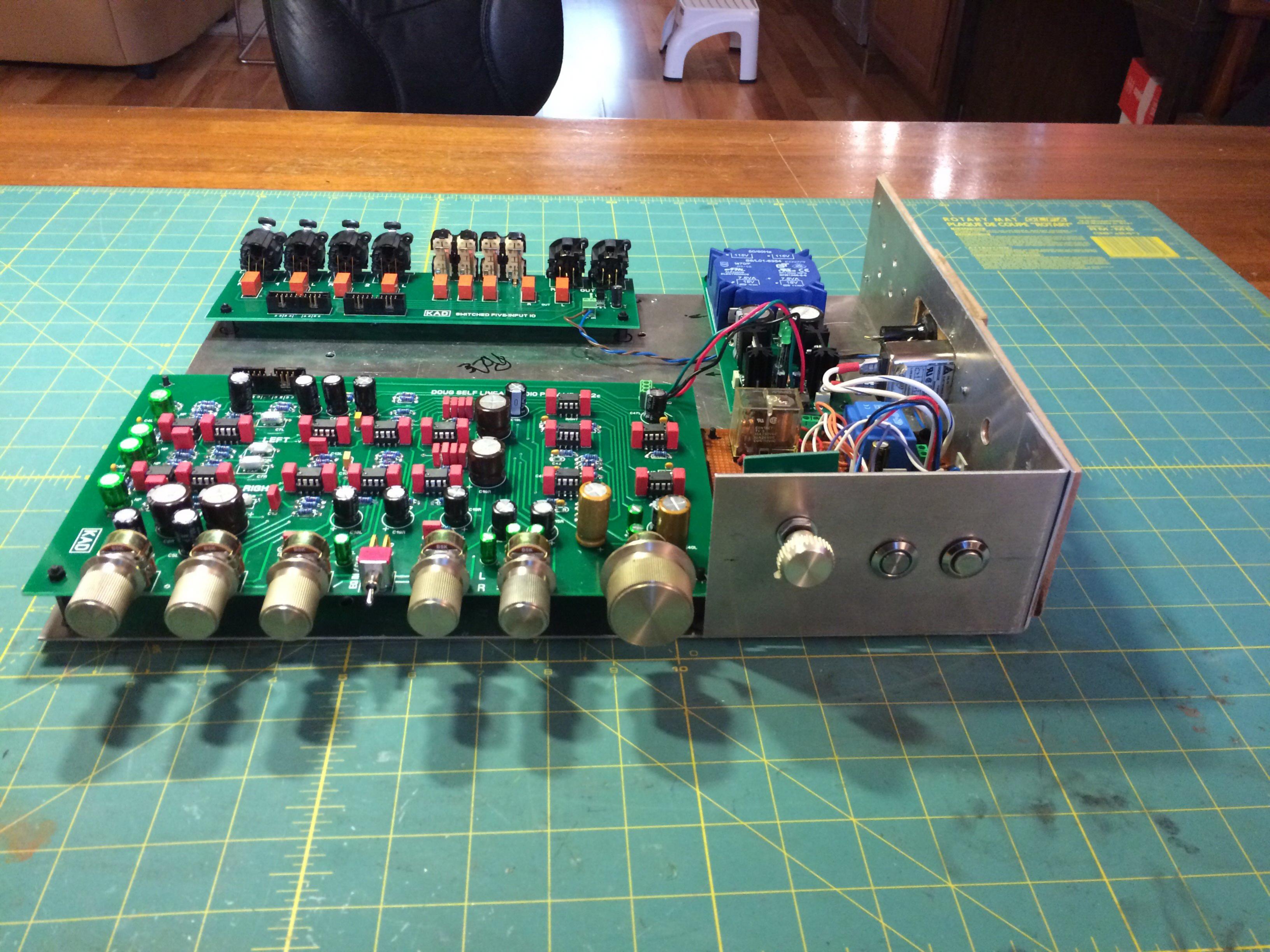

Good evening,
Yesterday I have received remaining capacitors, and completed soldering pre-amplifier.
All work as a charm, no issues at powering, left burning over night.
Listening at the moment, impressive, wide stage, and a lot of options to adjust the sound you would like.
Need to start thinking about enclosure for it.

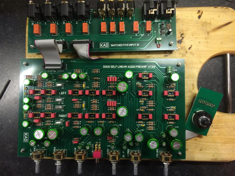

I almost forgot, thanks Doug, I got my PCB's!
I just noticed (before posting) that my PCB version is a V1.2 instead of a V1.2d. Out of curiosity, what are the differences?
Versioning is all under my control. There have been 3 versions of the main board. The earliest version had two extra resistors per channel that were deemed to be not needed. Later versions improved the board layout for ease of assembly and aesthetics. However overall performance and parts used are identical across all versions.
sockets for the op-amps
Hello All,
I notice in the photos that some builders are using sockets for the op-amps. What is the object of the sockets? Is there a thought of rolling in another part?

i got the ribbon cables today and powered up the unit. sounds great, but i have a hum/buzz. it is not there with zero volume and quite loud at full volume. it gets noticeably worse if i touch the ribbon cable connecting the main board to the IO board.
also, the heat sinks on the power supply seem to run very warm. they seemed to max out at about 55C. is this normal?

i looked at the board and did not see anything, bit i need to go over it again with a magnifier. i also need to look at the power supply board itself. i am getting +/-16.5v. does this indicate a problem.?
Nope, +/-16.5 volts is a good voltage. I would be looking hard at your ribbon cable.
i checked all the joints and can find no bridges. i checked the 20 pin connector with the meter and could not find any issues there either.
the amp is drawing .2A on the V+ terminal and .15A on V-
the ribbon cable seems ok, but i have ordered replacement as i cant find anything else
i checked all the joints and can find no bridges ...
That current draw is at high end. The prototype and first articles that I built all draw 165 ma. I see that you used sockets for the op amps. Each op amp pair draws roughly 10 to 15 milliamps and this circuit uses 15 of them. I invite you to pull all of the op amps and replace them one by one while watching current draw. The current should jump up no more than 15 ma for each op amp added into the circuit. Be sure to shut the power off before plugging in the next op amp. Doing this will at least give you an idea of where the problem most likely is on your board. Once you have found the region causing the high current draw, double check to be sure that the right value resistors are in place. A bad op amp could be causing the problem as well.
