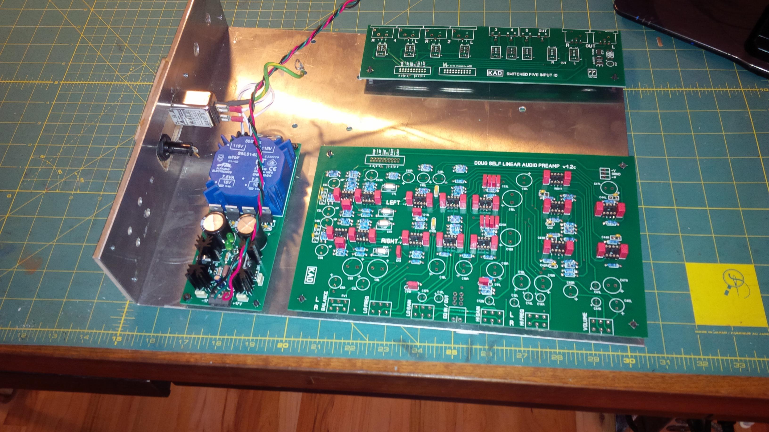

I reduced the length of the front panel drill template so it fits on an 8 1/2 x 11 paper. I also made a drill template for the 5 channel rear template. I did drill a panel based on the template and it seems to fit but one of you may want to test it for yourself before you have a panel made. The line represents the bottom of the PCB not the edge of the panel.

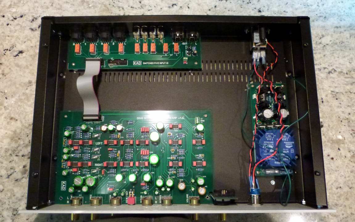

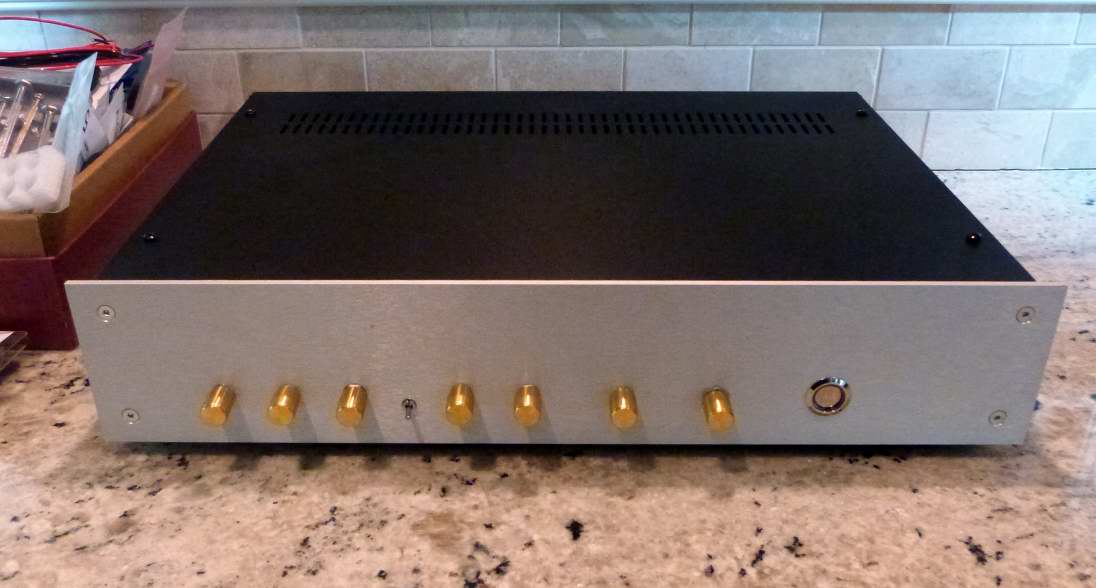

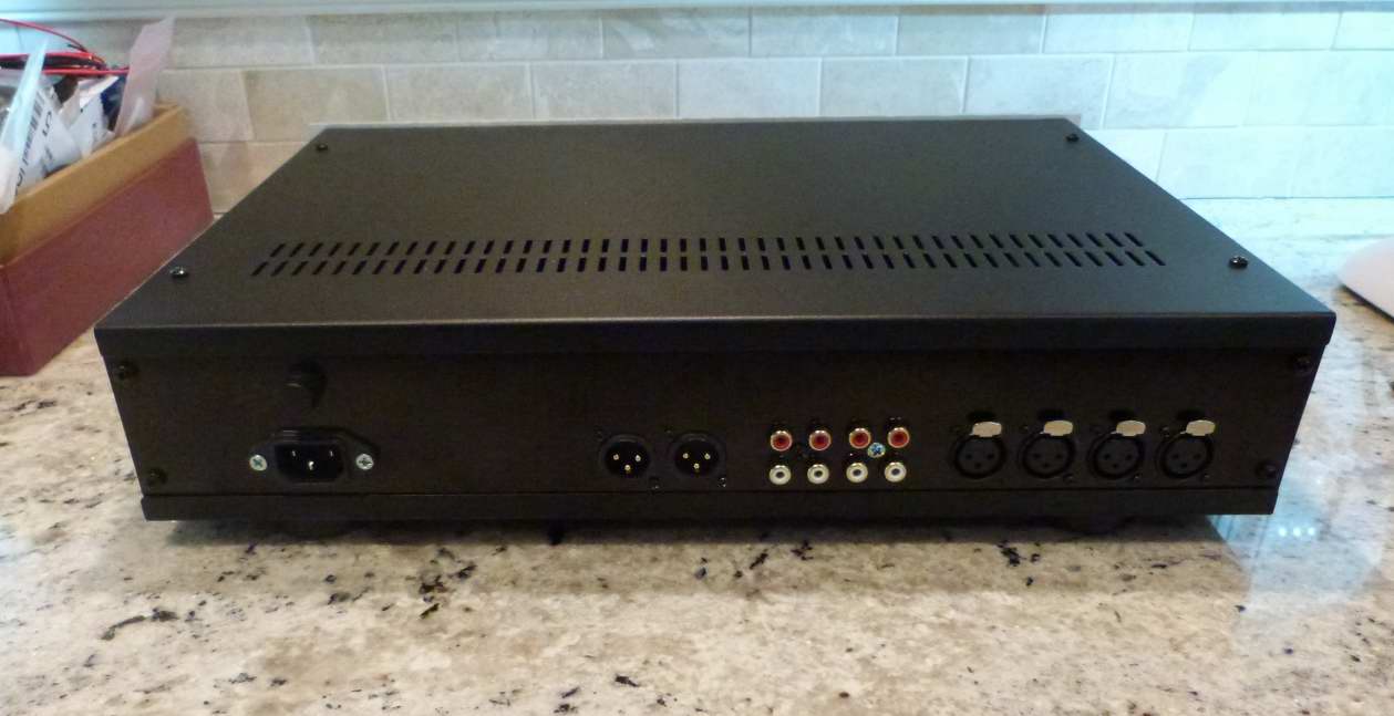

Almost done, waiting on a ribbon coming in the mail to try out. Here are a few pics of the pre in a pesante 2U chassis from the DIY store. I hand made templates for the front and rear out of paper and did the cutouts with various drill bit sizes and hand files. The rear cutouts were a real challenge, I hate working with steel, aluminum is so much easier. I'm planning to print the front panel graphic on a clear plastic transparency and paste it over the knobs. I don't know if I like the gold knobs but they were cheap, might try some silver or black ones. Tried out the PSU works like a charm, can't wait to give it a listen.

2U case dimensions are H ~3.15", W ~ 17", D~11.8". Heavy steel construction, for 70 bucks delivered with no shipping (in US) it is a great deal.

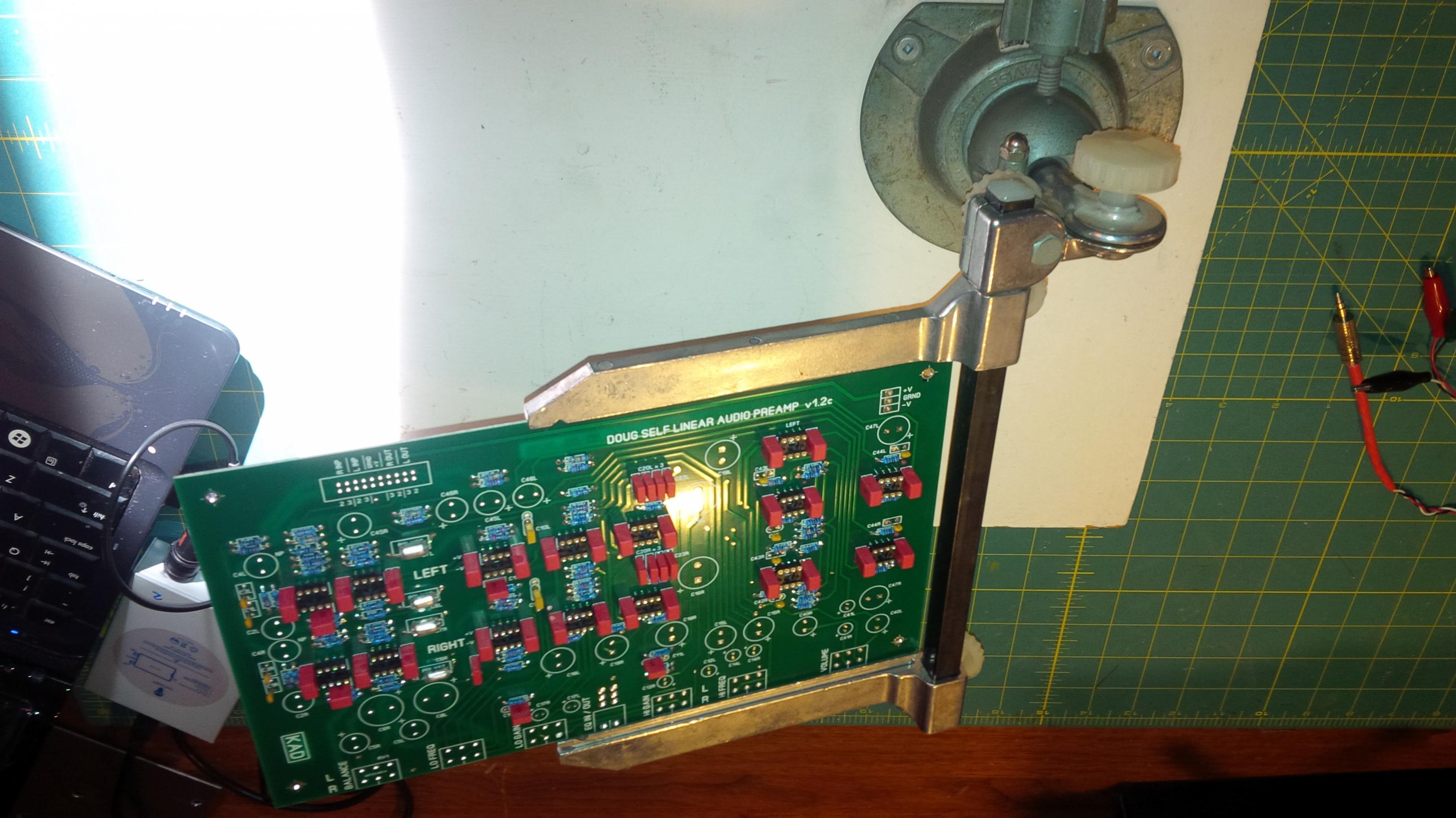

Yeah, I finally have my working on the bench. Very nice and a thank you to Doug and Carl for making it happen.
Just playing MP3s through a Fostex, barely ok. My plan is to use this as the front end to a F6 I have ready.
Just need to complete the cabinet.

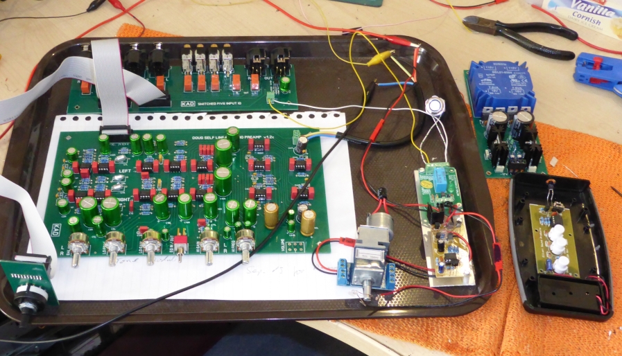

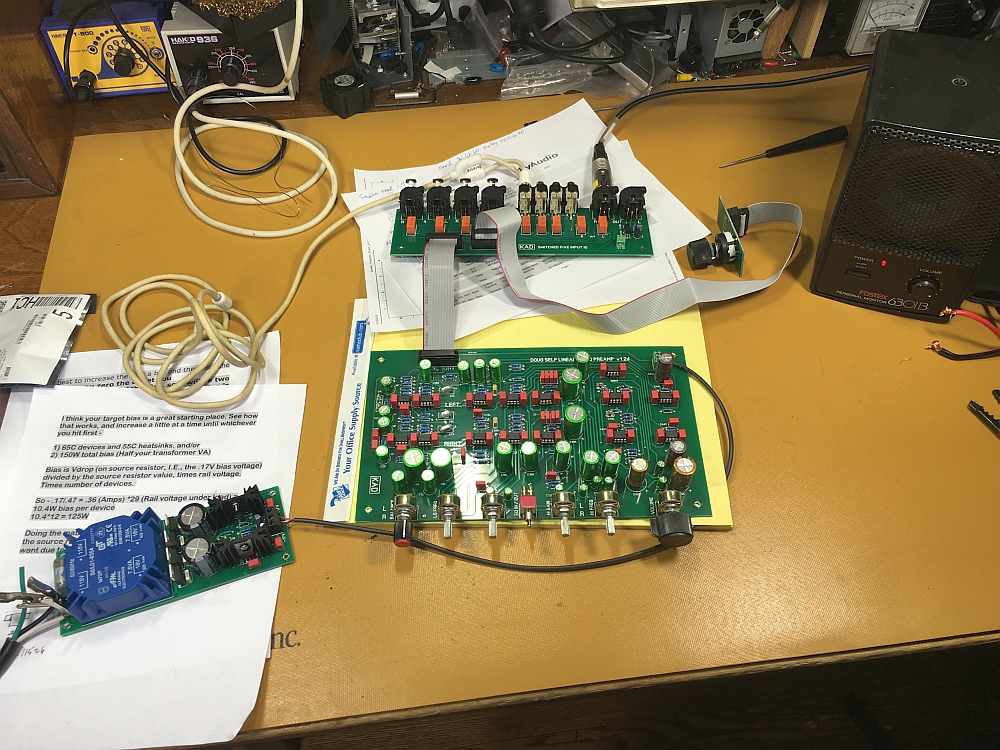

As there was some interest in the remote setup that I made I thought that I would show some photos.
On the large photo you can see the main PCB with the new IO board connected, as well as the selector.
On the right .. just out of site is the PS. I did not use this in the test setup as I wanted to keep the mains power out of all the wires. I am testing with a bench PS.

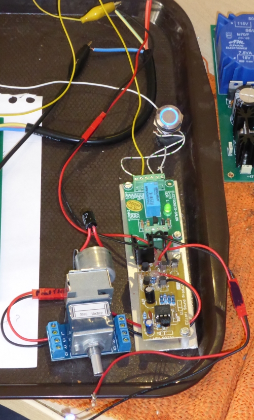

The volume control is an Alps mounted on a small PCB with screw connectors (not yet connected to the main board). The two small boards to the right are (1) the remote receiver and (2) a small board to mount the relay. The remote board controls the volume and mute. The relay makes/breaks the 12V connection on the IO board thus muting the system. I wanted to show that the system is in mute mode and the LEDs in the chromium switch (above the relay board) needs 12V, so I connected its LED across the 12V terminal on the OP board. Thus, when muted (open circuit), the LED glows. Pressing the button also sets muting, so I have local and remote muting setting. The button overrides the remote muting.
I also wanted to use the same kind of switch to control power on/off from the front panel. Conveniently the Selector has a 12V supply that can be used to power the on/off LED. All of this is because tests (so far) have shown the 5V available from the remote receiver board to be insufficient for the LEDs .
The Alps volume pot is bulky and for access needs to be mounted to one side of the main PCB. So, the final layout will be with the Selector far left, volume far right, mute and on/off centre, low down, and the pots on the main PCB centre, high up. The IR receiver aperture will be where ever I can conveniently position it. Hence the need for a 2U case.
The second photo shows a little more detail of the remote receiver and the relay mount. The relay PCB was purchased complete (China!) for around £5 including postage and just provides a robust and tidy mount for the relay and its connections. It needed a little modification so that it could be driven directly by the receiver mute feature but so far has worked perfectly.
Any questions , just ask
