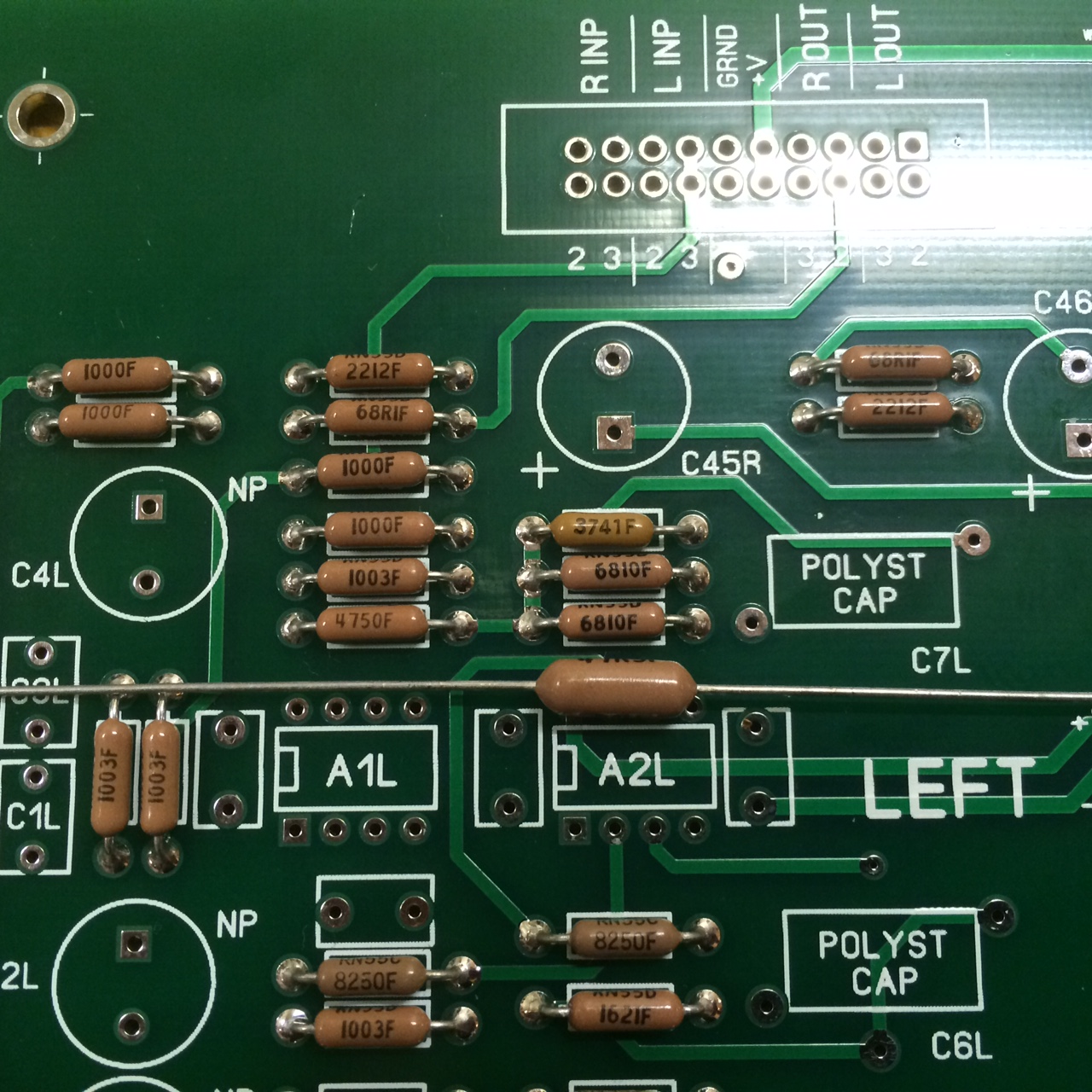

Will they fit the PCB’s?
Hello Builders,
Will Vishay Dale RN60 resistors fit these PCB’s. They are mil-spec ¼ watt resistors, larger than the typical ¼ resistor. These are 0.344 +- 0.031 inches ~ 3/8 of an inch.
I have most required values in stock. Will they fit the PCB’s?

Hello Builders,

Hi DT,
Unfortunately Dale RN60 slightly to big, but Dale RN55D will fit.
