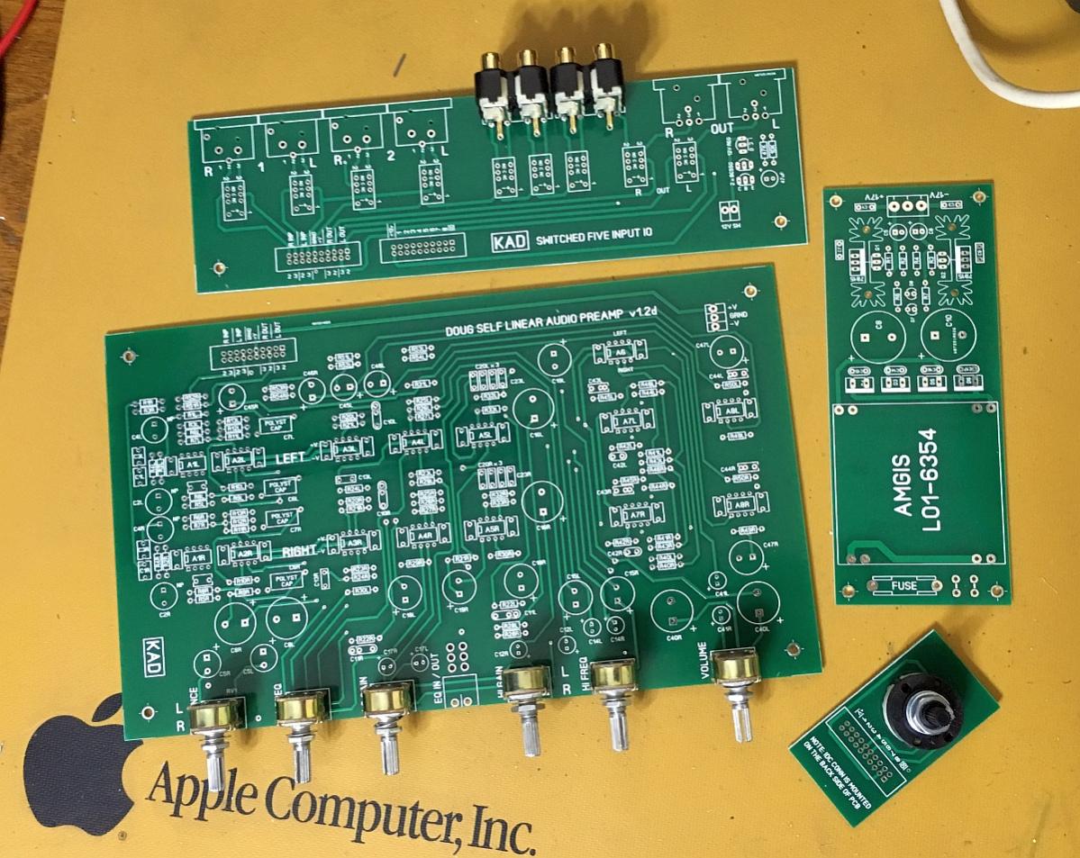

And finally ...
This is a PIC of the MUTE DELAY ON circuit. It is identical to the one on the previous IO board. The capacitor determines the delay ON time. A 47uF cap will give a 3 second delay and is usually sufficient. However the time delay ON can be extended to 5 seconds (approximately) by using a 100uF capacitor.
That's it for now! I will post a BOM and schematic soon.
NOTE IN THE ABOVE PIC ...
The terminal block marked '12v SW' must be shorted for the IO to turn on. The terminal block is there for those builders that want to add a standby switch. If you have no interest in that feature a builder could simply solder a leftover resistor lead in the PCB holes provided for the terminal block.

Hi Carl,
Since you did the layout, can you provide a drill layout for the new rear panel as well?
Hi Carl,
I will. That's on my 'To Do' list Terry.

Sorry Paul,
But I don't see where you are getting those parts callouts. There are only 2 resistors on the enhanced IO board. One is 10K and the other 47K.

I am excited about this preamp build. I have ordered all of the parts, including the kit cost from Carl, the total is about 300usd. Still need a case, knobs, related hardware. Since there is a lot of holes need for the pots and other connectors, if anyone has thoughts, template or other ideas that would be great. I am thinking about using Frontpanel Express, though figuring out dimensions for drilling is not my strong suit.
