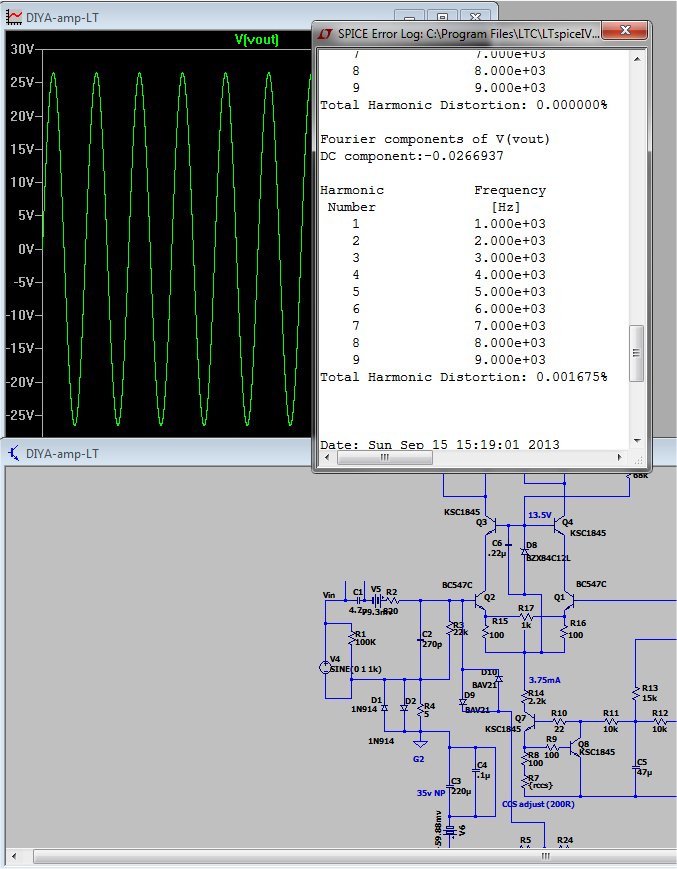

Take a look at my attachment, does it look somewhat correct? What value would you recommend for R19 at 80v?
I used this amp almost for a month earlier, and is now waiting for me to complete the cabinet for it. Ive fitted the honey badger with 4 pairs of outputs instead of 3. It seems to work pretty good, except i get some banging in my speaker when i reach high sound levels with much peaks of bass, and after i saw the posts these latest days, i though maybe that could be the cause for the bangs. Other than this, honey badger rocks with 4 outputs.
Are you running with Plus/Minus 80 rails? WOW 😀
Here's the basic thing. Values aren't shown because it's not one-size-fits-all. I suggest using low-capacitance schottkeys. Some diodes actually have too low voltage drop and leakage is too large in this position, I think the 1N5817 is an example (but I think that has too much capacitance anyways).
Tried it , your right ... not any diode - you must use a VERY low reverse leakage
device or distortion increases a hundred-fold (NO 😡 1N4148/914).
Cod3gen's model , my MUR models, or my NPX diode model show almost no increase in distortion.
When you overdrive ,it is not asymmetrical , and it will clip before saturation.
It could be useful for "throttling" a sub amp (as dan says). Wherever you put
a diode in this amp's signal path , it better be a good (exceptional) one. 😱

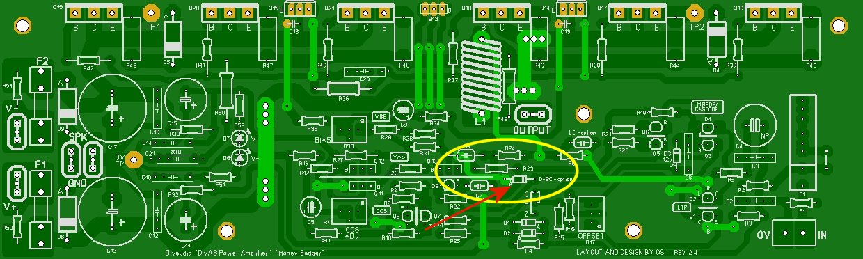

I explained I wanted to run the output (the final V2.4) - through the forum to look for mistakes and to verify the addition of the baker clamp diode.
Below is the Sprint output as it is. I have added the clamp diode , it is designated as "D-BC-option" (circled in yellow).
Q10's output trace only crosses low impedance traces , the emitter resistor of Q10 (R23) and the TMC feedback trace (where C7-8 and R24 meet) ... also low impedance - as it is the main output > R24.
The Diode (D-BC-option) jumps the regulated V+ rail to the base of Q9. So , we have the V+ separating low and high imp. .... UNLESS Q10 saturates.
With the best diode (very low reverse leakage) one should not realize the diode's effect during normal use.
An SMD device could be used on the topside of the board with a little skill at soldering wires on the device.
I decided to not use SMD pads to keep the base trace of Q9 "clean" and separated from the VAS by the V+ trace.
Any comments and suggestions are HIGHLY welcome - this amp is for the community.

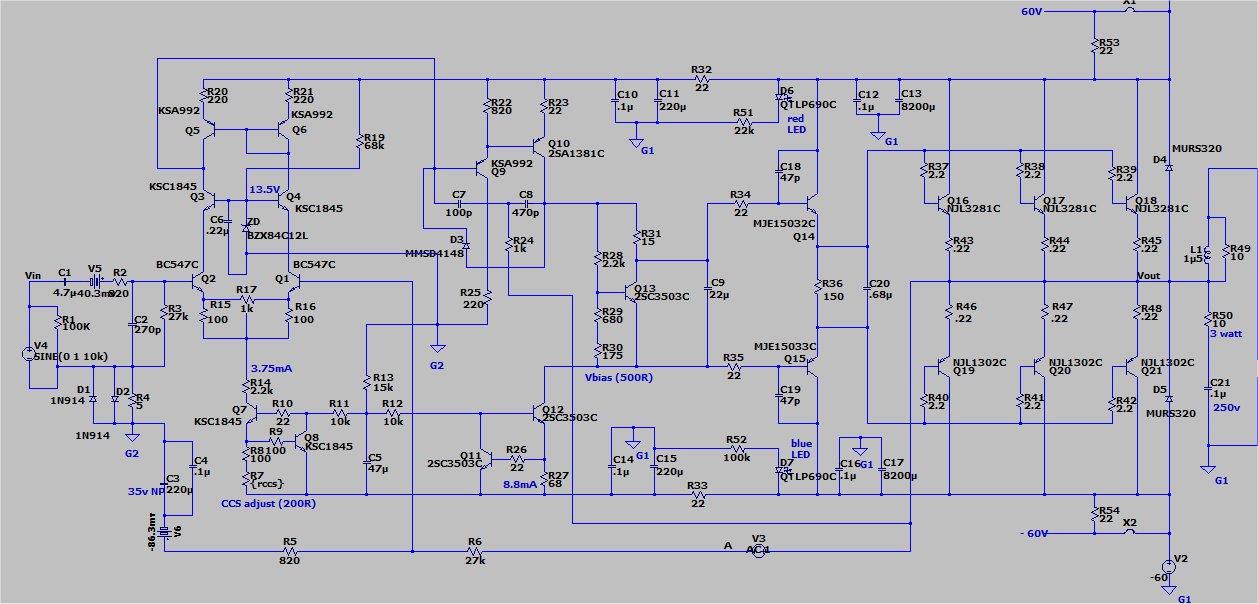

Here it is. Just the clamp diode and 1k = R24.
No big changes.

The Baker clamp is the standard accepted way to deal with saturation.
Below is the schema.Originally, I was just asking for comments on the layout-
(component options) Everyone does not have the same parts !

Just solder a diode (the ones discussed) between the output side of C8 (where
C8 meets R31 and R28) and the Base of Q9 (where C7 meets Q9's base).
Cathode (the stripe) goes to the Q9 base (make sure...).
Use a little shrink wrap on the diode legs , make a neat point to point solder job
All done ! 🙂
All done ! 🙂
Glad to see you like the sound - it is the best for such a simple circuit.
It will totally shame a LM3886 , even with E-waste junk parts (from the dumpster) .. 😛
OS
Hey OS, what would you say is the lowest rails that this amp can work into, and highest without component changes?
All done ! 🙂
