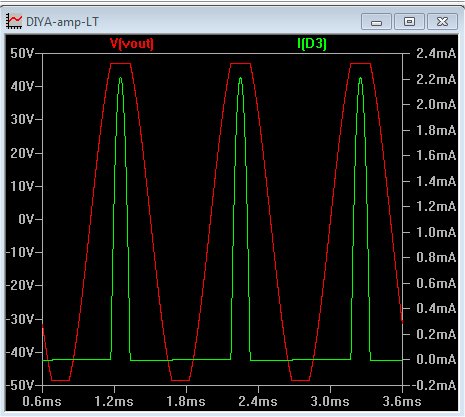

(Below-attachment 1) is a overdriven badger with a murs120 clamping diode.
Notice the (green) pulse of the diode clamping the Q10 transistor at clip. 2-3mA is all that's required (any small signal high-speed diode).

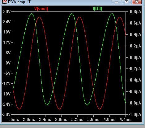

(below-attachment 2) is the badger under normal conditions. The green is the reverse leakage (500nA). This is worst case ... as some of the better SMD diodes have 1/10th the leakage.

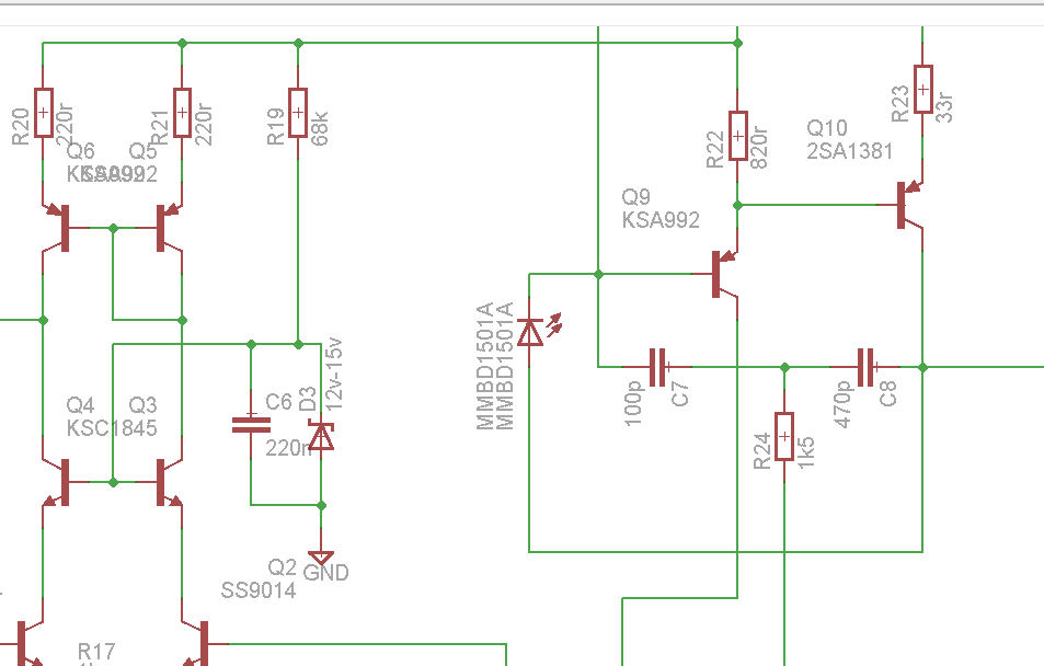

Take a look at my attachment, does it look somewhat correct? What value would you recommend for R19 at 80v?

Your "banging" could be you bottoming out the voice coils. 4 outputs at 80V !
😱 = 300+ w peaks (at least).
Your schema(s) are ideal , R19=68K at 70-80V would be 600uA through the
zener.
Your clamp diode and R24=1K5 are also ideal.
Could you share your model for that diode ?
Attach a text file or just paste it...
OS

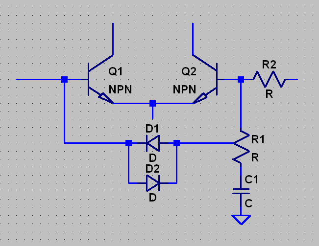

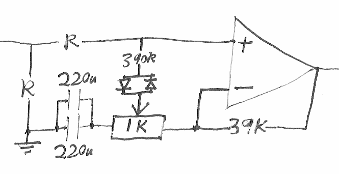

I think it would work to replace the feedback-shunt resistor (not the feedback resistor) with a similar value of multi-turn potentiometer, add antiparallel diode to the wiper, add add a series resistor (about 390R-ish) between the diodes and the IN+.
There's your standard LTP Clipper except that I've added a base stopper resistor (just a bit of padding between those diodes and the in+) so it won't make a strong change to your compensations/tone. You could add a cap series with the diodes for decreasing the brightness of switch-on tones.
Anyway, turn the dial till the speakers don't bang.
This approach might be useless with Honey Badger; however, I think that a dial like that (or with similar function) would be really valuable for Bass Badger (align the amplifier to match the woofer capacity).
It might help to put antiparallel BAT86 across the LTP bases. The diodes will turn on and prevent the LTP from saturating, which may improve recovery and sticking.
Dan's idea is a hybrid solution which combines this with a variable threshold and variable soft voltage limit. All these effects sort of run together, for better or worse depending on what diodes you choose, what input and feedback resistors, and your degeneration voltage. It's fun to figure all that out.

Here's the basic thing. Values aren't shown because it's not one-size-fits-all. I suggest using low-capacitance schottkeys. Some diodes actually have too low voltage drop and leakage is too large in this position, I think the 1N5817 is an example (but I think that has too much capacitance anyways).
