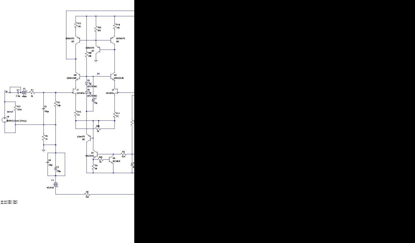

After corresponding with Variac on the present layout of the DIY case they will offer and the diyAudio heatsinks drilling pattern, I have ported the well known TMC LIN amp to a 75mm X 250mm PCB (below 1).
Some doubt the level of fidelity a circuit such as this can reproduce , but I aim to show them that simplicity can be good.
The design goals ( correct me if I'm wrong) are :
- 150W/8R - 250+W/4R , 3 pair easily obtained BJT output devices run in a Self EF2 configuration. (to-3p or to- 247)
- "All in one" construction - A pair of Apex Jr. 8200uf's , or just about any 10mm or 22mm 4 pin snap-in capacitor can be mounted on the main board. I looked up the panasonic line of 35mm caps and one could even grace this amp with 22,000uf X 2 @ 63V. 😎
- To avoid some of the layout "issues" in common with some DIYA amps. Grounding will be fully starred with voltage stage/input stage "lifted" and brought to the star at center point. I could also implement separate or "boosted" supply points which could be used if desired. Output feedback take off point and speaker tap are also "dead center". All semi's will be thermally coupled for almost "military" reliability.
- Compensation and other aspects of the basic design will be user defined (miller - tmc - 2 pole) , I have tried all 3 with success. The basic design is quite documented already in both D. Self and B. Cordell's books. My oldest DIY amp is similar and has been used for 2 1/2 years.
-Cost , this would be up to DIYA - There are no "exotic parts" , all are readily sourced. Even as this is so , the amp generally will have -110db noise , 1-2mv offset , and near PPM distortions with 80V/us slew.
Any comments or suggestions , the base circuit is (below 2). Any valid idea's on either the circuit or layout welcome. I am at the voltage stage / input stage layout now - I think the output stage will be free from any errata - I've used this "style" before 🙂 .
PS - the board will be double sided with the option of a single sided full DIY etch (no jumpers).

I would have thought that over current protection would be mandatory. The only issue I've got is that the transistors in the schematic (mainly small signal) aren't readily available to those in the UK. I have used them all myself though, but that required an order to digikey/mouser. Although if you can show me where to buy 1845/992s in small quantities without mad high shipping costs, that would be great.
Hi OS, the only things I would suggest adding are onboard DC and overcurrent protection, make things nice and simple and bombproof for newbies. You could always allow the option of linking out if not required.
That would be nice. I am constrained by the case/heatsink configuration. A protection circuit needs it's own supply / relay / driver. After reading about member Bonsai's experience , a standard relay driven by a standard ta7317 WILL NOT always work with a high current amp. PMA's HEXFET solid state solution will handle 100's of amperes and disconnect in a couple uS's. Perhaps we can design a "deluxe" unit . A breakaway board with softstart/timer and ta7317/SS relay. DIYA could "corner the market". I agree this is a shortfall in many DIY amps.. but some audiophiles don't like a relay at the output regardless (OPT-IN is always better). I could integrate but only at the expense of the huge supply caps.

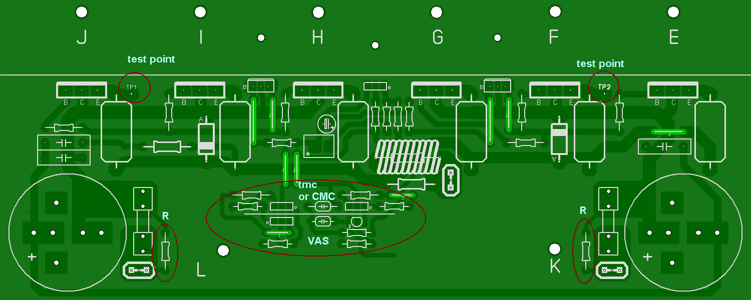

OK - you are a bonanza of idea's, Bigun 🙂
If you look below , you will see the "TP1" and "TP2" , if you can't probe those - stay away from DIY 😀
The fuse resistors are there , too. I was thinking , is it not the purpose of these resistors to keep the VAS/input stage "alive" in case of fuse failure ? If this is the case , would it not be better to have the "safety resistors" run directly from the unfused faston to the small signal section of the amp ?? On my modular creations , I use 22R fusible resistors on the boosted VAS/IPS board. These double as both the R/C filter and as a safety factor.
The grounds are denoted as "G1" and "G2". That is for my modular and "super" amps that use separate power supply PCB's. On this integrated supply board , G2 would be a separate trace that meets the center of the main star. From that trace , the 5-10R "lift" resistor + 2 diodes and the other input stage earth references are derived. I directly reference the DC cap and VAS ground to the earth BEFORE the lift resistor. If you reference them AFTER the resistor , you have modulation of your reference. Comments on this are welcome.
I really have thought about protection. On the typical OEM with just adequate capacitance and current limited trafo's , the classic 7317 IC/10A relay will protect (in most cases). Here we will have up to 20Kuf X 2 and most likely a hefty 400VA X 2 or 800VA+ toriod. Just ask Bonsai about his blown speakers and melted relay 🙁 .
To monitor TP1 and 2 with a SOTA DC/current detection IC and output this to a MUCH faster solid state relay would be better. If TP1 or 2 reached a preset voltage for X milliseconds (Rod elliots PIC detector or similar)Project 111 - PIC Based Speaker Protection
, it could fire the relay within a couple uS.
On board VI limiters will always affect sonics , as well. MUCH more defined and scalable VI limiting can be done with an external circuit as I described.

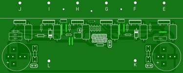

Variac discussed 2 PCB's originally , The amp itself just needs one , PS and all. A comprehensive VI/DC/soft start would be a good solution to all the above factors. It could also be ported to any amp.
Sound buster , the safety resistors can be used to measure OP current + the
current demands of the input circuitry. To measure the output Re's directly is more accurate and you can see if any OP devices are failing to "share" (gross Hfe mismatches). Most ON semi output devices from the same order will typically read within a mV across one of the .22R resistors. For example , these amps are typically set at 10-12mV.

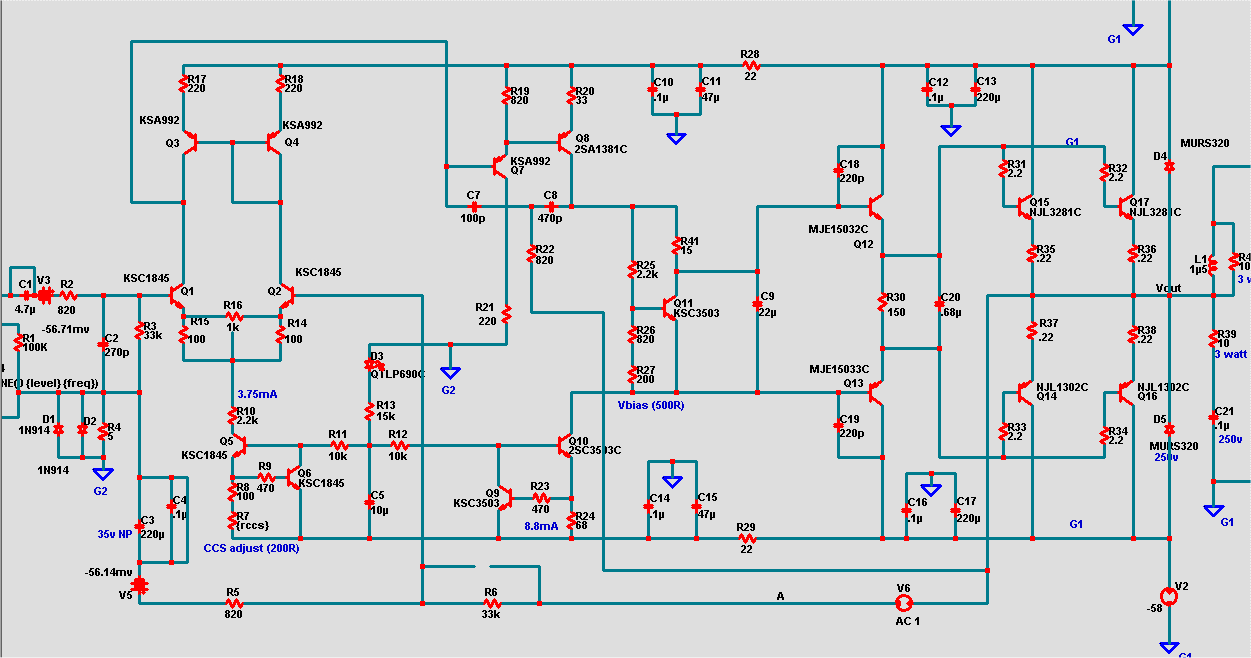

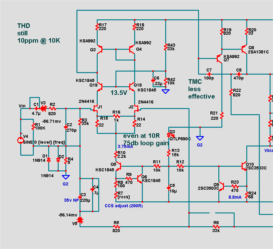

A few thoughts to ponder .... I have built this particular amp with cascoded input stages , one pair with (cascoded)SS9014 low noise BJT's and one pair with
cascoded 2n4416 Jfets. The BJT's were quieter (only measurable with a CRO) , the Jfet's subjectively sounded better (I am aware of the psychology).In Either version, the differences were minimal.
Benefit's of the cascode are the wider choice of input devices , less thermal drift as the input pair Vce is lower =cooler. Of course you need a minimum of 2 resistors or resistor/zener to bias the cascode , increasing the BOM. The Jfet's will have an effect on the loop gain of the amp , reducing the effectiveness of TMC. With this amp you can choose standard miller compensation , so a FET input pair amp is still possible. The "tradeoff" is more distortion vs. A "slightly different" sound. I have no AP , but in simulation , a slight shift in harmonic content can be seen with the Jfets.
I would appreciate opinions as to whether I should include the cascode.
The layout features would be :
1. Jfet or BJT - I know both work and have the values already worked out.
2. Total "opt out" - jumper the cascode , use the 2 high Vce input pair (992/1845).
3. Cascode voltage reference can be just a simple resistive divider or zener referenced (or omitted).
I would like feedback as to whether this would be a good addition or would it overly complicate the design. It would be good if this design could satisfy both the "new" builder and someone with higher expectations (picky people 😀).

Below 1 / JFET - TMC is really not effective (68pF could be used w/ standard miller comp.). Distortion is still 10-12 PPM @ 10K , H2 is more dominant. Whether this can be heard might depend on the "golden ear factor" 😀

I like the idea of some options, if it were clearly spelled out how to implement them or not. I found notes on the board itself to be the least threatening. Like a note saying something like:
For no cascode eliminate all asterisked components & jumper "A" to "B"
Of course room is needed to write this, but it came be done more succinctly than my example..
Hoever I'm no expert on this type of amp, so you guys should decide this..
If OS could write up a short article after the board is designed in which all the options are explained clearly, it would always be available to builders.. Or diyAudio could publish it..
I think the cascode is a good idea, it gives people more room to play around if they want, especially if the BJT and Jfets share the same pin outs too. This also gives greater flexibility on the input pair choices, easing the selection of a high beta pair as now the Vce restraints have been lifted.
I'd say that any economical advantage when removing the cascode + biasing would be largely irrelevant as the additional cost would be peanuts when compared to the rest of the expensive items. As Variac says, having the option to 'jumper this', if you want X to happen etc is a nice idea, it does add complexity to the overall PCB design and increases the BOM again, but if anything DIYers prefer to have options.
I think having an amplifier where you can try out the various compensation methods + different styles of input stage would be quite interesting and would probably pique quite a few peoples interests.
I also think that having three output pairs is a good choice too as it allows the amplifier to deliver a decent amount of current when set at the 150 watt @ 8 ohm target.
Another thing perhaps is that the cascode would give more flexibility on the power rails. With three output pairs, if you had a benign load to drive, you could easily up the rail voltages to give more into 8 ohms. Of course if you've got a high bias input stage this could push the input transistors beyond their comfortable limits, some small signal stuff will only tolerate 300mW and that's at 25 degrees C. 50 volt rails and a tail current of say 2mA would push them to their limits. If someone wanted to up the rails to 60 volts they'd be in danger territory.

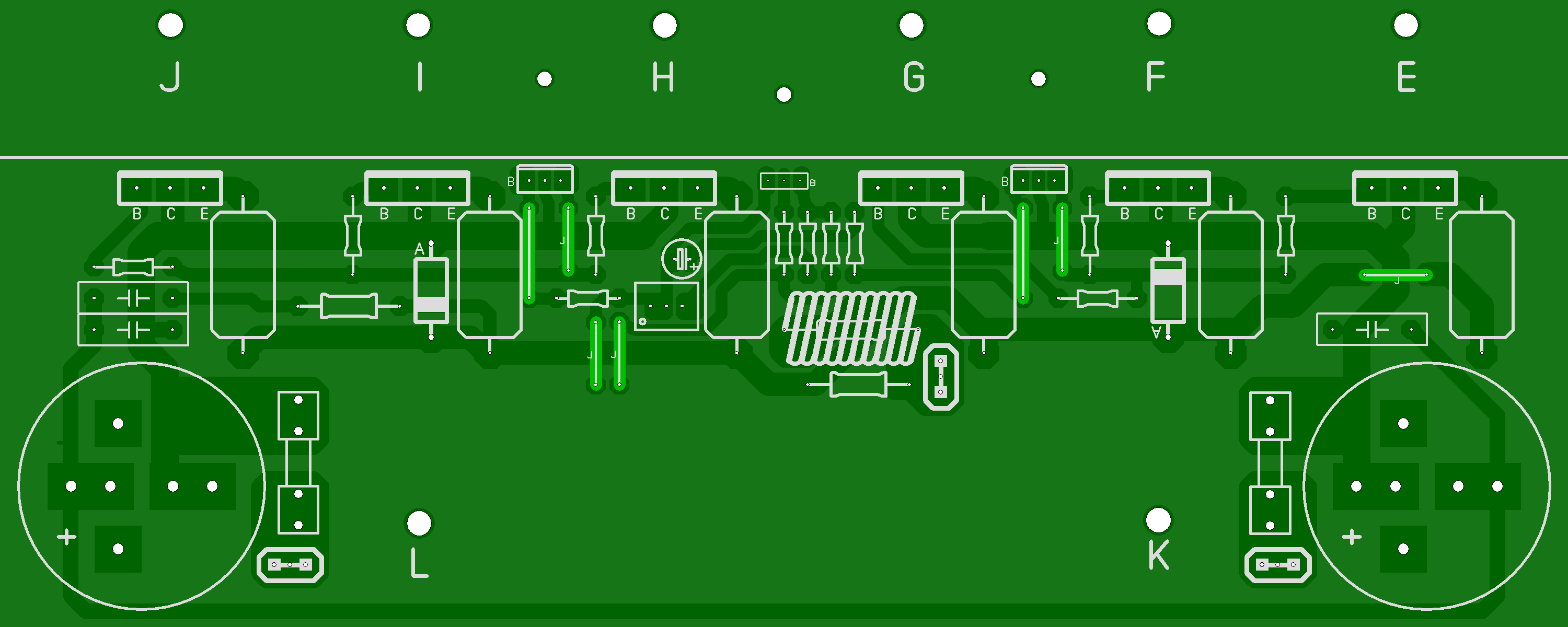

I like the cascode idea.
It adds a tiny bit of board area.
It can be omitted using zero cost jumpers.
The jFETs in the LTP can be replaced with BJTs if desired.
I love the test points idea. I'd make them mandatory.
Fused rails with 100r bypasses permanently in place.
Once the circuit is proved the empty fuseholders get 10r or 1r resistors soldered inside old fuses. This allows quiescent current measurement with very little voltage loss. Output bias current and driver bias current are measured across the test points fitted to the emitter resistors.
Finally the intended fuses replace the 1r0 resistors.
I hate the EF2. Why not EF3. Again easy to link out the pre-driver stage, if desired.
All capacitors must have at least dual pin pitch options.
All drivers and output to have provision for base stoppers.
Power input via a twisted triplet to three, very closely spaced, power terminals.
All or most signal transistors to have 4 pin pads to allow the different pin outs. bc, 2n, 2sc etc.
